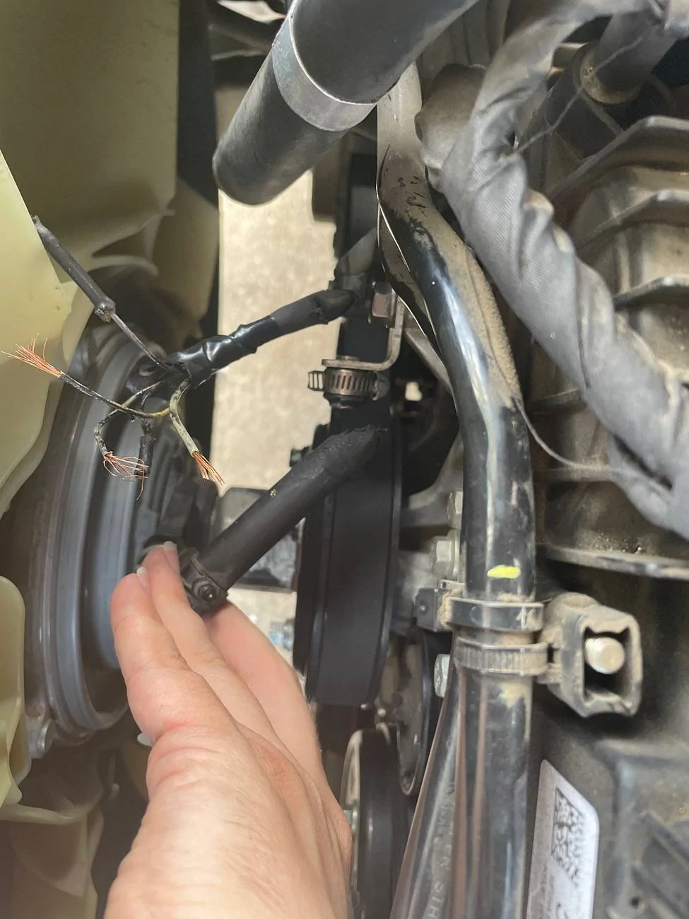

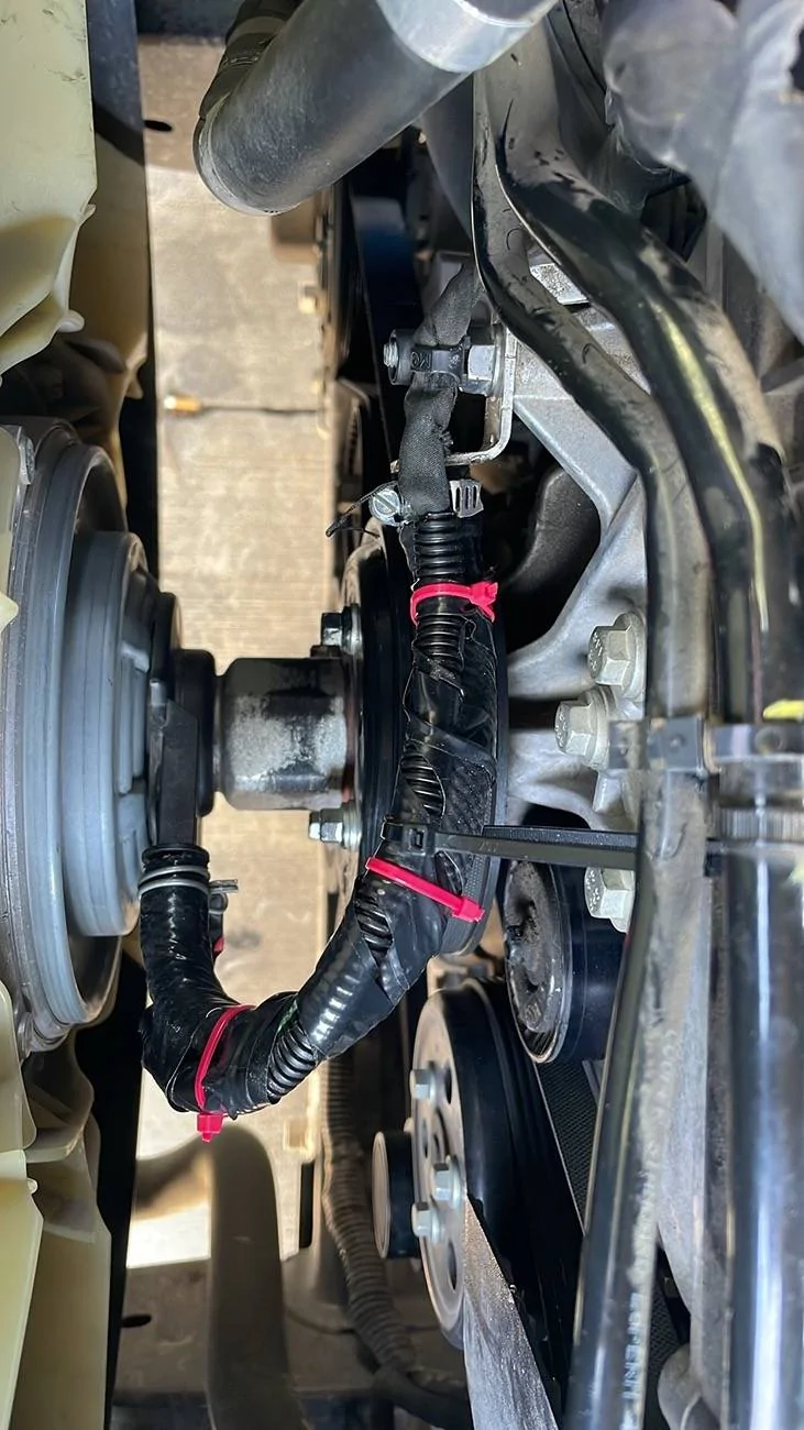

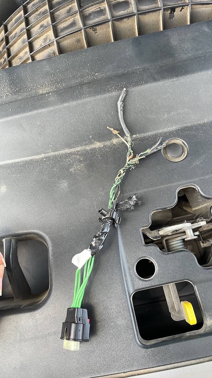

This thread is the reason I made an account here. Thanks for the suggestions and various guidance to getting this resolved y'all.
I had the wiring repaired at a shop only for the rubber hose to fail (again) not even 6 weeks later. My dad and I found this thread and took the suggestions to swap out the rubber hose and even went over the top and wrapped the wiring then zip tied it to the new hose.
