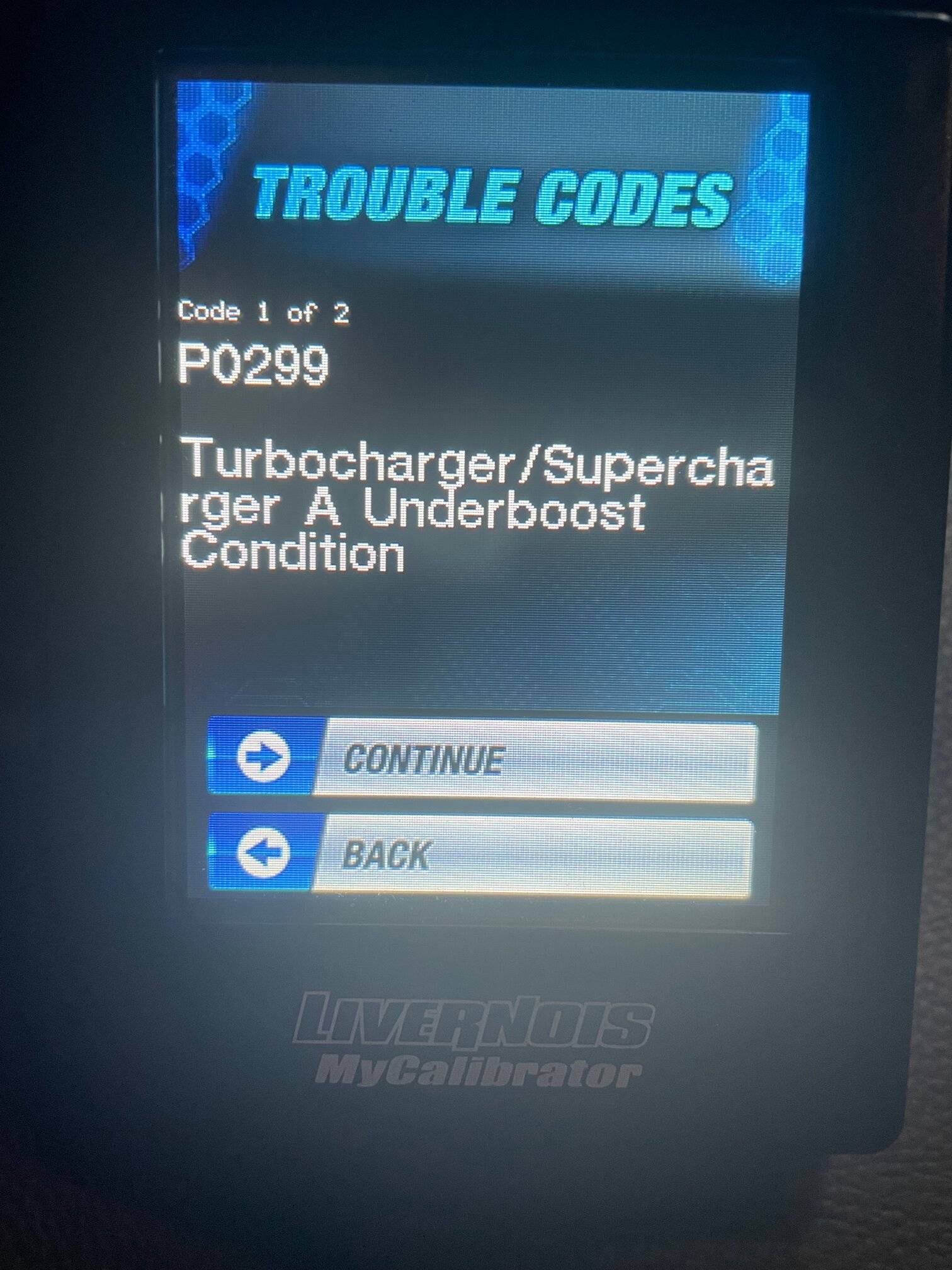

@AzScorpion While using the CC on those hills, did you manually lock out upper gears? I've used CC in the mountains of NC without issue, but I always lock out the upper gears, so that in the steep areas I'm maintaining 2.5-3.5k, even on the way down, sometimes on the way down really steep ones I'll lockout move gears and end up engine braking at 5k.
26,248
132,185
John, no I didn't have any gears locked out. I've made this same trip dozens of times but this is the first time using CC. I was tired (had insomnia the night before) and decided to try it out again. Now that you said that about maintaining higher rpm that way I do remember it didn't seem to drop down in gears while going up hill. I'm sure it dropped a gear (or two) but not enough to hear the engine race higher so I'm hoping the lugging caused this. Thx!

If I have CC set and start climbing a hill I drop it to sport mode.
I always use sport when we're up in the hills in Sedona or Jerome. I usually manual shift too because when defending I can control the braking better that way. The last time I used CC was over 2 years ago coming back from Vegas but it was a flat boring drive all the way back so no issue with hills.

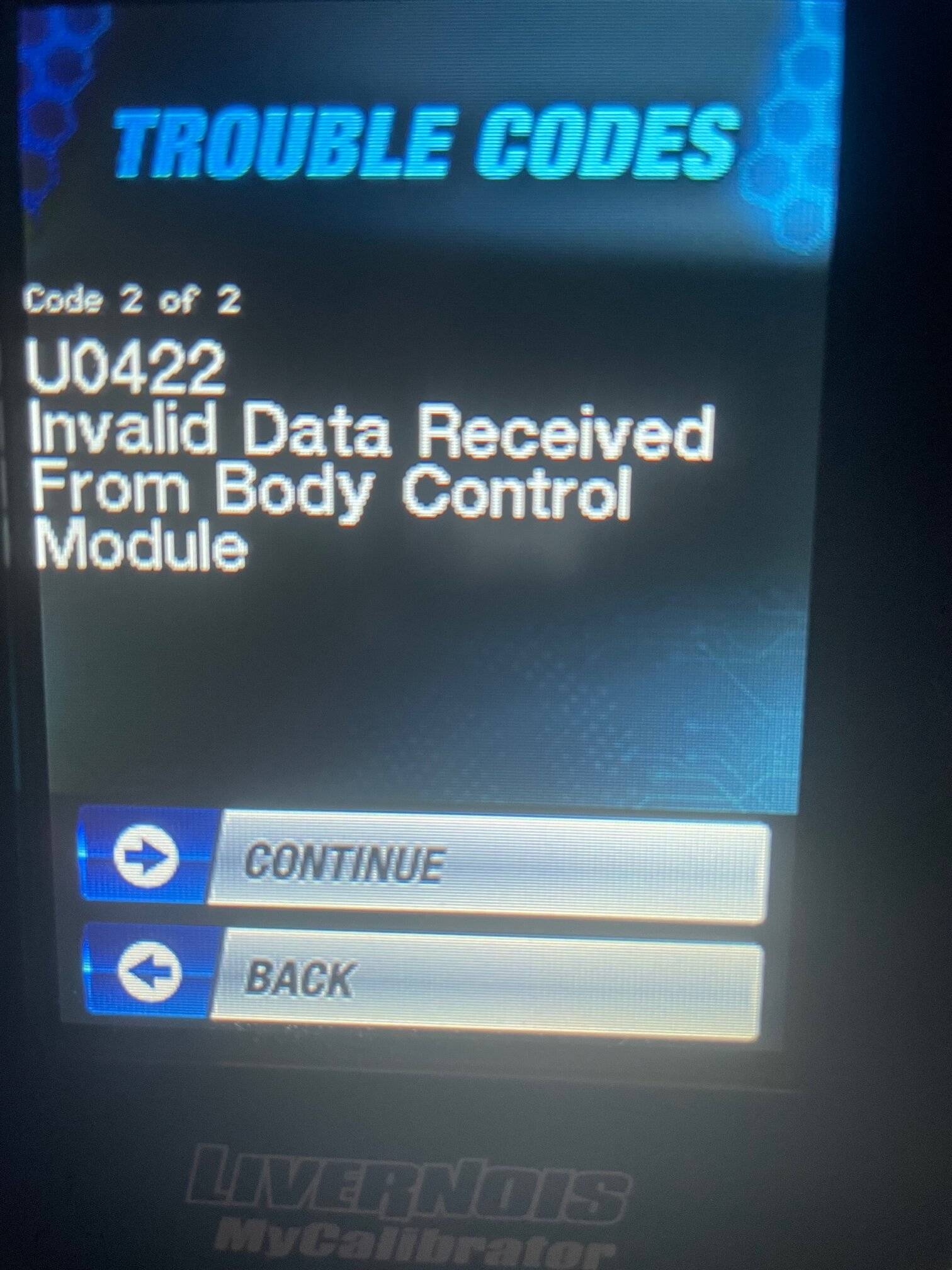

I just connected it and mine can read the codes. Looks like similar ones a few others were having and then it cleared up. Hopefully it's just the throttle valve sticking but strange that I never lost hp (no limp mode) and it didn't do it on the way back.
My guess is that the U0422 is because the BCM detects an unauthorized part on the tailgate. :crazy:
It's nice to hear that the Ford app alerts you, but it would be a whole lot better if it gave actual codes and possible problems/solutions like most code readers do.

You're probably right about the steep hill. I was trying to read through some older threads where this happened to others and one (I can't remember who right now) said his went off while the CC was set going up a very steep hill too.
