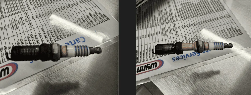

Also - here is pics of the culprit for my woes and plate of crow :p
Glad it all worked out. Yes the cover is foam. It also is way less effective than everyone wants to believe. Just look at it and you’ll understand. I have had mine on and off over the years and I don’t have any water problems either way. My 2016 Explorer has a 2.3 transversely mounted and has a huge molded plastic cover and it has the water problem….. I honestly think it’s a lifestyle thing, it seems like it has to do with how it’s driven, the duration of the drive and frequency of driving. My truck is daily driven and thoroughly heat cycled whereas my Explorer is more a random short trip vehicle.

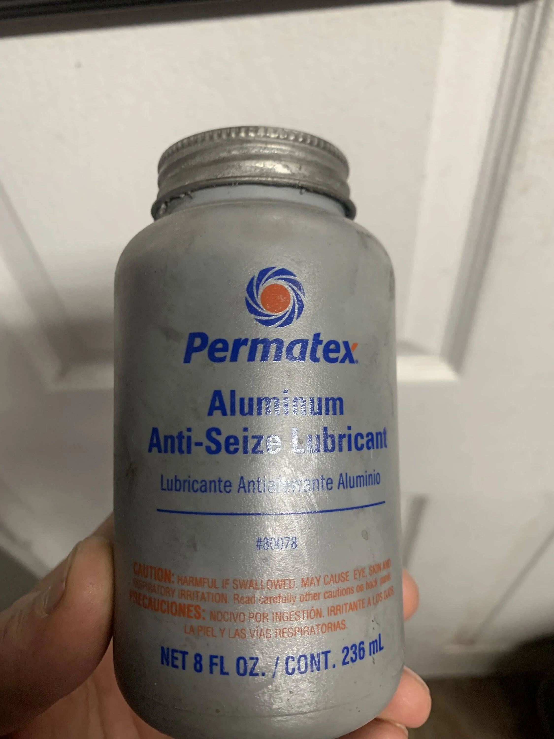

I'm sure if I read the 15k plus replies on the multiple threads on the spark plug issues, It'd tell me. What is the correct method for getting spark plugs out without breaking? I'm at 43k now, and would prefer to avoid issues later given that ESP may or may not cover damage. Is there a preferred brand of anti seize, or are they all the same?
I believe they’re all the same or similar and will do the job. I recently changed my plugs at 62k miles had a cover the whole time no plugs broke off. Thank god!! I used this just to be safe and have used it for years on previous vehicles.
As a side note be careful with anti seize if you get it on any plastic trim it’s almost impossible to remove.
