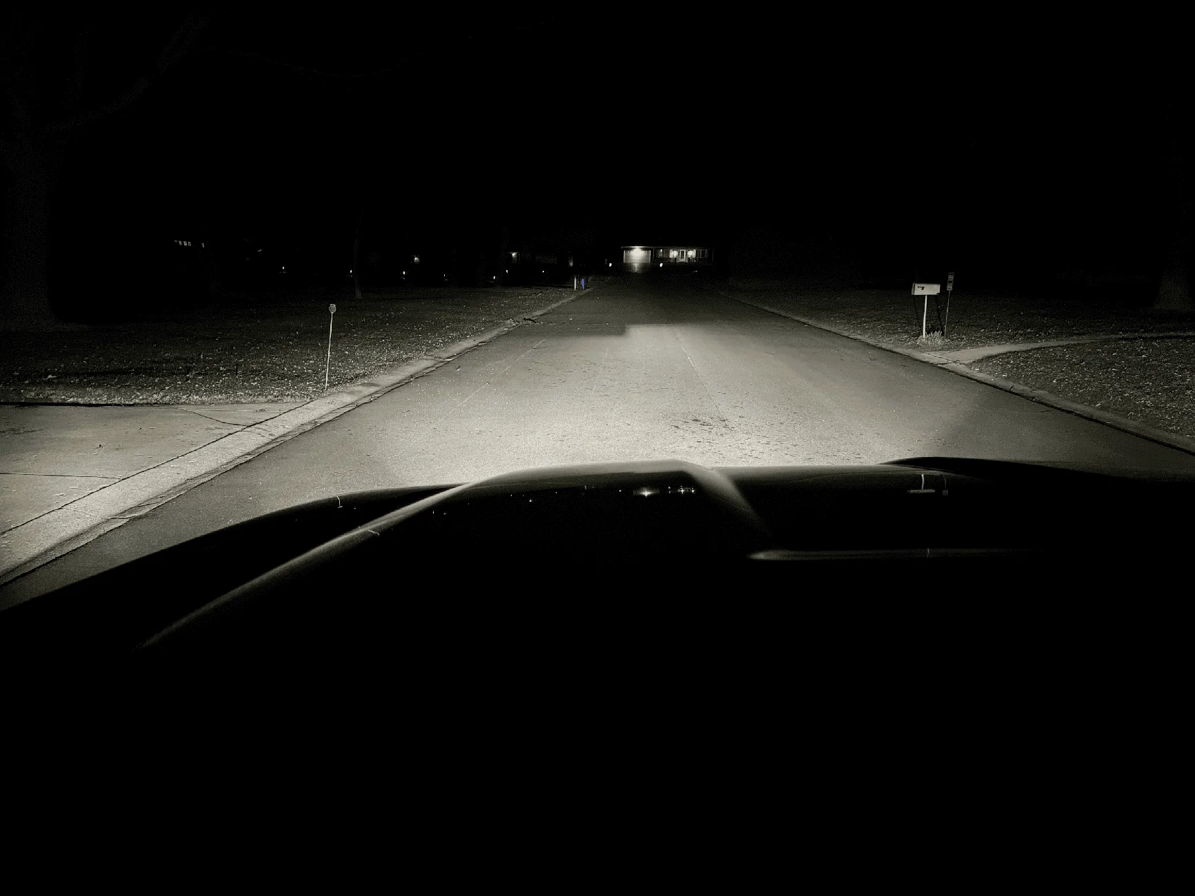

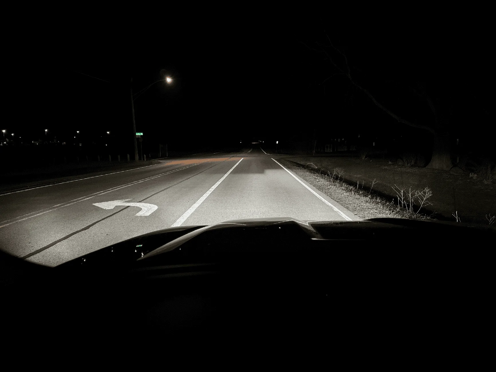

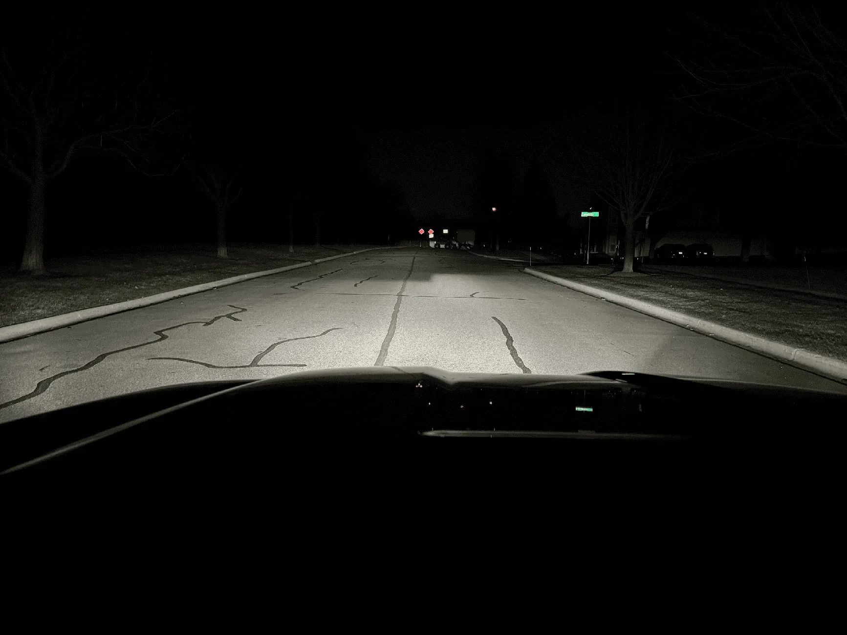

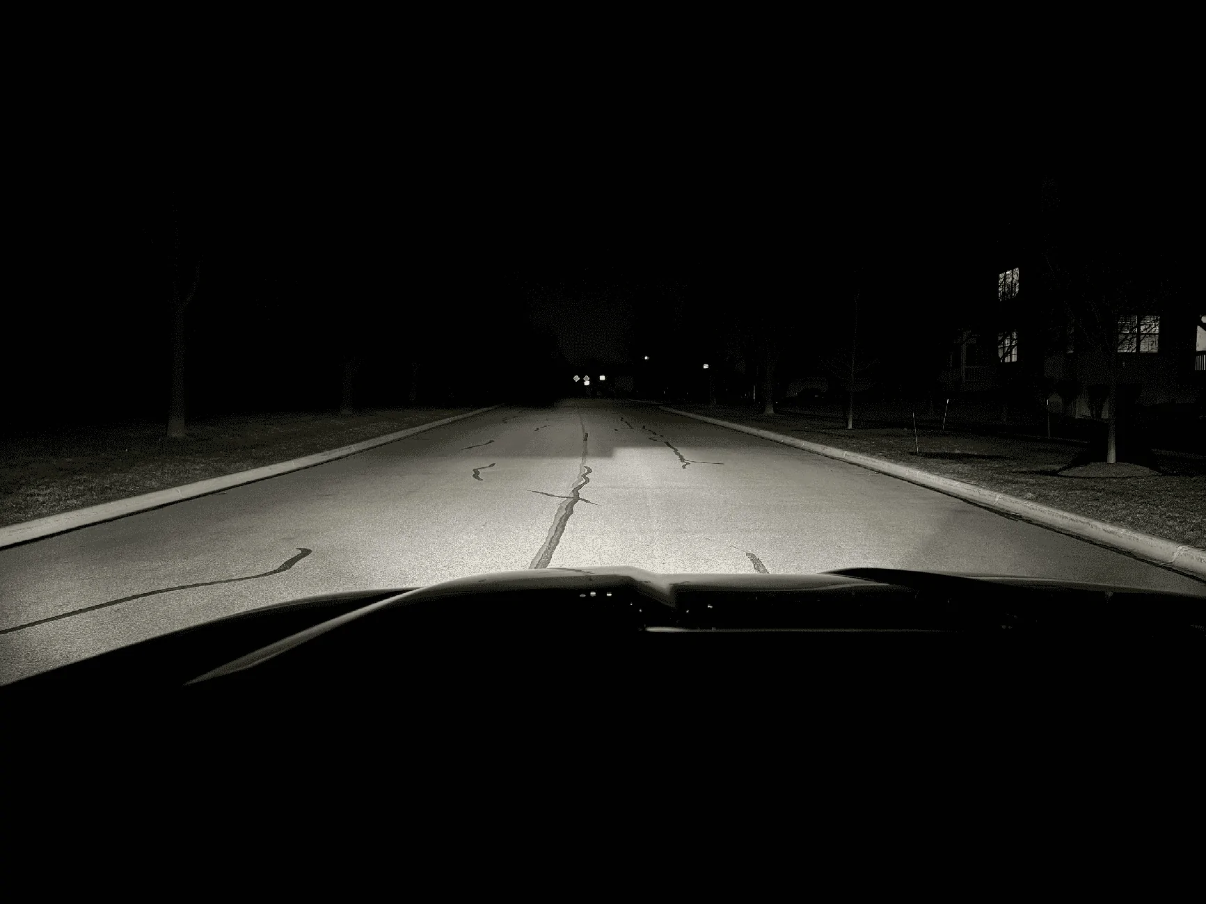

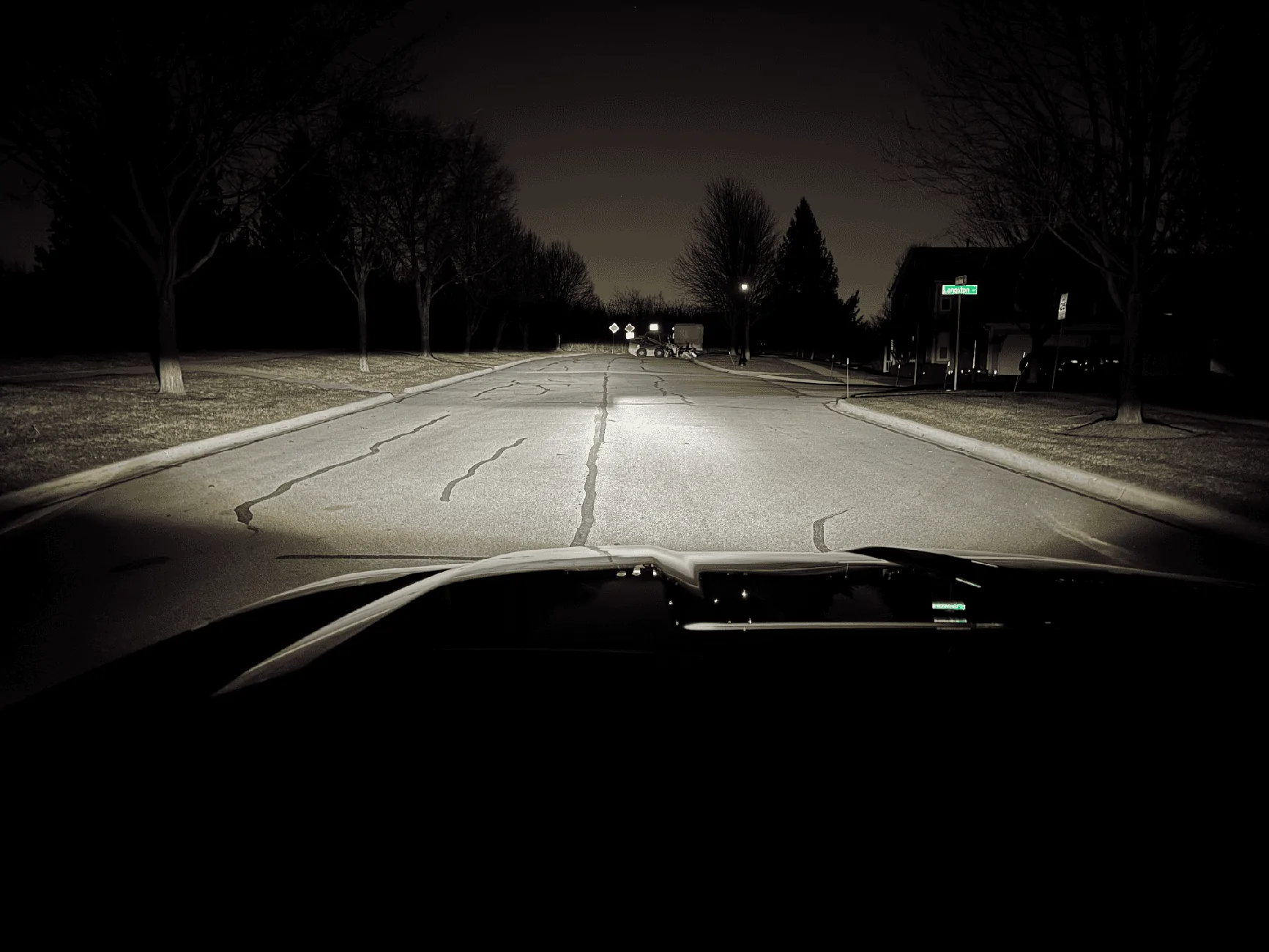

Morimoto's daytime running lights (LED strip) are powered by the fused power lead that you run to your fuse box (I ran mine into the vehicle). You can turn off your OEM daytime running lights in your dash menu... You don't NEED Forscan.
There is a step down on the drivers side from both lights, like nearly every projector LED and HID out there. It is to help with oncoming traffic. That said, Morimoto's step is too far to the left and still blinds traffic, especially the driver's side, as noted in the below image.
My S2000's factory HIDs have the step further to the right so that oncoming traffic is not blinded.
Your lighting looks as I would think mine should, I am going to take a pic tonight and post it, but mine is more like a block of black about 10-15 feet ahead of the truck and when a car is in front of me it appears like it's a shadow of the teh car in front of me, like there's a light shining on the right side of the car in front and it's casting a shadow on the left...

I am not sure these photo's do the dark spots justice but here they are, I think it's worse than what the pictures show.

Aim your lights. One is much higher than the other.
Big Blue
Lee
May 5, 2020
3,942
9,418
Retired mechanical designer
I agree, after looking closely at the pictures, it appears your left (drivers) light is way too high and your right may be too low. You really need to find a level area with a wall you can project your lights on from 20-25 feet away. You should have a clean cut-off line at about the hight of your headlights. There should be little to no light scatter above this line. There will be a small step up to the right side. This is normal as they are to project farther down your lane than the oncoming one. Be sure to have you fog/driving lights off when you do this. As they can confuse the issue.
