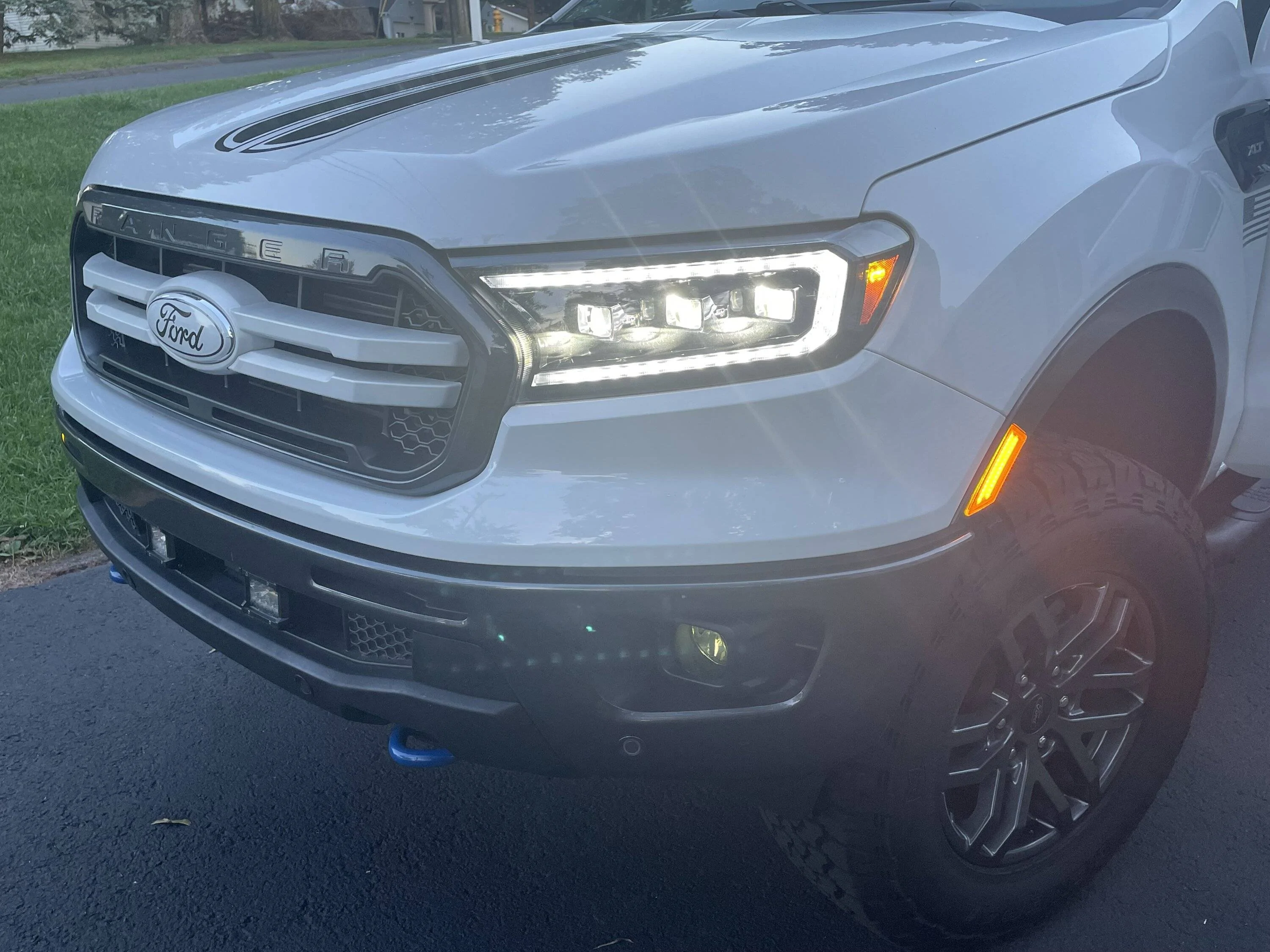

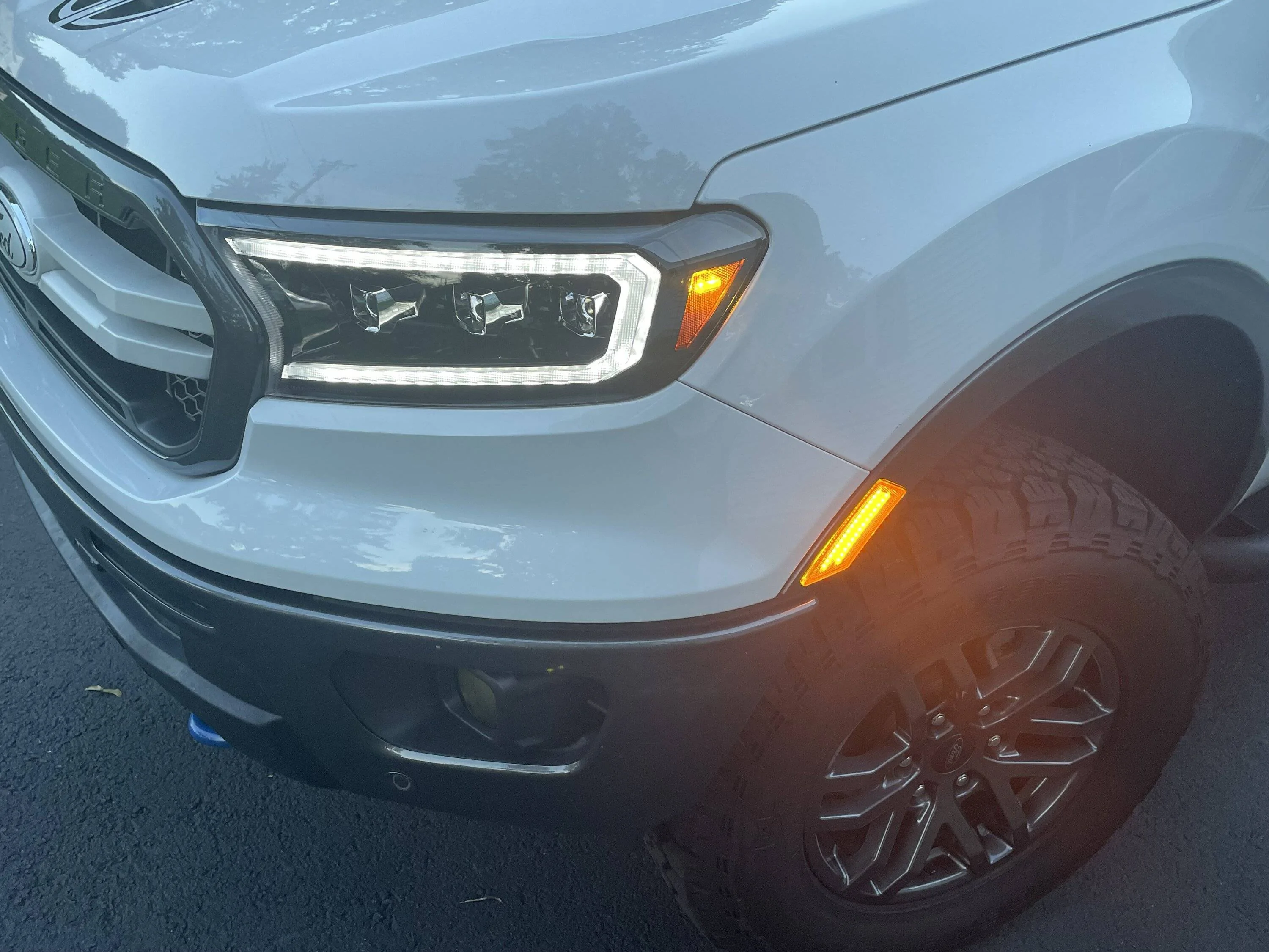

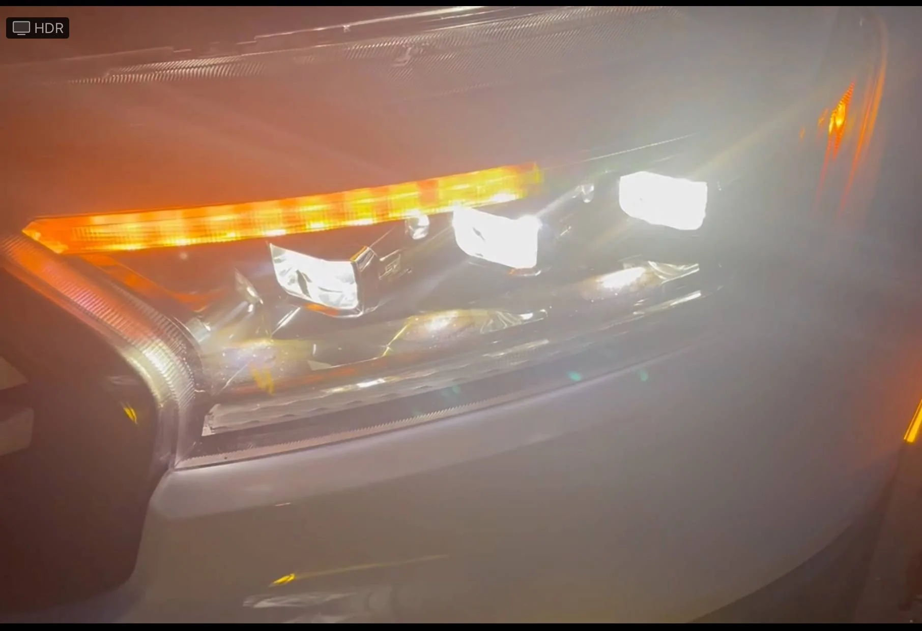

I have a pair of XB's on my 2021 Sport. We installed these and got them working with the fuse tap and unchecking the "DRL" box in the dash settings. The issue I'm having is the start up sequence only works on the drivers when in "Auto" When turning the key with the light switch off, I get normal startup sequence. These lights are working correctly in all other modes and even auto works correctly except for stertup. Another thing I noticed is that on occasion, there is no startup sequence at all.
So my question is, is there a setting in forscan that may be causing a conflict? My buddy had an idea that there might be a "Halogen/LED" switch inside forscan. And does anyone have the settings that need to be checked in forscan since early in the thread, the OP is asked if he got the correct forscan setting. It's just that I didn't see if anyone has posted the correct FS settings. Thanks.

As the friend, I think @airline tech confirmed in post #19 my hunch. Or at least we should try it :

Mine do the same and I think it has to do with the fact that one light comes on a touch before the other. I've talked to someone on here that replaced their Lariat with these lights and he does not have that delay. I've been meaning to mess with FORSCAN some more, but have not gotten around to it.
I wish they had made these for the Lariat so we could PnP and just adjust FORSCAN. I didn't even use the fuse box under the hood as it breaks the nice seal to keep crap out, so I ran it into the cabin and used the fuse box under the dash.

Thanks...I appreciate your comment since now I know others have the same issue. I contacted "Headlight Revolution" about it and they seem aware of the problem, but haven't researched the proper Forscan settings as of yet. They were ready to send me a replacement but I think the problem would not go away....and after more explaining from me, they agreed. (The startup seq works on both lights in manual mode). When I asked them about contacting Morimoto directly, they said that they are Morimoto tech support as Morimoto is their parent company. We will fool around with Forscan to see if we can clear this faulty startup and repost if we found a solution.
