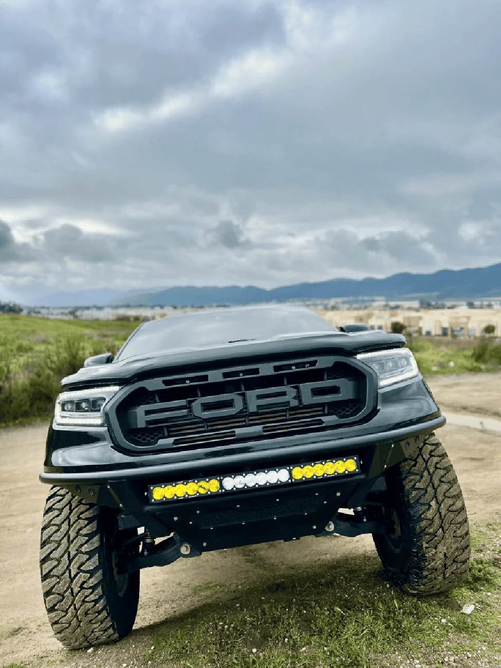

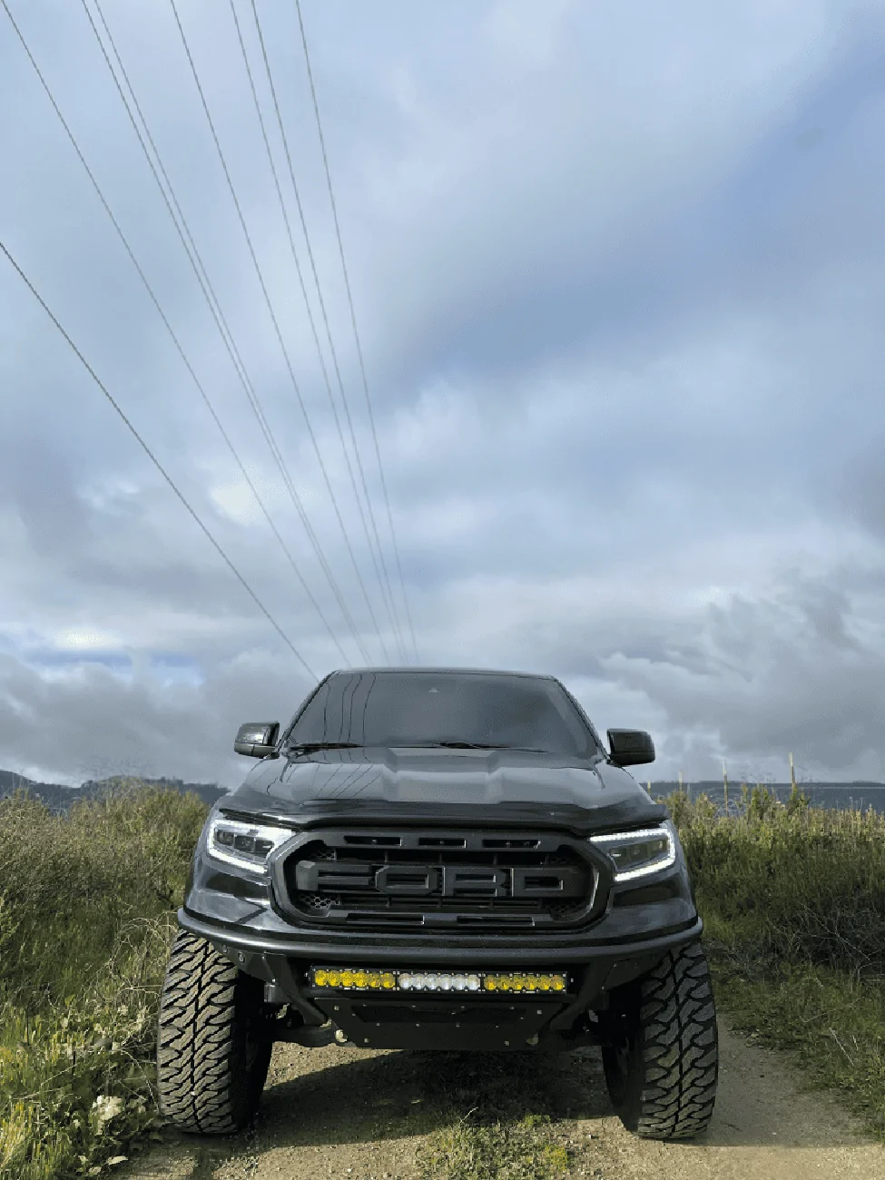

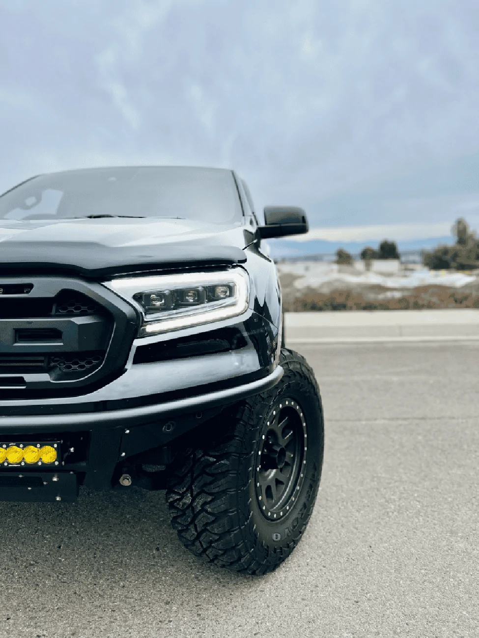

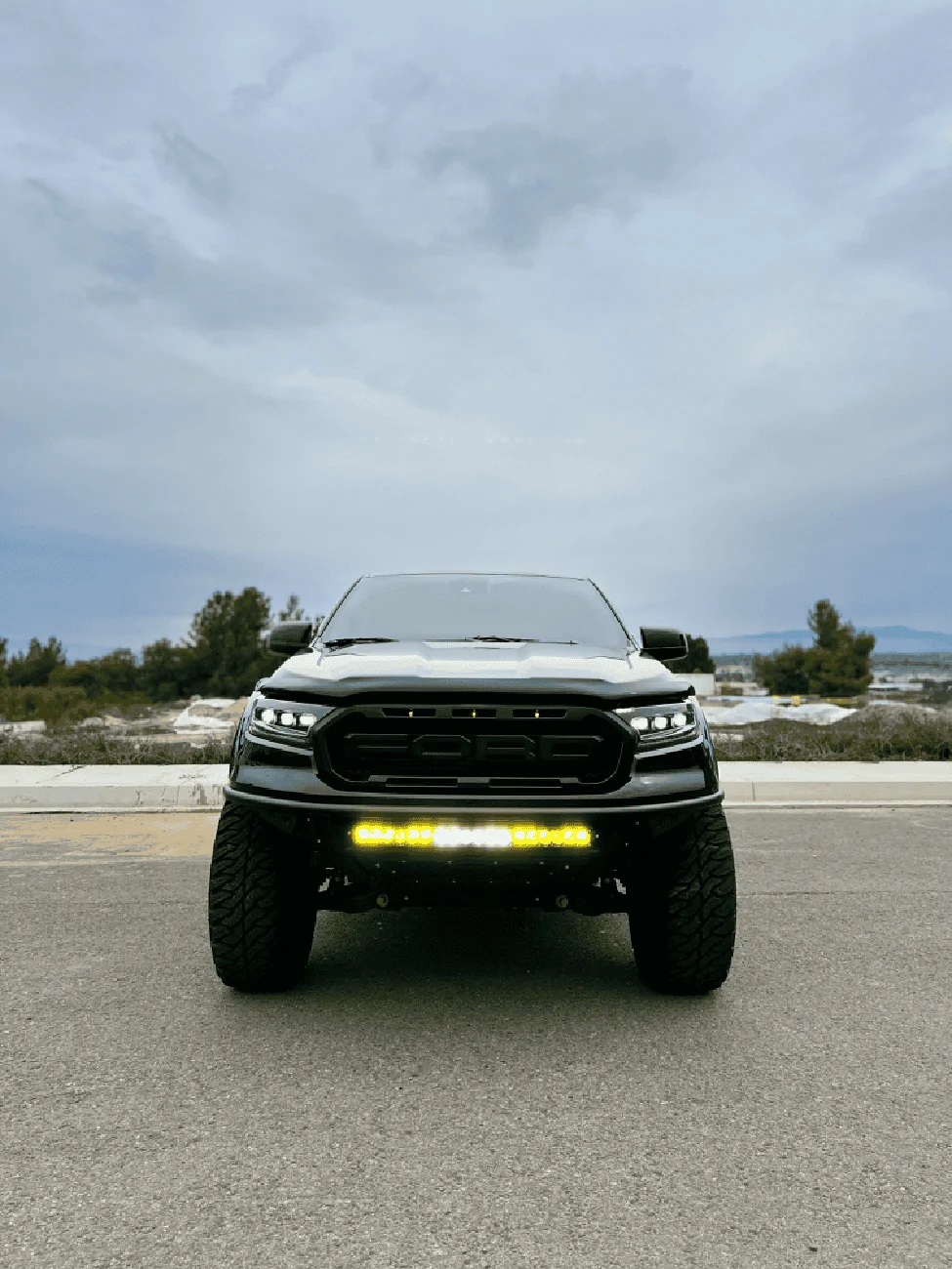

FWIW, I initially wanted the Morimoto XB’s but the price was a bit too steep. I took a chance on these VLAND Matrix Triple LED’s (Morimoto XB style look-a-likes) for $400./pr. Installed them myself and they were true plug and play. Perfect OEM fit with no gaps or trimming required. No hyperflash. These lights replaced the Halos on my XLT. No mods required through Forscan what so ever. Pretty Happy with them.
DRL’s Only
Main LED Headlights with the DrL trim.
Night Low Beams
Nighttime High Beams
Turn Signals turn amber and can be set to either sequential or straight flash.
