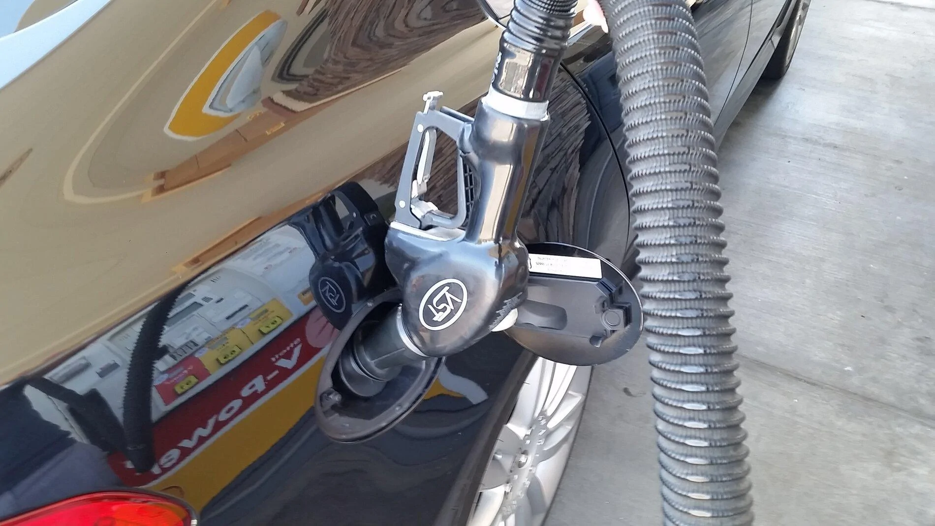

Rotate the nozzle 180° so the hose points up.
Like this:
Is it dumb? Yes. Does it work? Also yes.
