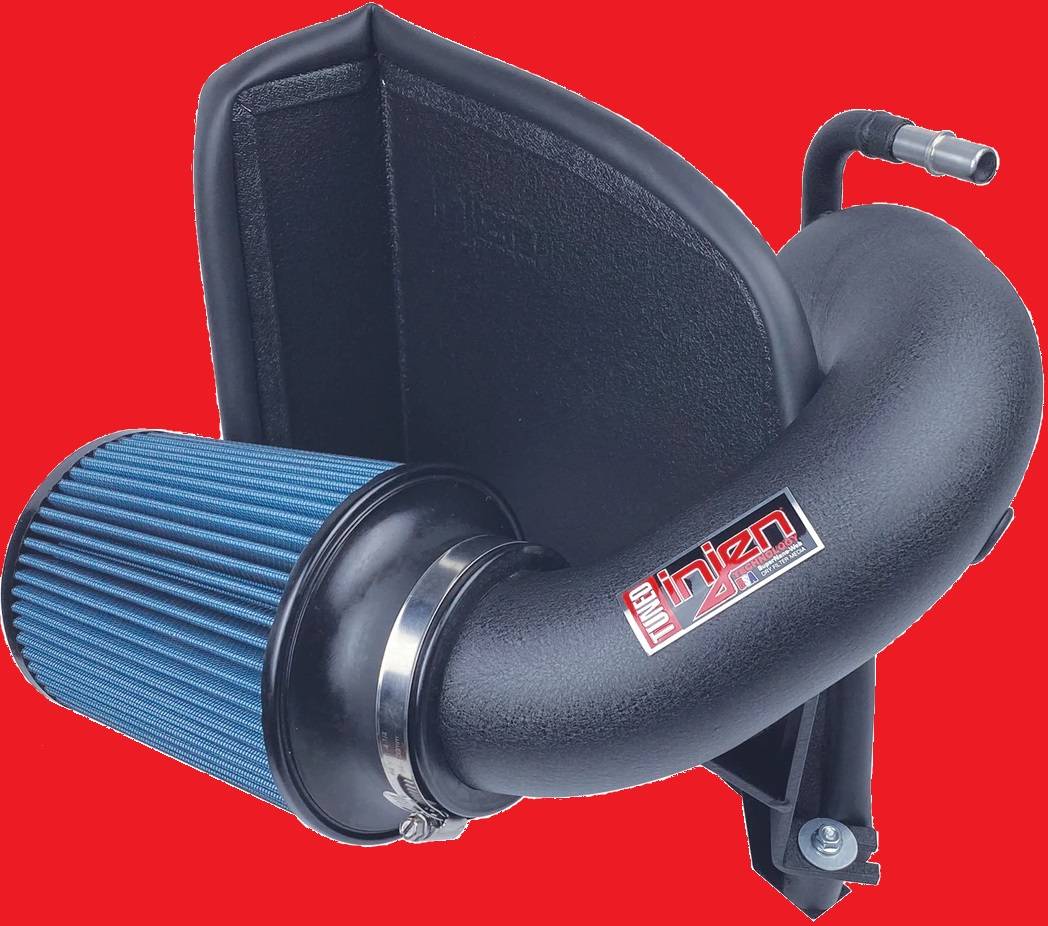

Will it increase fuel efficiency? I have a 84 mile round trip commute so I put about 19k miles on mine per year just driving to work. Currently averaging about 26 mph since I'm doing 60 mph almost the entire drive.
I am quite happy with my Injen PF9071WB - Cold Air Intake (https://injen.com/i-30498853-injen-pf-cold-air-intake-system-wrinkle-black-pf9071wb.html). Might improve gas mileage as it very much frees up intake air flow. Compared to stock, no tiny slit for taking in air, fat pipe and smooth bends. I put it on for added power. It helped in this manner and I enjoy the improved sound of the turbine and pop off valve. Their site says " On our dyno, the PF9071 put down an impressive 14 additional horsepower and 13 pound-feet of tire-scorching torque! "
I think their dyno needs calibration, 14HP? Either it's a lie or a typo that should read 4HP.
