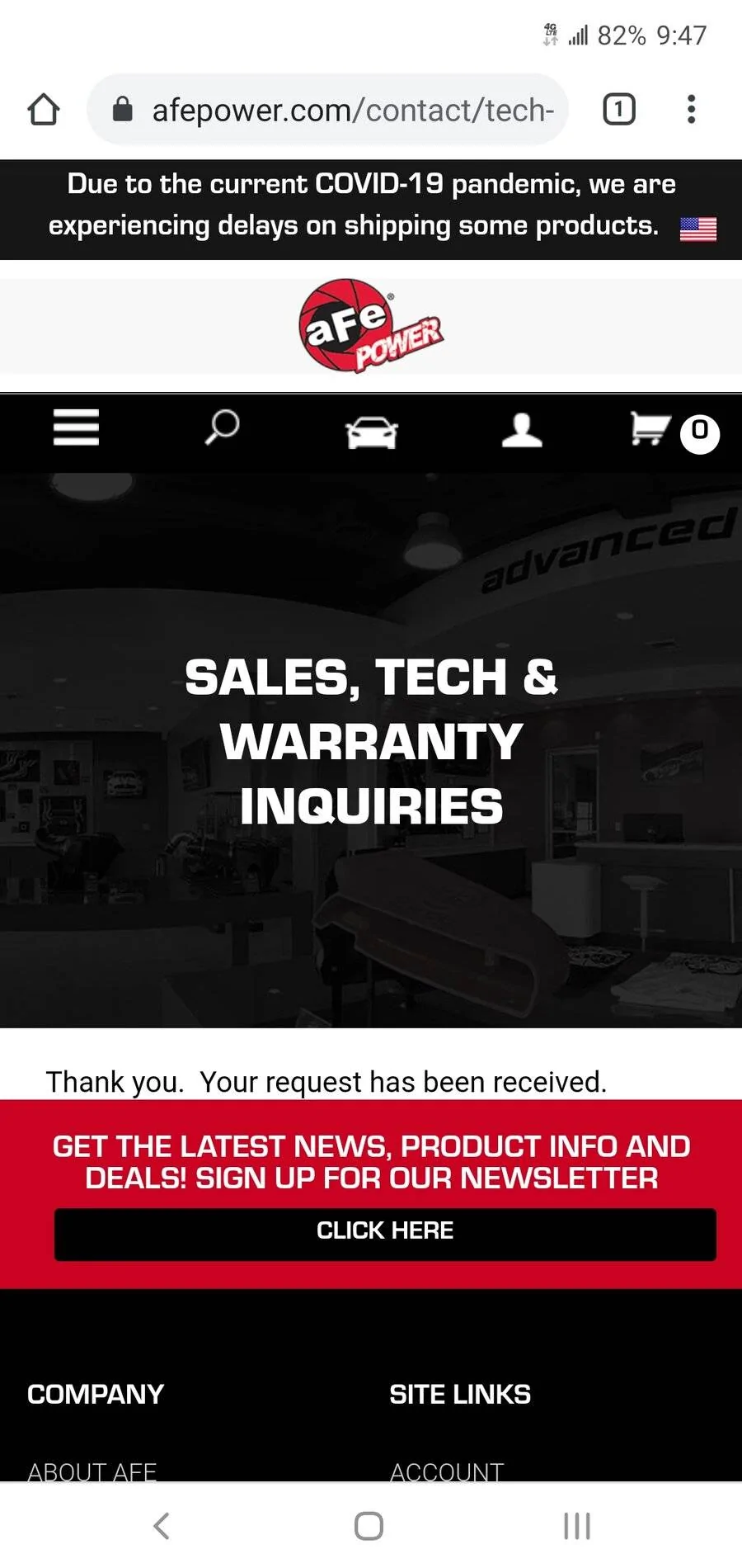

Just submitted a request for a video to hear what the intake sounds like. Love induction noises, not so much a blow off valve though. So thats staying stock.
