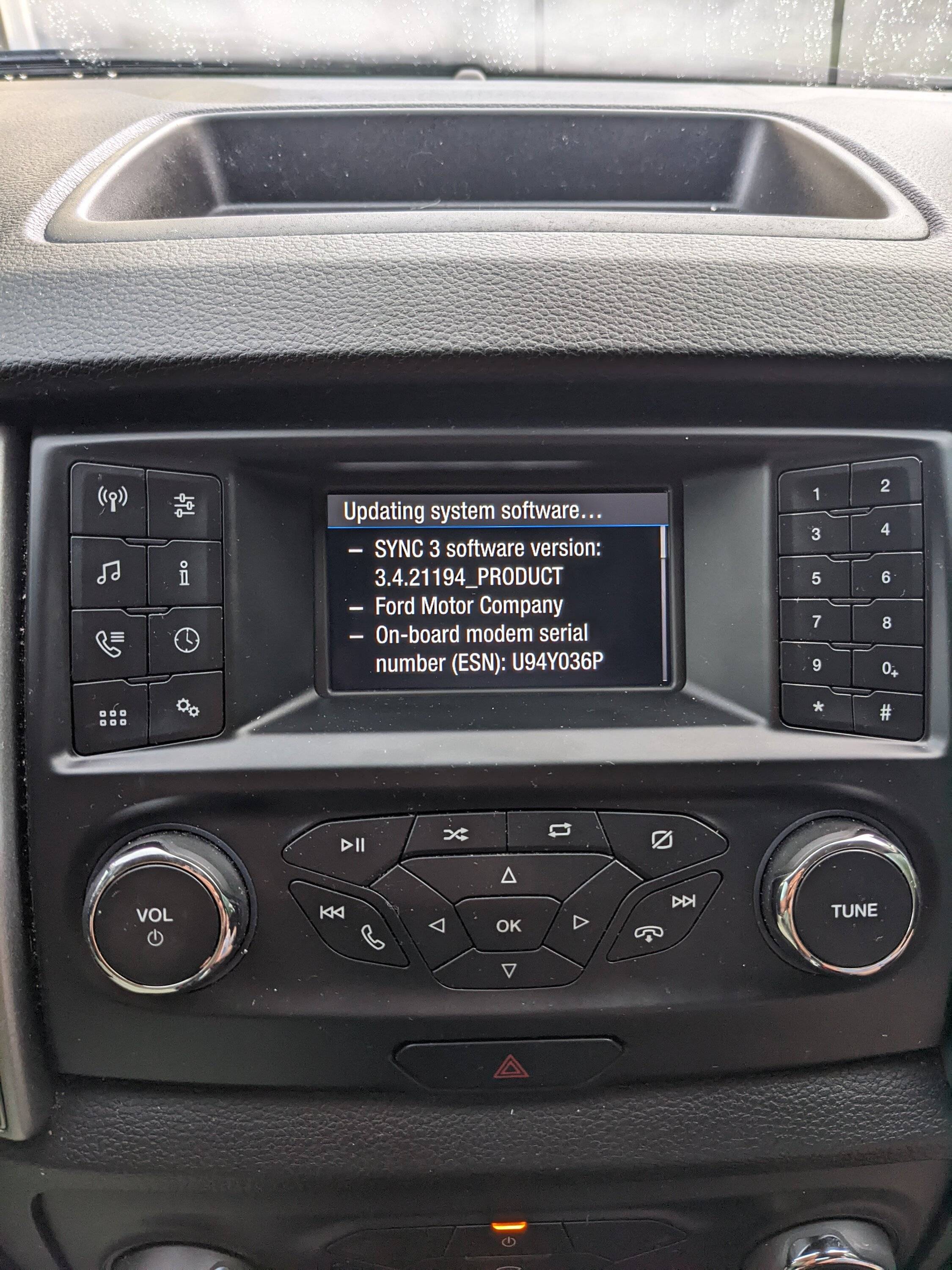

About how long does the USB, update take? I'm 3 minutes shy of an hour. Truck still says updating software.
Versions shows updated

Success had to restart the truck to get the message system update complete.

I had the original sync that was factory installed last update was 4/2019.
I could not get updates over WiFi ( time outs). USB (thumb drive 4 Gig) worked it just would not say system update complete. After 1hr 15 min I just said screw it and turned the Ingition off.
I did not sit in the truck and wait, just checked in on the update process every 10 to 15 mins.
