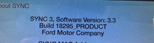

I am planning on updating my Ranger’s navigation system, but before I do that I would like to be sure that I have the latest version.
Below is a photo of my Sync info screen.
Peter949
Peter
Mar 20, 2019
285
598
Irvine, CA
Version 3.4 is the newest one with a lot of minor builds. Google Cyanlabs Syncupdater if you are adventurous.

I’ve tried to update it following the prompts on the touch screen. It scans for updates, stops and nothing happens. I wonder if my WiFi connection is fast enough to get the update.

You can try the Fordpass official site and see if there's a official update to download from there. Pretty sure there is a 3.4 update because my early 2019 had one on there last I checked.

Well, I tried once again to update to 3.4 with negative results. I spent some time on a chat with the SYNC technical support people. The rep walked me through it and she couldn't figure it out. I made an appointment with Capital Ford in Santa Fe for tomorrow morning. Below is an excerpt from the chat transcript with SYNC:

How did you try to update again-wifi or USB? If only wifi, then I would try the USB process. Be sure to follow the setup for the USB per the directions.
Also, be aware that when you update, you will have the new graphics/color scheme.

Yes, I am aware that the 3.4 will come with the new graphics but I need to have Sync at 3.4 before I can install a Map Upgrade to my built in navigation system.

Have you tried the USB update?

I’ve been at the Ford dealer for 2.5 hours. The service tech claims he had tried everything and he believes that 2019 Rangers can’t be updated to SYNC 3.4.

3.4.21194 is the current software in my 2019 Ranger. That is also what the Ford Sync site says for my VIN. What does the website say?

The tech has no clue. If they cannot get their process to work, then you most likely have bad hardware.
It shouldn’t be that hard for them to figure out.

I updated my 17 Mustang came with Sync3 ver. 2.2 and was upgraded to 3.0 then to 3.4.
I highly recommend you go to Cyanlabs.net and down load their Sync Updater software. You can pick the update version you want (would recommend you stick with 3.4.21194) and you can down load the 2020 maps at the same time. The updater software will properly format your USB stick and transfer the files to the stick.
If you do the update and maps at the same time plan on a little over an hour to update. I go for a drive when I update, this avoids the danger of the truck shutting down before the update is complete.
