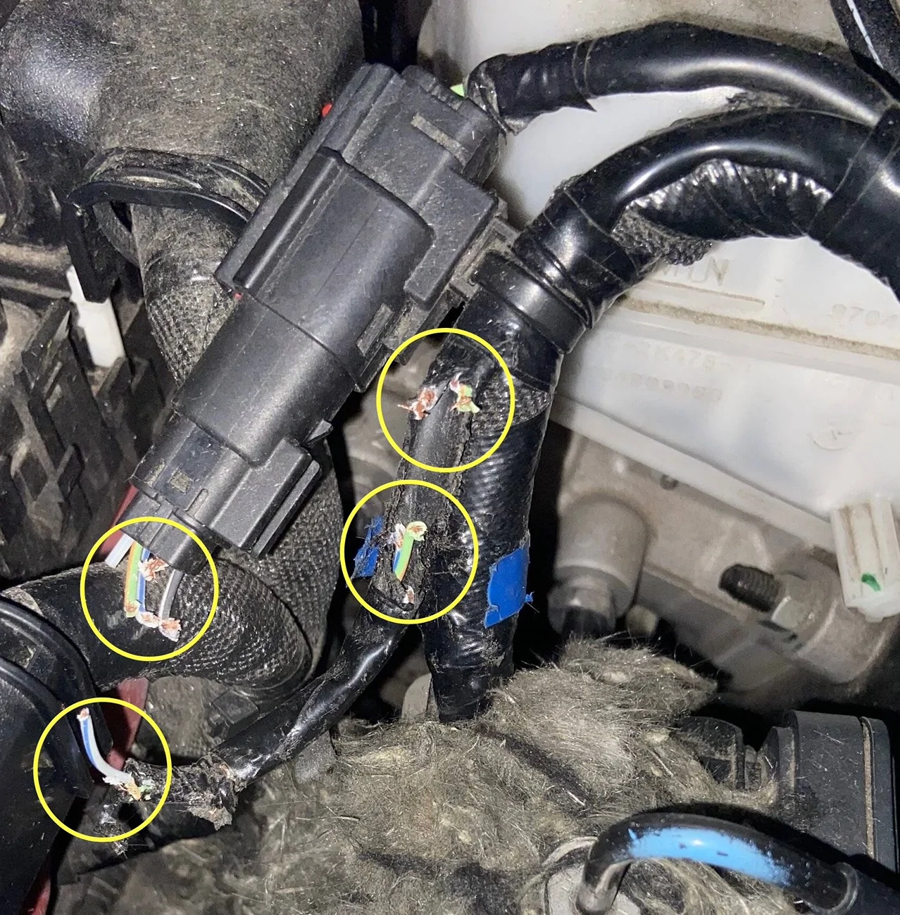

Add ABS and Trax light and camera code to the list. I checked the ground and it looked ok I'm going through as much of the wiring as I can but I'm no electrician. I suspect it's a problem on the passenger side, as I found evidence of rats there.
9,854
47,154
Actually, I hope it’s something simpler than that - undoing their damage can be very difficult and/or expensive. Too many of us have found out the hard way…

Haven't found any wiring damage so far but there's a lot to look at and test. I keep steel wool in the body to engine bay area's on each side and haven't seen a problem since.

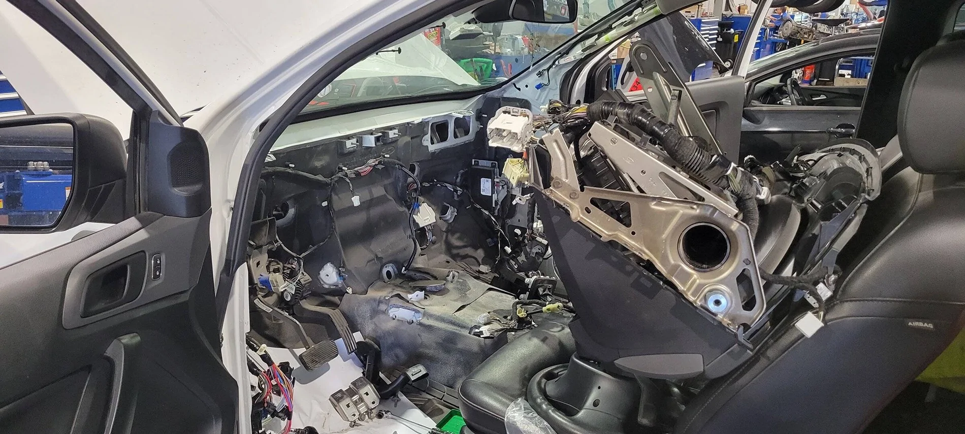

Starting to think this is behind the dash maybe? Plausible ? Anyone pulled a dash? I can get behind the glove box and the fuse box area easily but not sure about the rest.
9,854
47,154
You have to be very certain you want to go there.
That’s it, upside down, with the steering wheel resting on the driver’s seat.
