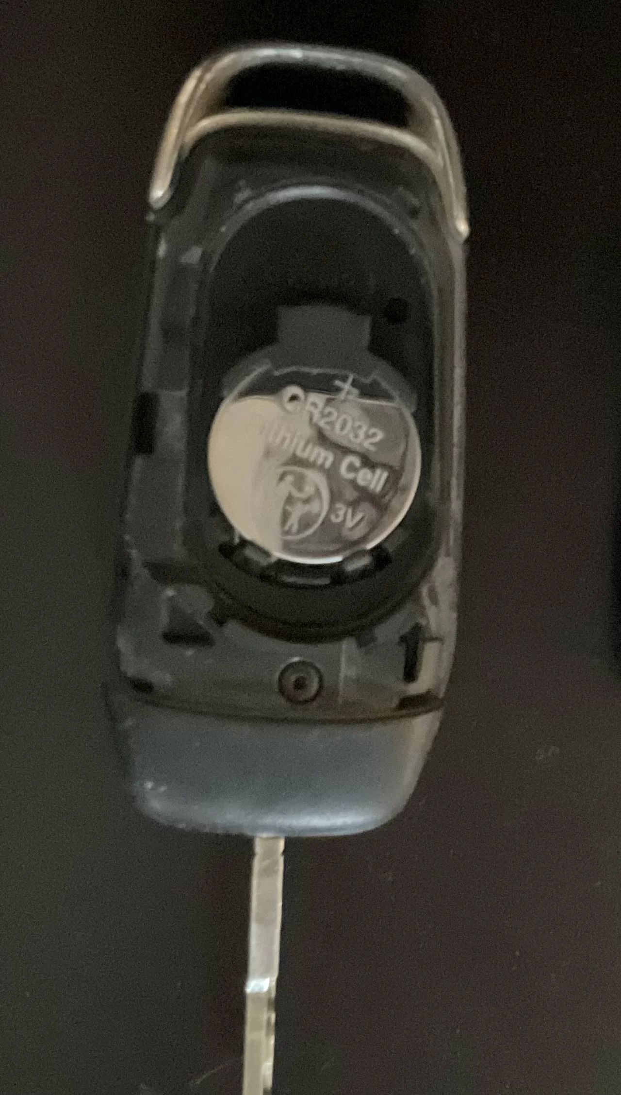

The battery in the key pad is not replaceable AFIK. I had one go bad in my 2014 Focus and they replaced the whole keypad under warranty. New key pads need to be encoded by the dealer only, to make them work. The battery in the key fob is a CR2032.
FYI, the battery in the Lariat fob is a CR2450, not a CR2032.
Motorpsychology
Nov 13, 2019
3,301
11,529
Prescott, WI
Vagabond
My bad. The owner's manual just says it's a 3V battery and I assumed 2032 without actually opening mine up. 2450 is also 3V but a slightly larger size and higher capacity.
I wouldn't have known except I just changed mine.

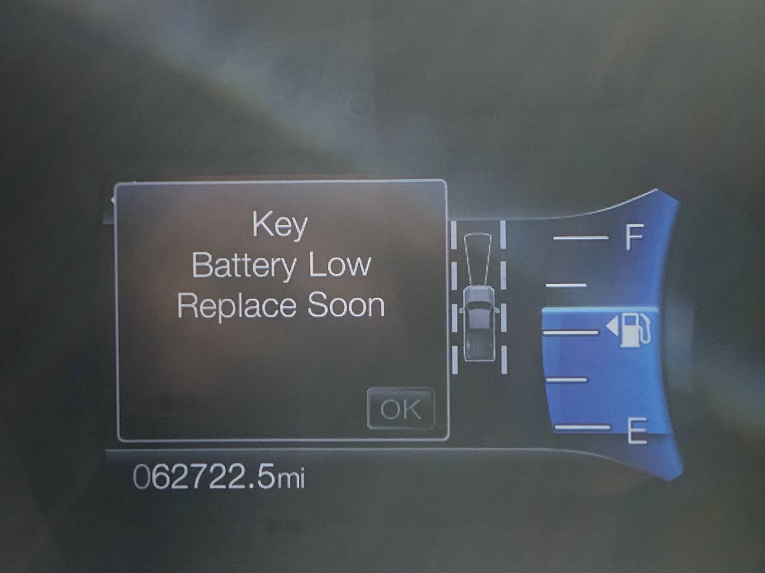

Received this message today time to change battery. Might as well change original H7 also.
Costco here I come.
