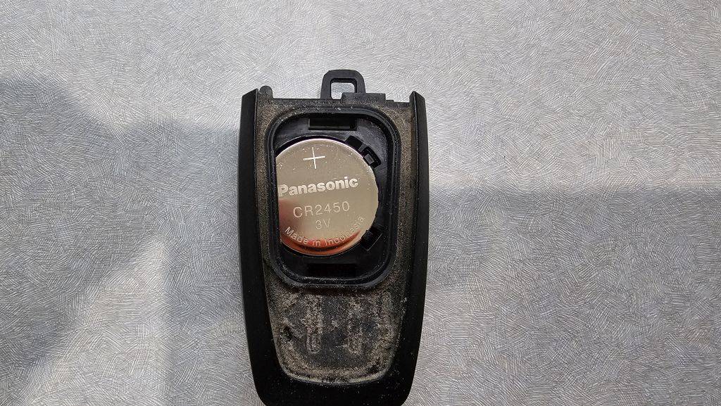

Not that I didn't believe you, but you guys got me wondering if all the fobs took the same battery. I opened mine up and apparently the answer is NO:
It appears the Lariat fob uses a CR2450
The bunny tells me this is due to the extra capacity needed for devices that require a steady power supply. ? ?
I"m guessing it is similar to the truck battery - the Lariat has a larger main battery too - more electronics and doo dads need more power.

The hitch safe has worked really well for me for about 4 years now - until the battery on the fob starting getting weak. I actually considered the door buttons, but I didn't like the "stick on" look of them.

Is sounds like the fob battery ws just too cold to fire at first. The button battery inside is replaceable and you're probably due for a new one. Not sure which fob you have, but isn't there an emergency key blade tucked in the fob?

I’m surprised if the fob battery is low/failing that you aren’t getting the warning alert on your dash on startup.
My Lariat is around the same age as yours, built January 2019, and I started to get this warning about 6 months ago. Changed the fob battery and all is good again.
I'm sure it was the cold that was the catalyst. When the fob is in my pocket it works fine. Being out in the cold for hours is what caused it. Either way, almost 5 years on the original battery is pretty good - I'm changing it out.
