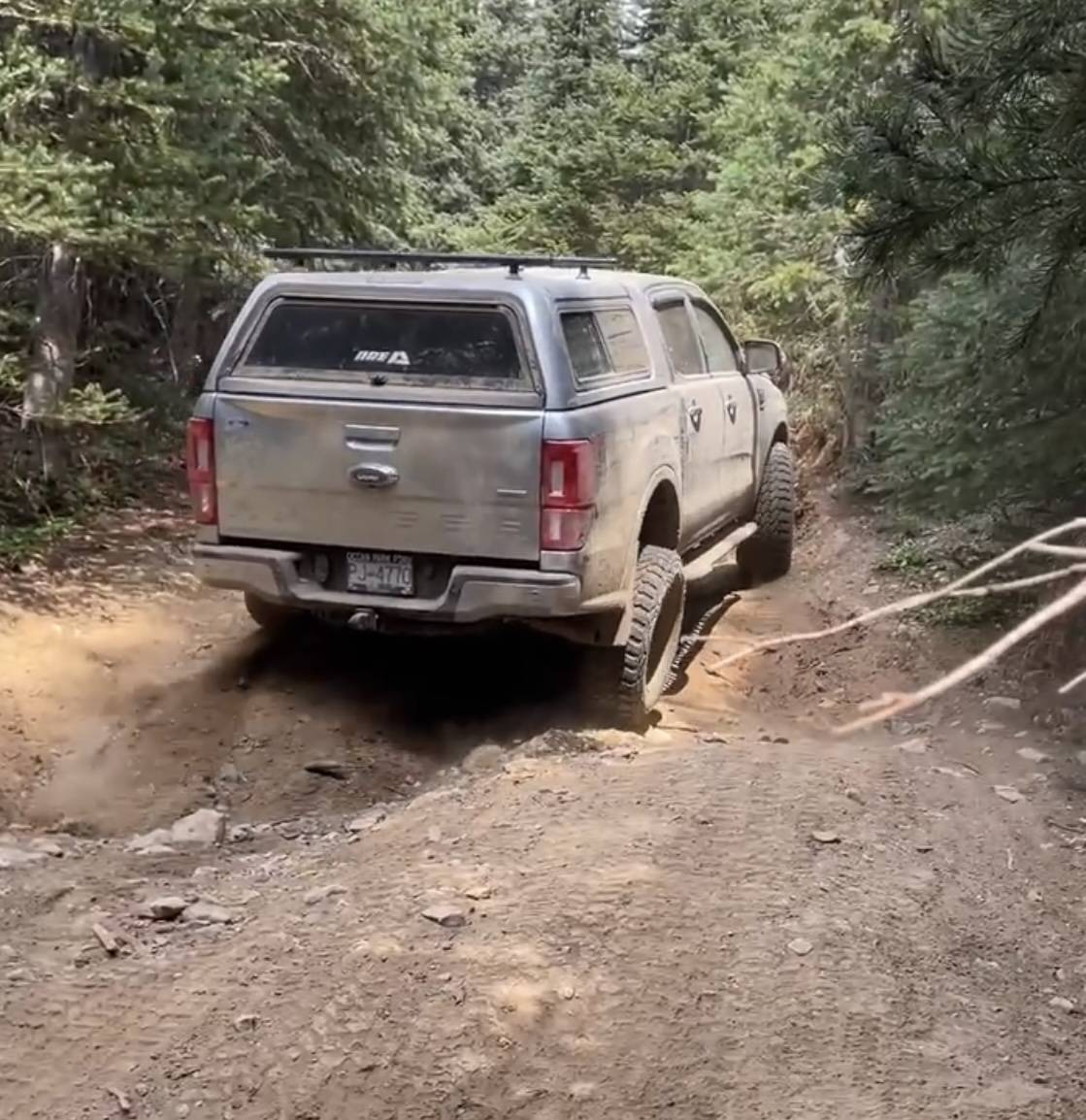

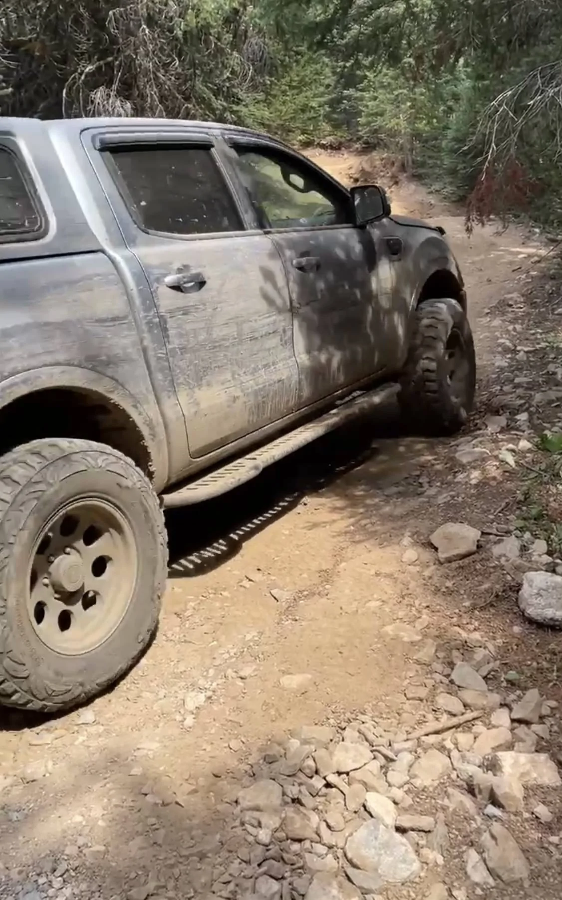

Cool truck. Yes I am thinking of coastal Offroad’s rear bumper, how do you like it? They are local for me so would be pretty straightforward. It seems like you had icon leafs and switched to OME? If so, How come? Why did you go with the ARB front bumper and not the coastal off-road front bumper? was there any loss in approach angle because the arb sticks out a bit?
I love the Coastal rear bumper. The Icons were great but were unable to handle the weight I carry with my bedrack/tent. The OME springs are a higher spring rate. They ride great and handle the weight a lot better.
I don't know how to weld and didn't have someone who could weld the front bumper for me. Plus, I really like the style of the ARB. I've had a lot of trucks and always wanted one. I don't know about approach angle, but the weight of the bumper and winch is why I went with the 1" strut spacers.
Why do you have strut spacers when you can simply get the correct strut and spring and create a better ride?
I have the OME HD struts with the 600 lb springs and the front definitely dipped under the weight of the bumper. The strut spacer put the height back where it should be. I still get the ride I want and the height I want. OME actually offers strut spacers for exactly this reason. Their strut spacers are 5mm which would five you 10mm additional height, these are just a bit taller. Your condescension has been noted.

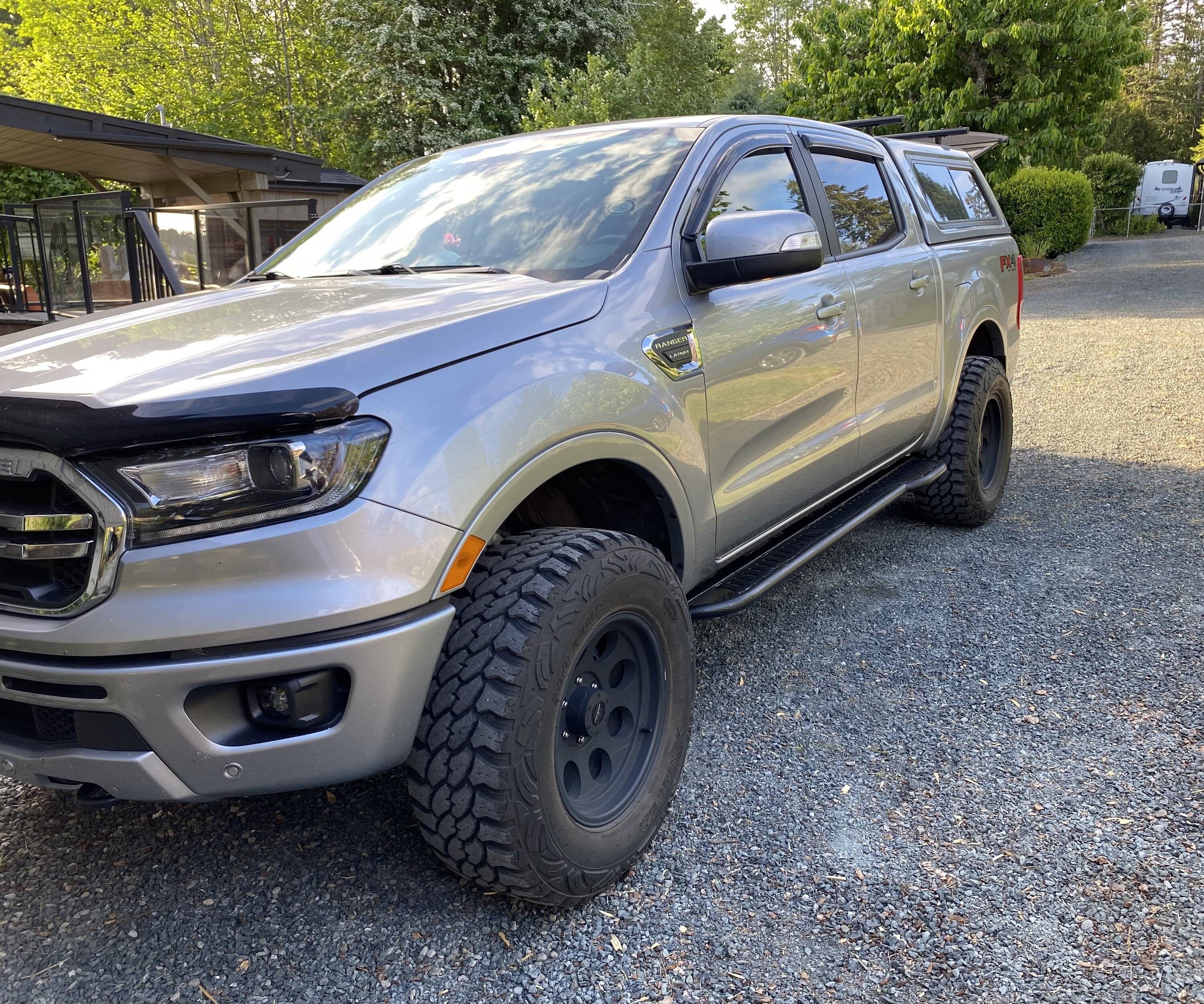

LookARE
May 24, 2022
74
146
kokomo
Ranger
Hello,
I am looking for some advice on how to finish my 2020 ford ranger build?
Use:
daily driver - weekend warrior, I do encounter mid level rock crawling trails. I don’t encounter high speed desert whoops, but like to cruise logging roads with no worries and clear rocks
Current setup:
Suspension
- Bilstein 6112 with 5160 remotes in the rear. 2.5 - 3” of lift. I Like the performance and ride quality.
Coastal off-road rock sliders.
Tires, pro comp xtreme mt2 285/70/17. too aggressive for on road comfort during long trips. Great off-road.
wheels: pro comp 69 series vintage, flat black, 17x9 -6 offset, backspacing = 4.75
Needs/ limitations - currently I am hitting the truck bed behind the rear tires.
Wants - eventually a winch, maintain / more clearance, more body protection. Possibly fitting 34” tires, I don’t mind trimming a bit
Thoughts:
Arb front and back bumpers, concern is weight with current suspension.
What would you recommend to help complete my build? I need to either protect or clear the rear of the truck over obstacles and would like to add a winch, maybe make it easier to squeeze 34” tires, thinking upper control arms and front bumper with clearance.
