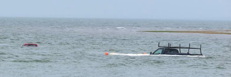

If you are not driving down a tidal beach it may not be an issue but if the beach is affected by tides, make sure you know when they are and how much your location will be affected. Everyone likes to go out on Cape Point until there is no way back to the main beach. Then it gets real.
