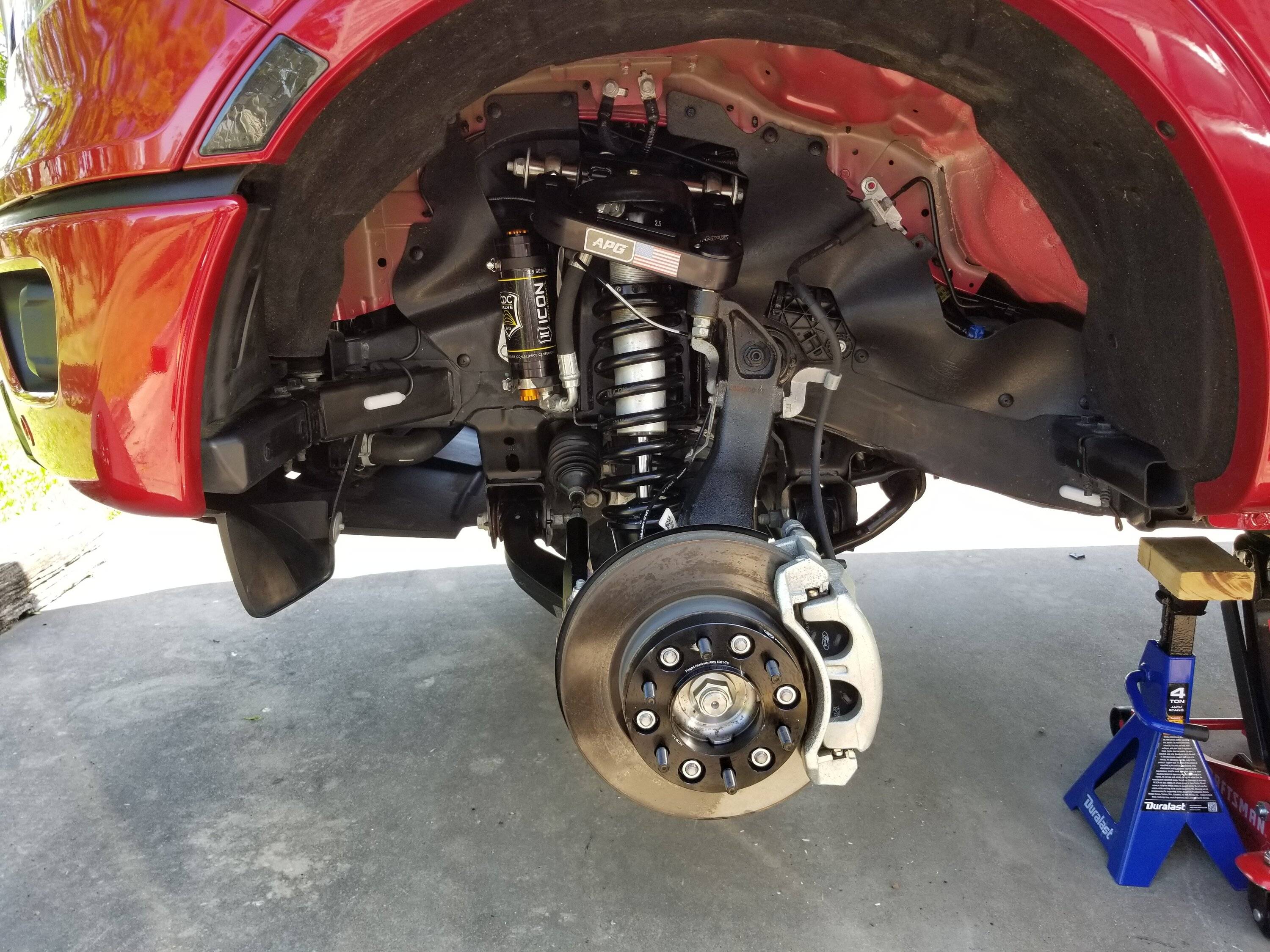

I have the APG Billet UCA's....they were only ones made for Steel spindles at the time I did mine...the ICON tubular are a popular choice at a lower price point...
