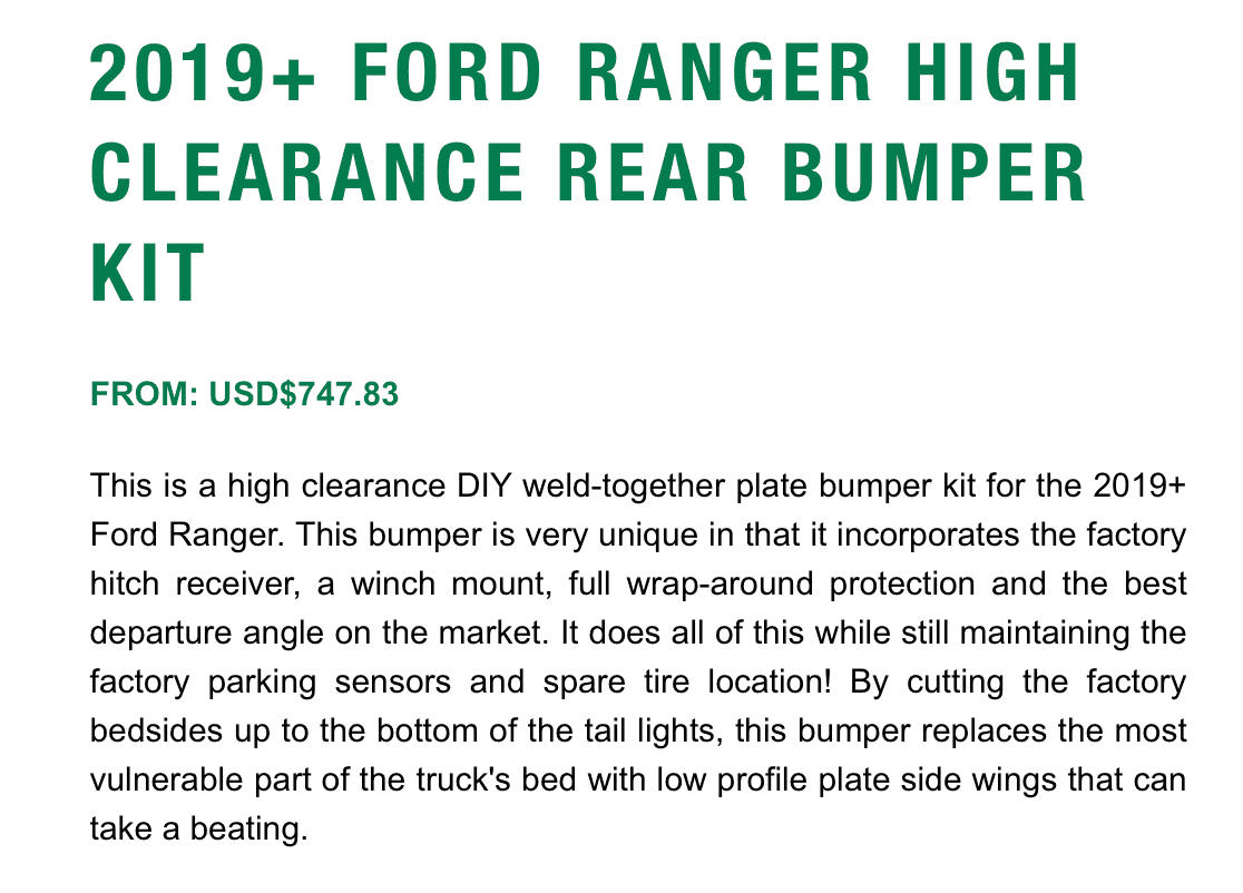

I'm not trying to make a case for this bumper not being for me, I am simply stating that the Coastal website shows cutaway fenders and rivets for those who may be considering that brand. The screenshot below on Coastal's site suggests that the fender be cut off to accommodate the bumper, no mention of a wide body -- they should clarify that. Can you show us a pic of your Coastal rear bumper?

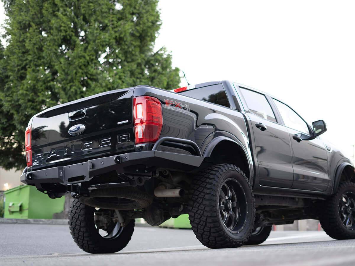

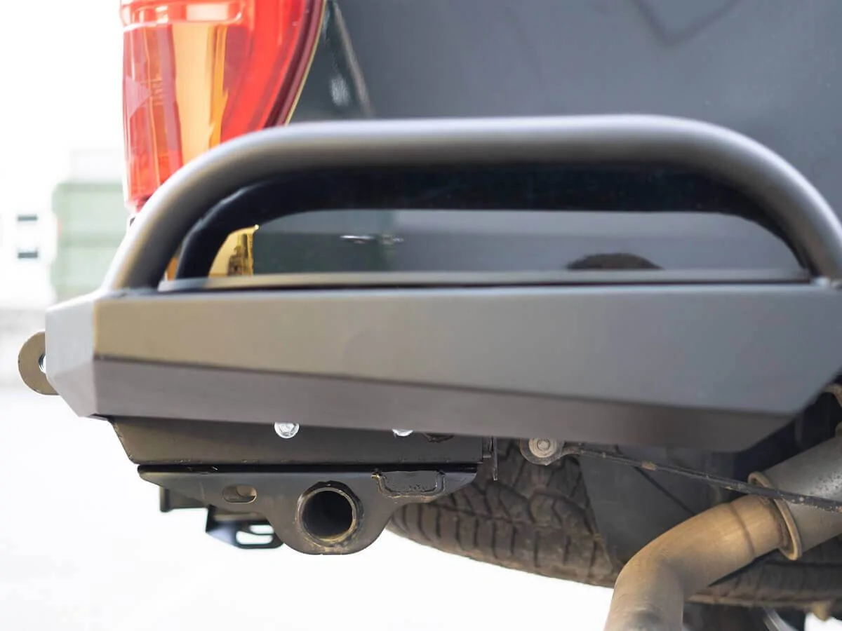

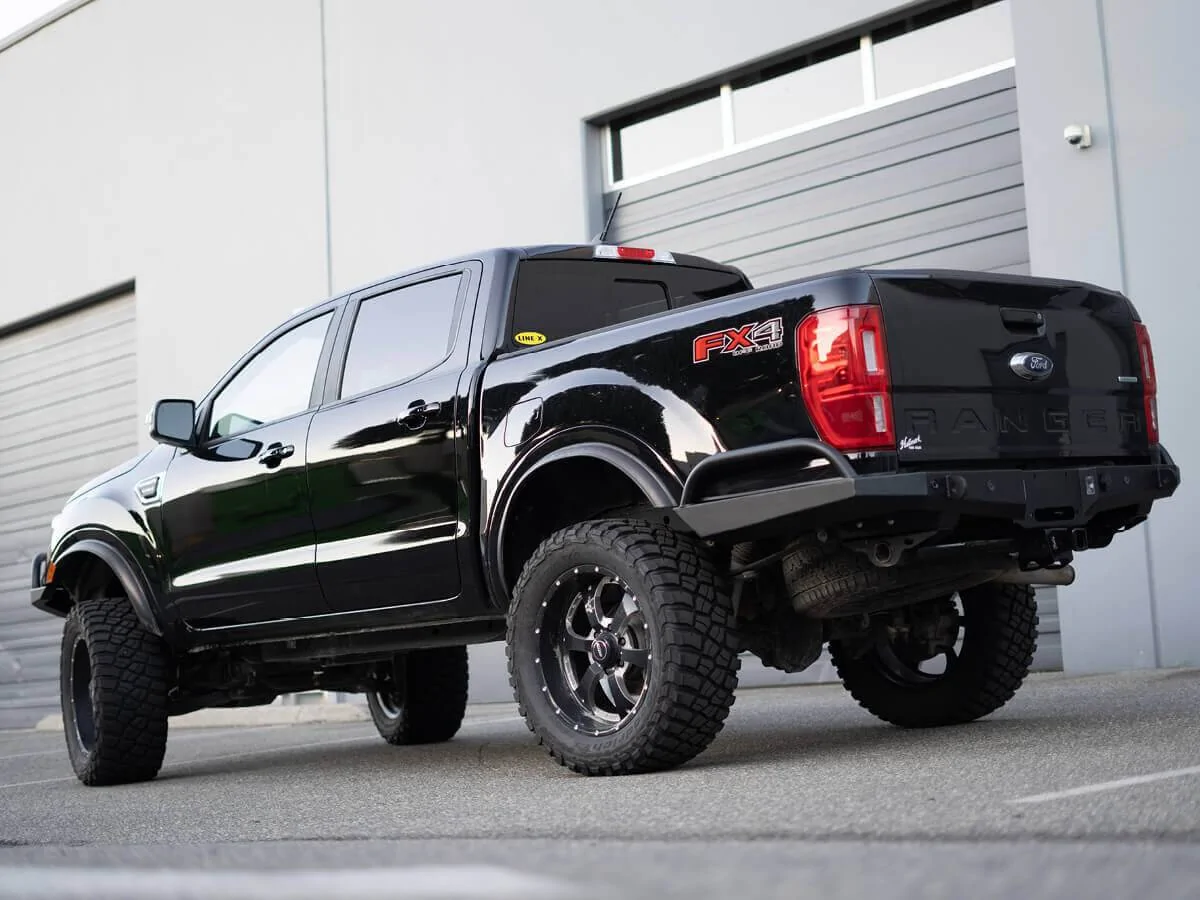

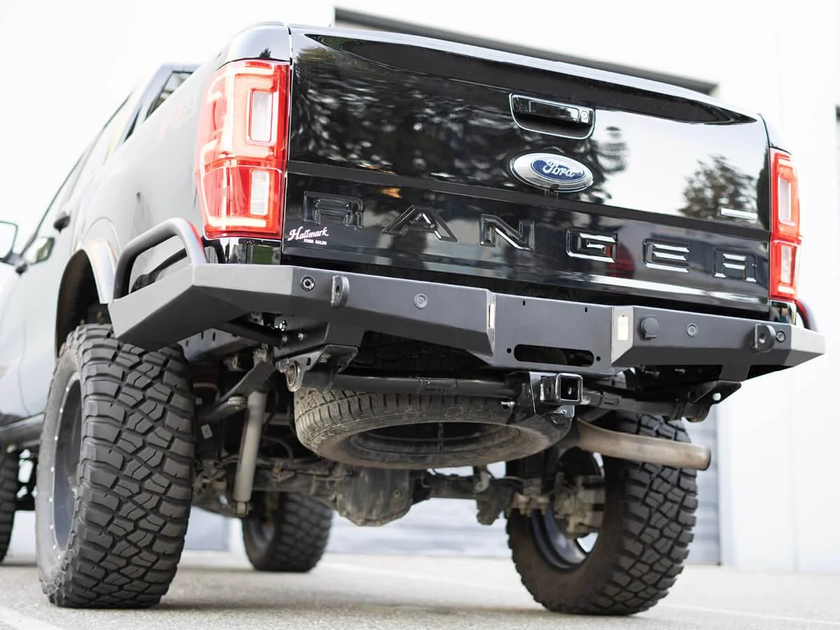

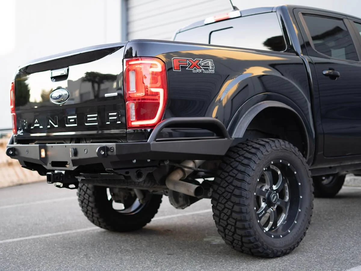

If it helps, here are the other photos from their website:

Oh I've seen those photos, but they should explain what the photos mean -- that you don't have to cut and rivet with a non-wide body. They only talk about cutting bodywork in their description, with zero mention of wide body. It might be assumed by some that these photos simply don't show the cut and rivets because the bumper includes the riser loop.

You do have to cut the fenders, but you do not have to rivet anything. Again: yes to cutting, no to rivets. I don't have any rivets and the excerpt you posted makes no mention of rivets. I can get pictures of my bumper, but they would look just like the above photos.
