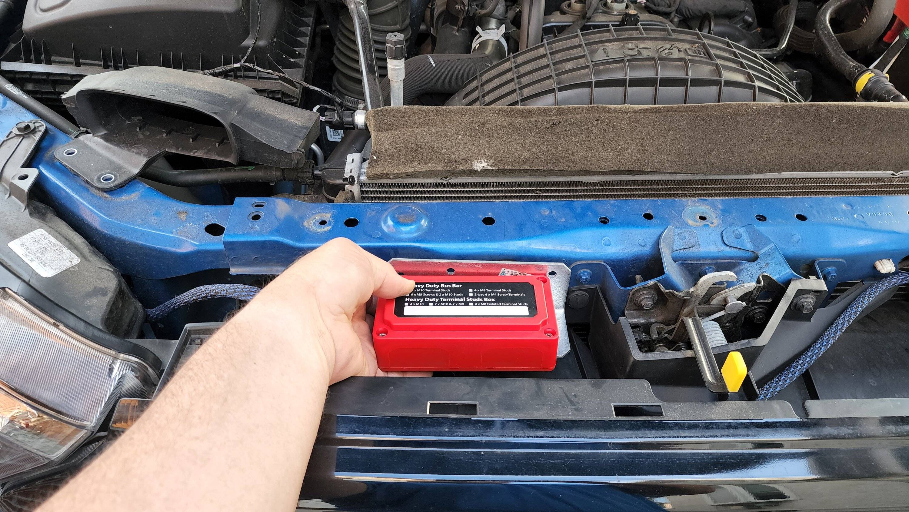

Bus bar done.
Now for ground:

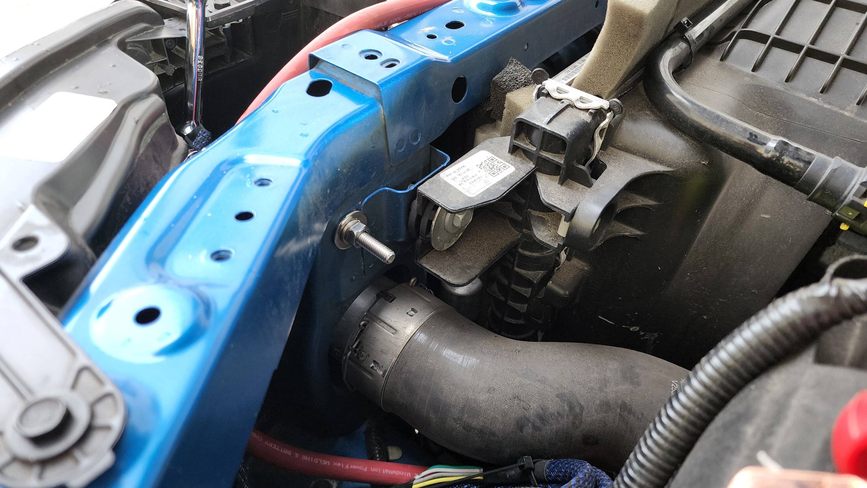

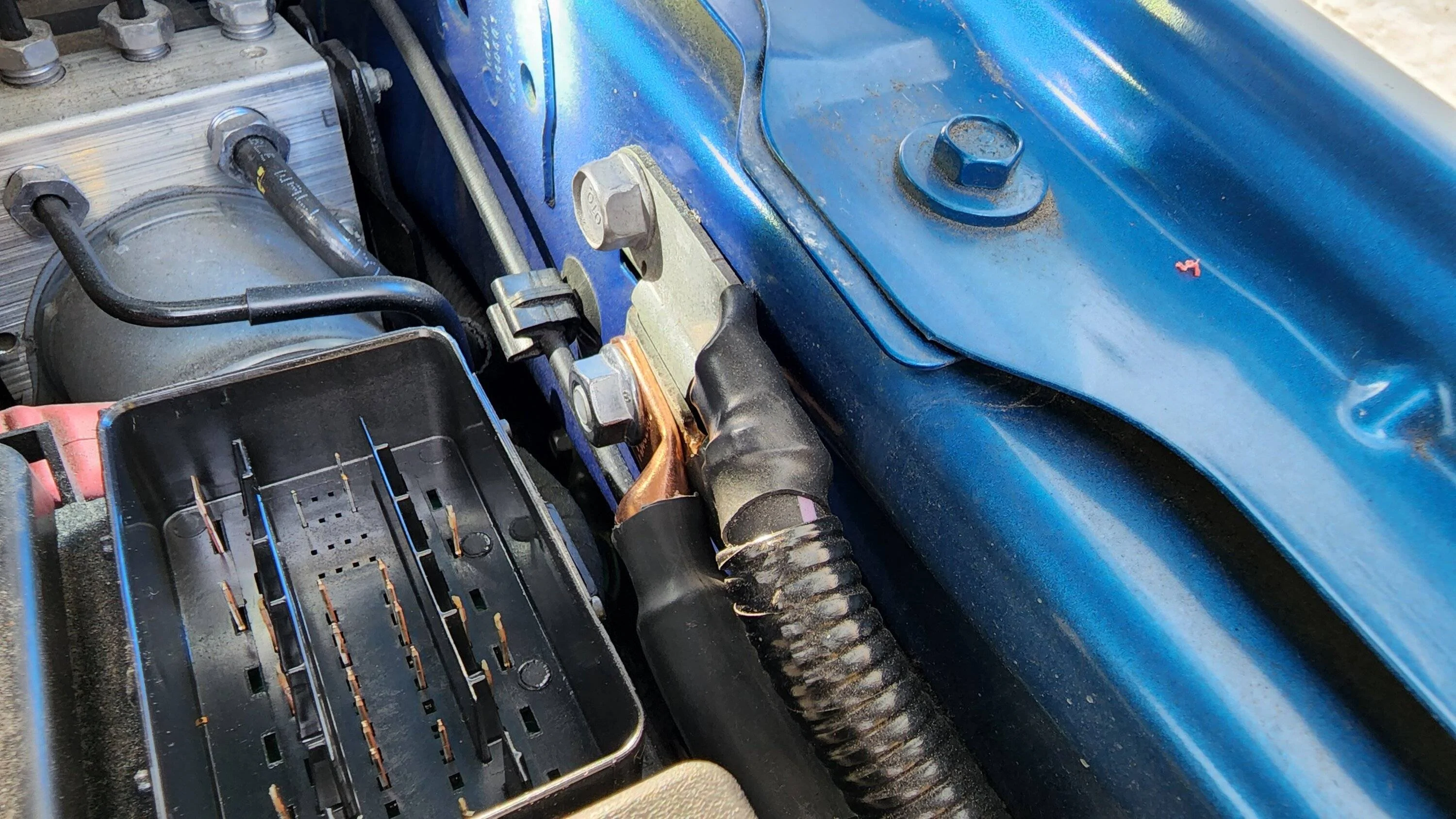

I'm running a 1/0 cable from here...
To here...
I popped that M8x30 bolt through a factory hole. I'll use it as a junction point to connect the winch, a relay box, and a cable to the bed.
I've read so many articles and threads about grounding a winch. The most compelling comment I've seen, was something on our site about not bypassing the truck's BMS. I'm gonna focus on that and make the best connections possible.

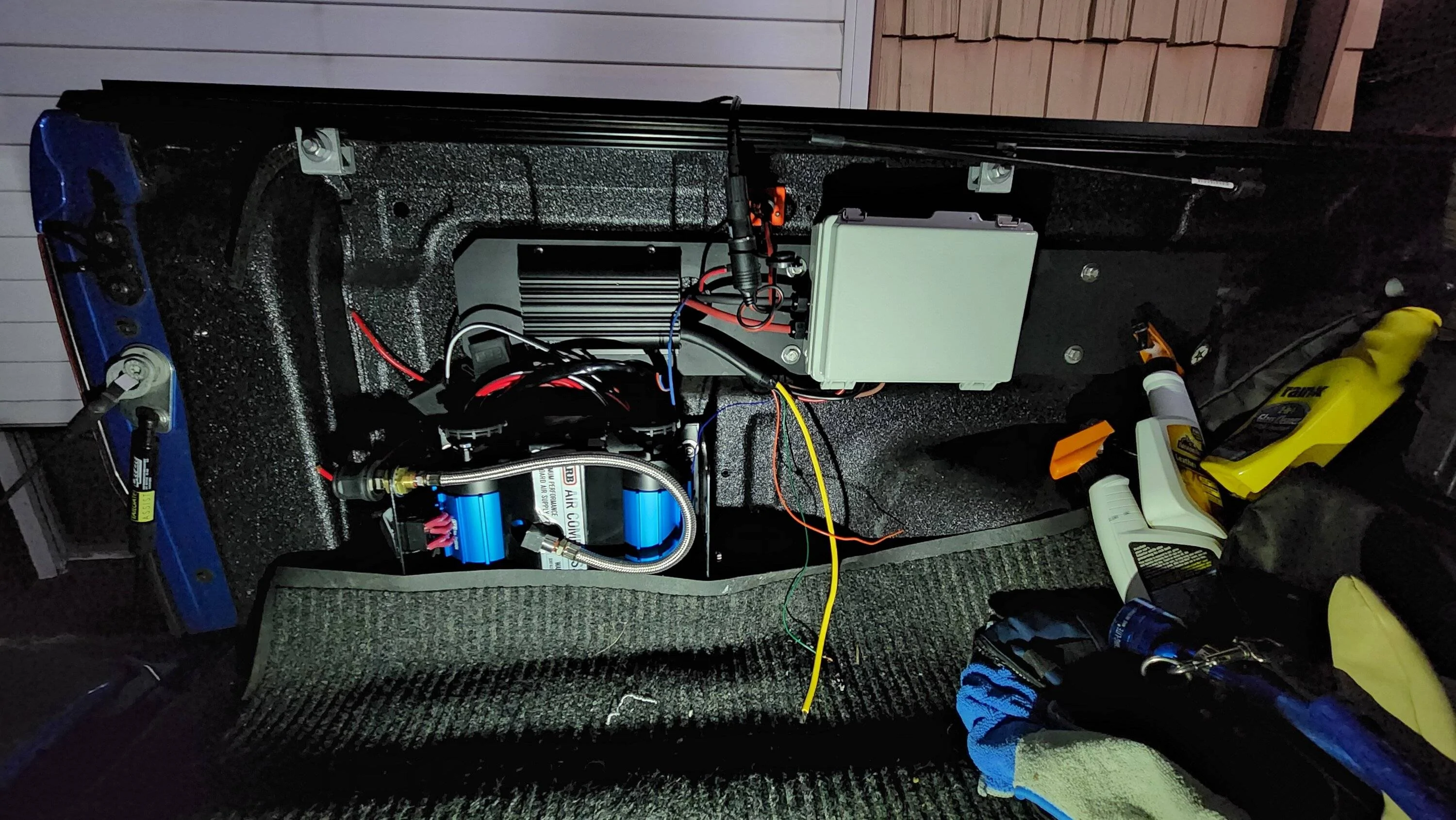

Does anyone have power run to the bed? If so, what gauge cable did you use?
I have an ARB Twin Compressor back there now awaiting hook-up, and maybe a fridge in the future.

I ran 12awg to the bed for a dedicated output. Turns out I will plug my Bluetti into it, and my fridge into the Bluetti. The Iceco fridge draws 15amp max, per the fuse. I may run a heavy cable at some point in the future. It is easy enough going down the driver side.

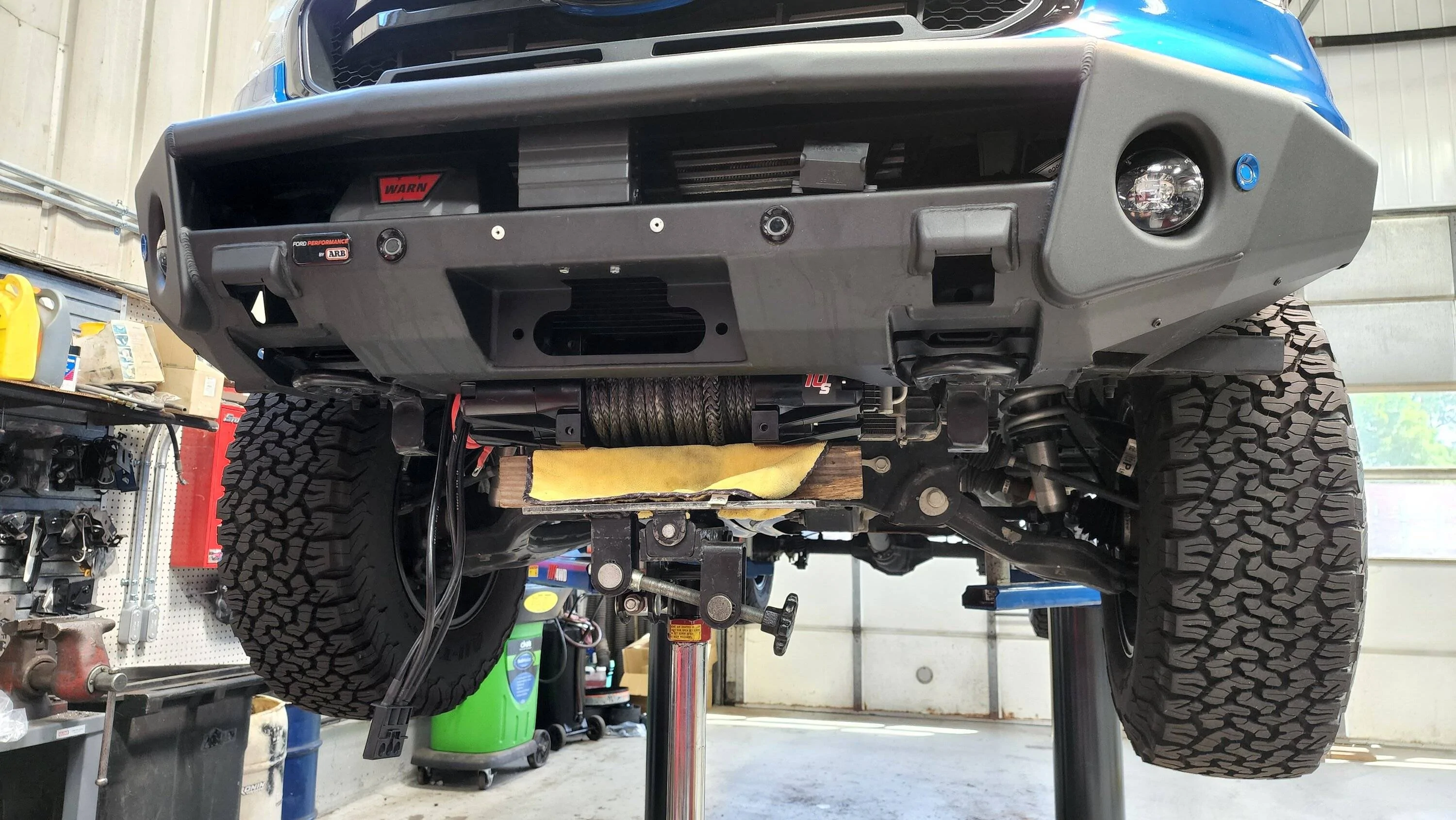

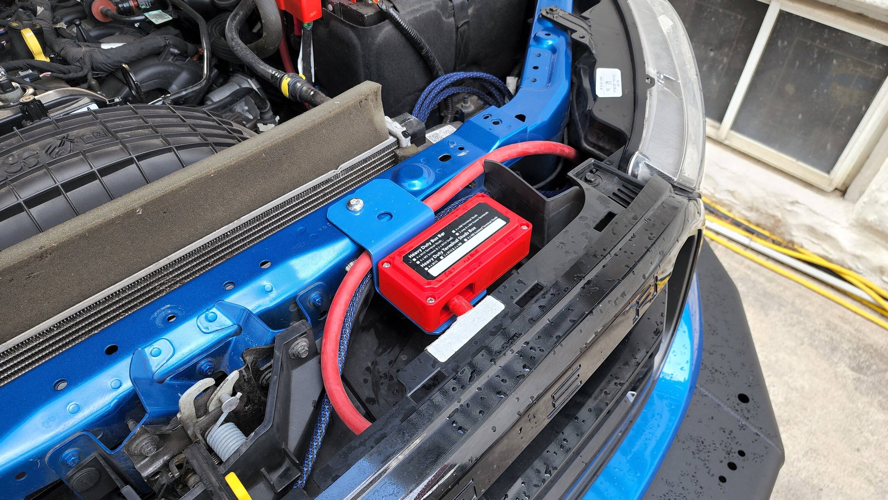

Ok... Today's the big day. Back at OK4WD for my winch install:
I'm hoping all the pre-work pays off. I also asked them if they would run the 4 gauge cable while the truck is in the air.

And so they did...
OK4WD loomed and ran my 4 gauge cable front to back. I asked the tech if he could add in a length of 16 or 18 along with it so I could have an ignition wire back there also. I terminated the front and attached it into my bus bar box, but the rear is just tied up under the rear fender. I'll deal with it next time I'm off. The labor rate at OK4WD is certainly healthy, but now I don't have to crawl around under there. That's a win to me.

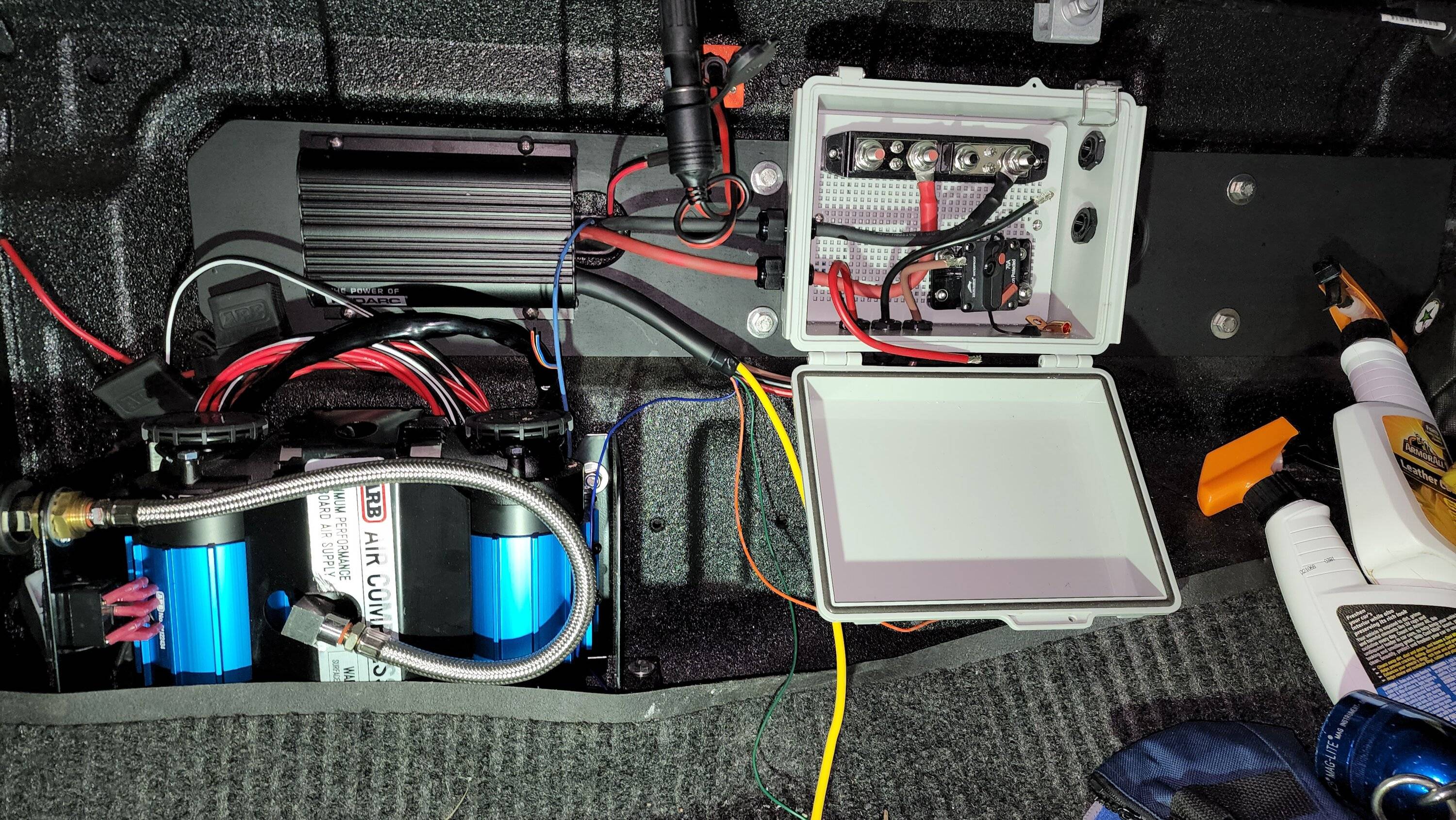

This is the other end of the cable from the bus bar under the hood.
That cable will feed this Redarc BCDC1240D.
Hopefully by the end of Monday, the fridge will be running off an aux battery.

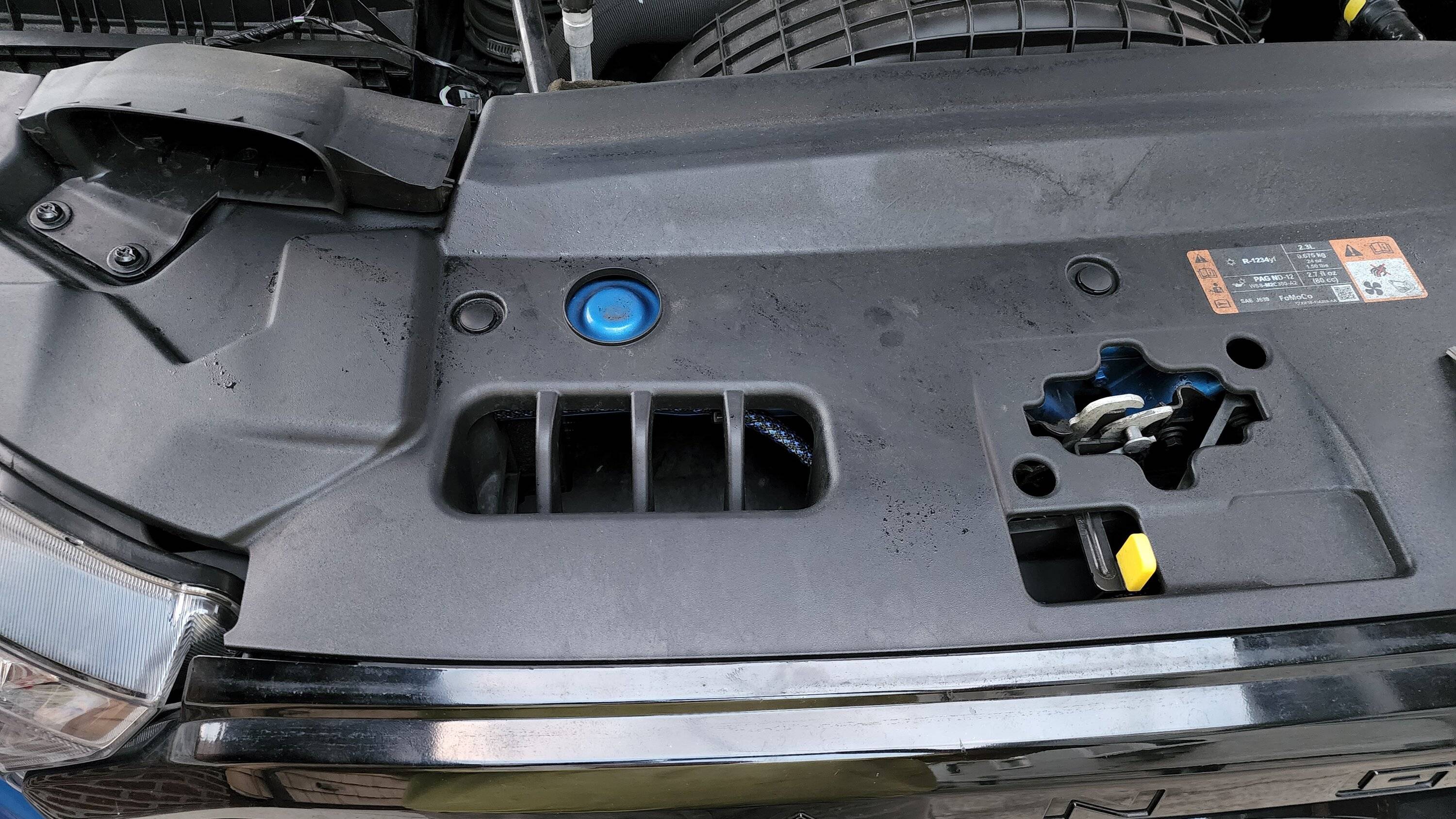

I wanna install this here:
But it ends up under this vent:
Does anyone think this would be a problem? I don't totally understand the purpose of this vent to begin with.
Thanks...
If I am not mistaken that is the air intake for the motor. If you look that area is sealed with a gasket. so the air flow will go to the motor intake.

Air intake is the scoop to the left. Phil has indicated that the other opening is more cooling related airflow.

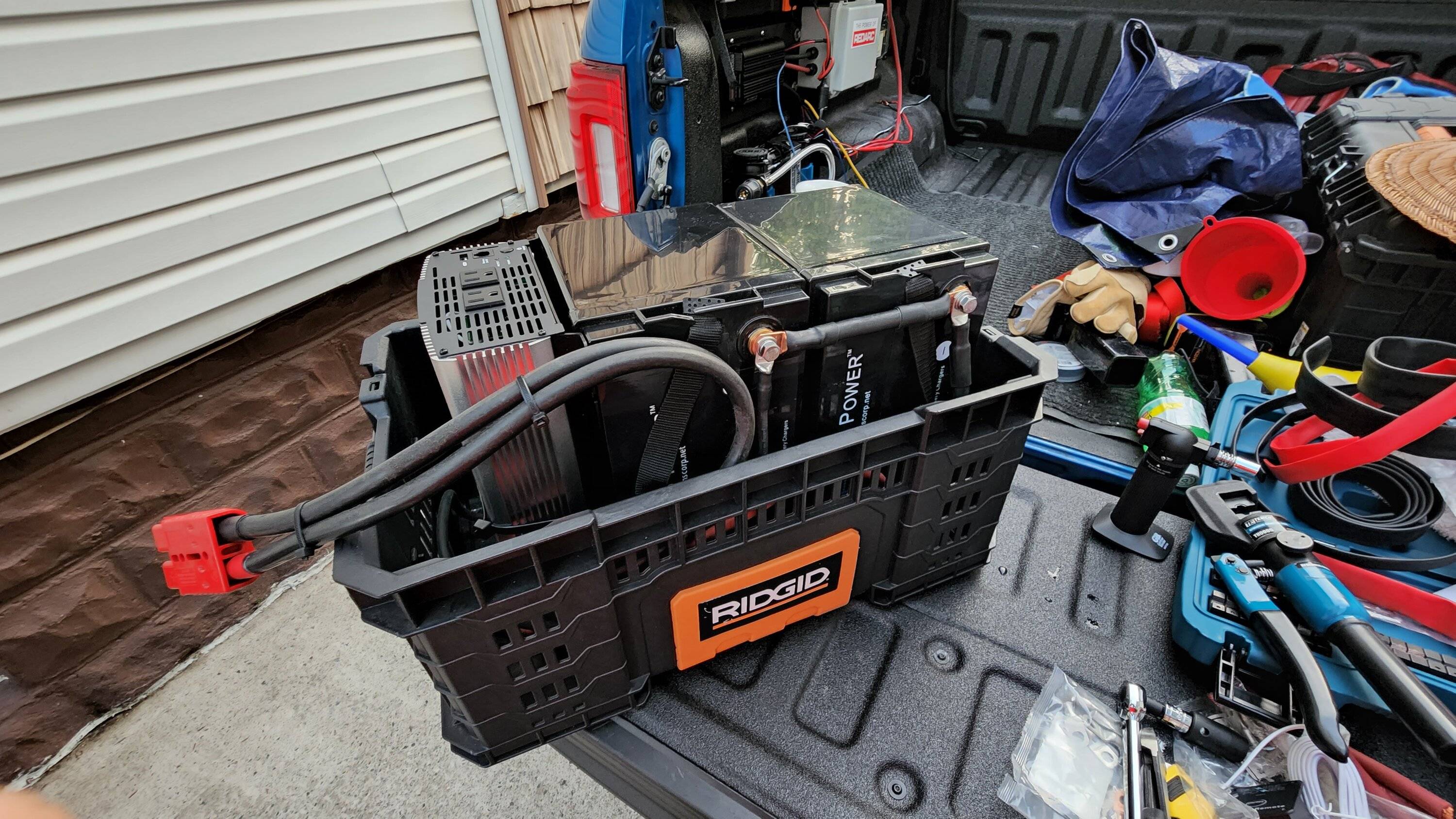

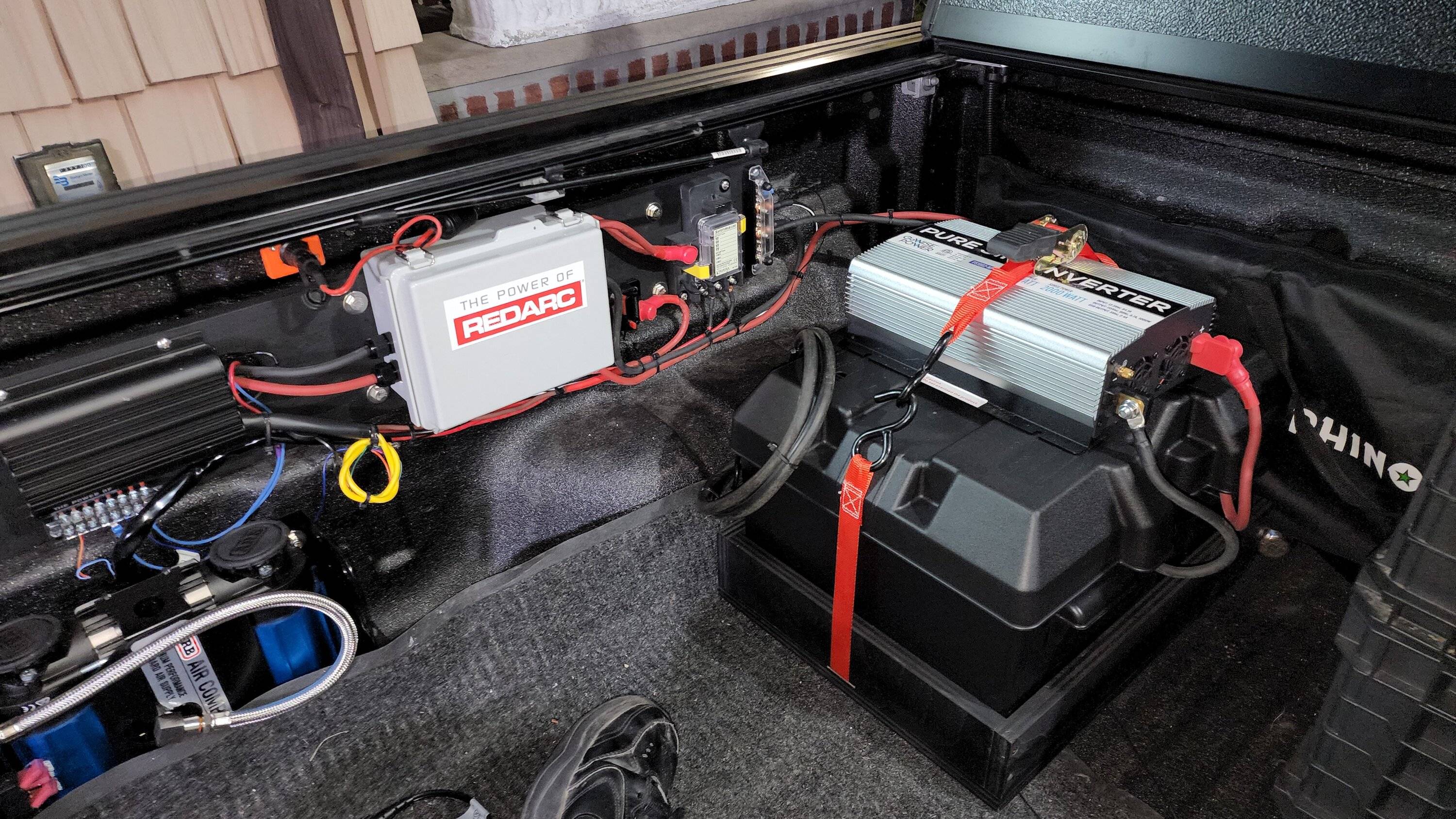

Re-purposed 2 100ah batteries and a 1000 watt inverter.

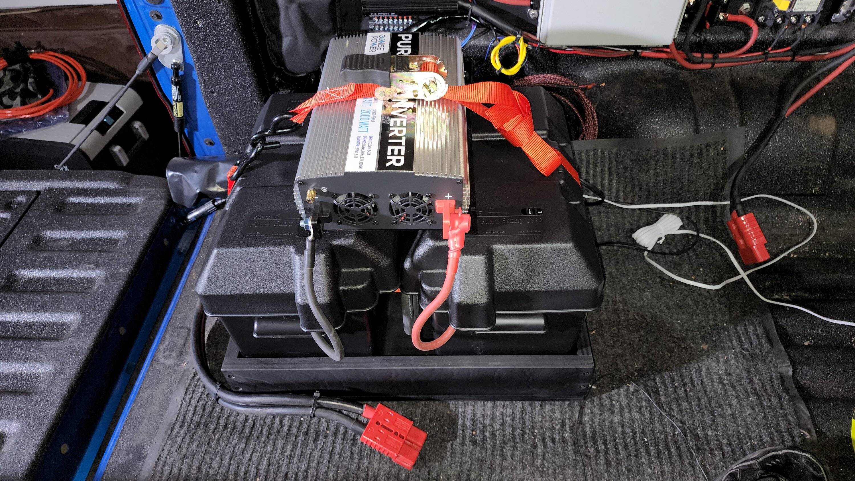

So that battery setup worked, but it was precarious. I got a couple of battery boxes and made this....
It will sit in the back corner behind the fridge...
Now I need to install the 12v receptacles and the aux battery setup will be done.
...for now.
