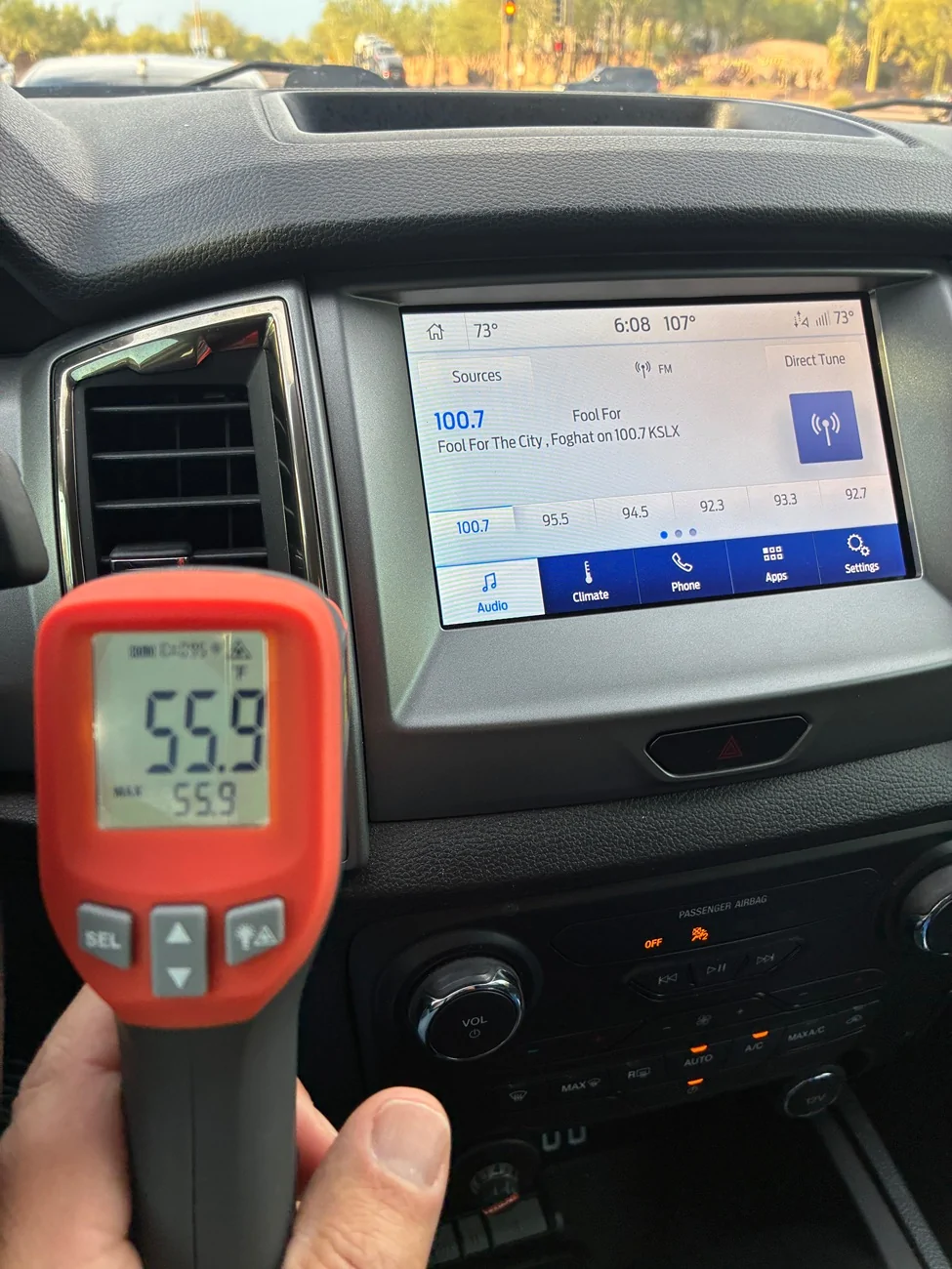

Here is the temperature reading from mine in Phoenix just after 6pm
So it's roughly the same as mine then by way of my analog thermometer. I guess that means the truck is normal and it's probably ME that's going sideways on temps.
Thanks much!
