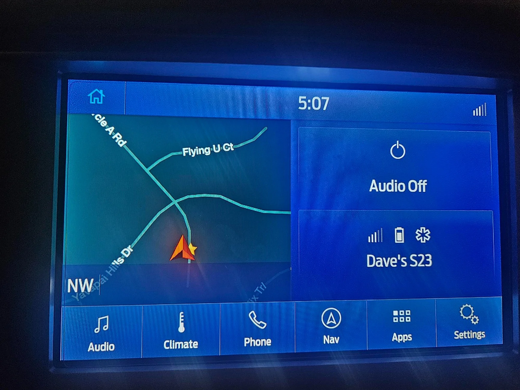

I agree completely, just pointing out other options. I live in AZ so I get it. Funny side note. Pictures of Sync 3 screens looked funny to me. I changed mine to Night Mode always over 3 years ago and pictures in Day Mode look odd. :) Not used to seeing it.
I just changed the display screen to full time Night mode. I do like that better. Thank you for showing the image of yours like that.

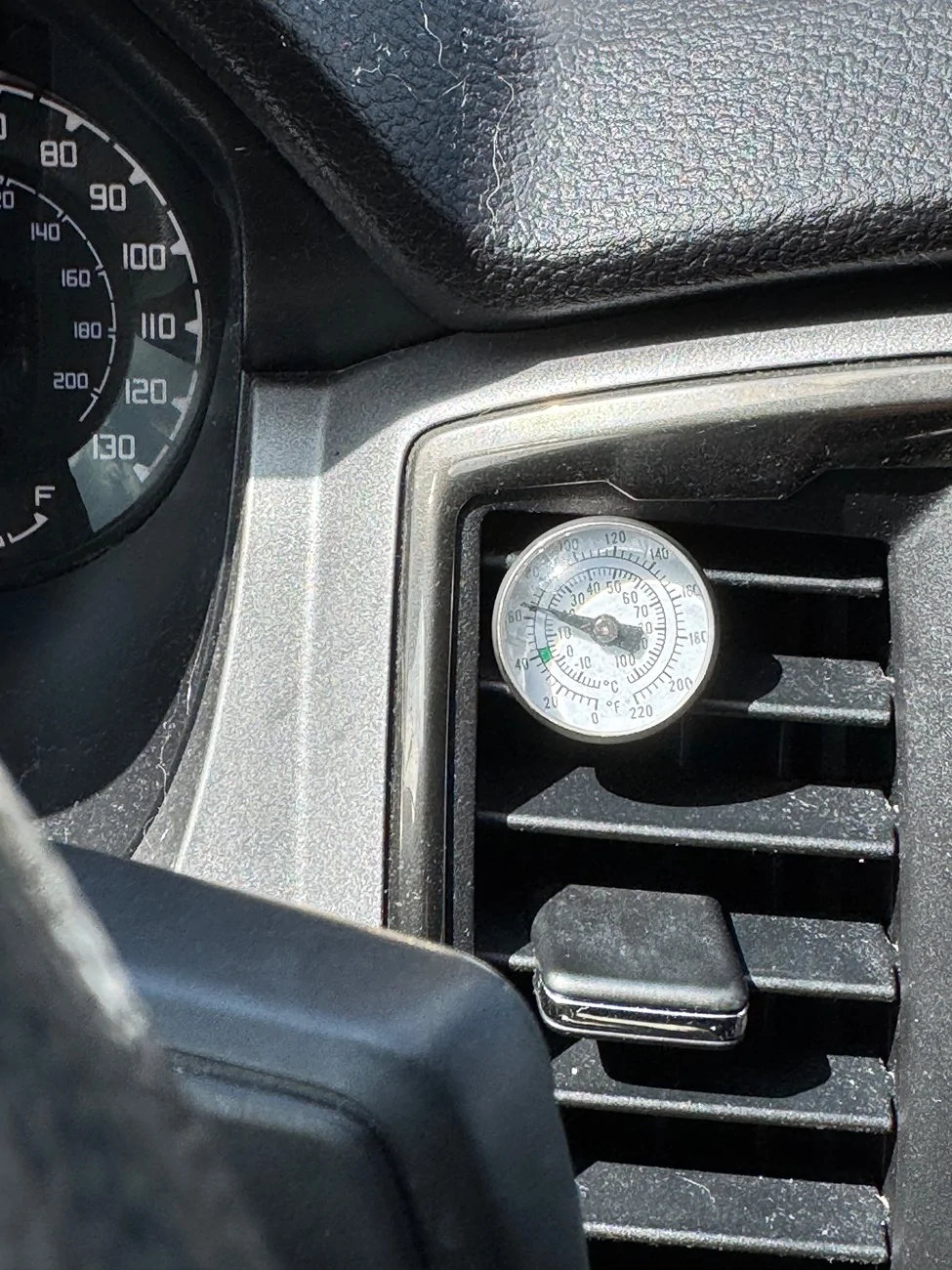

From my climate control thread
AC:
In Manual Mode - Drive the Temp (LO) and you should see a low Panel temperature reading, the actual reading will vary due to the ambient temp and humidity.
Some basic temp outputs for Ref:
70 Deg Day - Output Temp 35-40 Deg
80 Deg Day - Output Temp 45-50 Deg
100 Deg Day - Output Temp 55-60 Deg
The basic average is 35 to 40 Deg lower than the Ambient (Outside Temp)
If not near these (average) temps - I would check for debris blocking the condenser / radiator - very common to see build up in between them, before checking the freon charge

This is good information as my output temp is nowhere near 60 degrees with the outside tempature being 100+

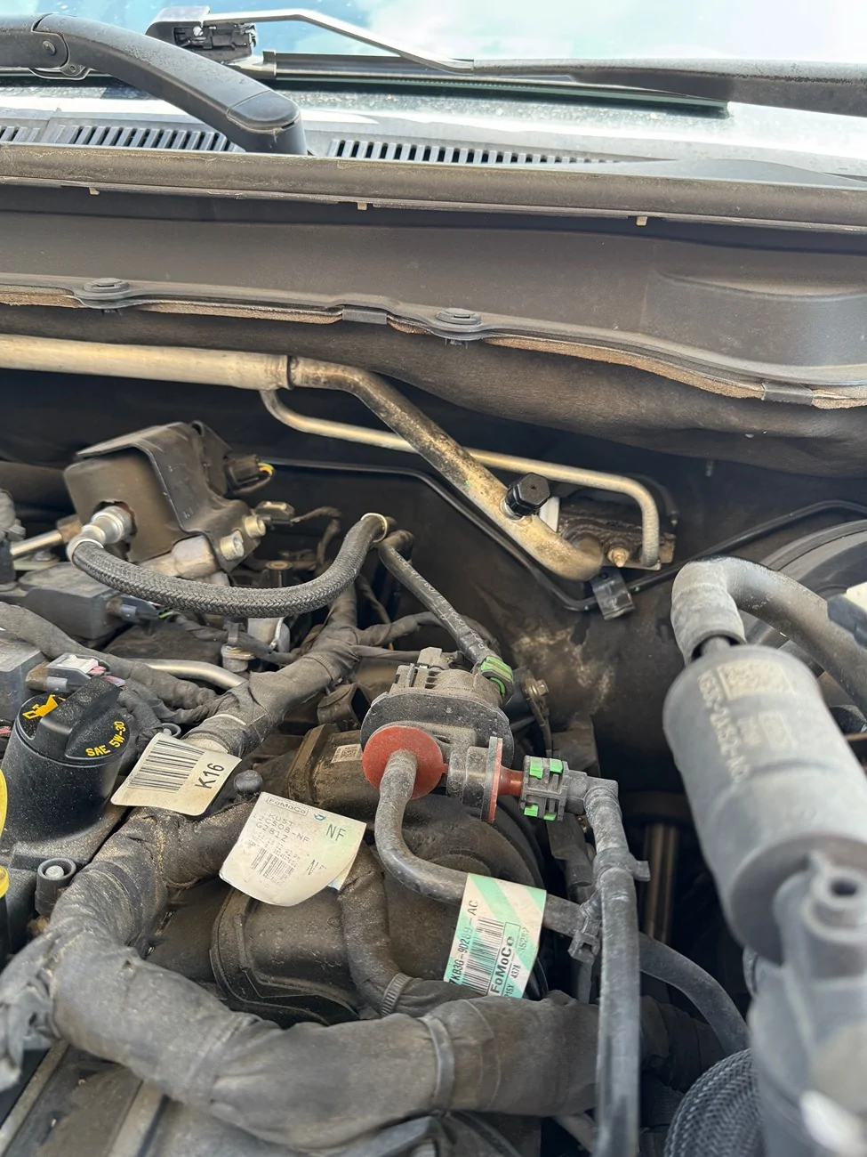

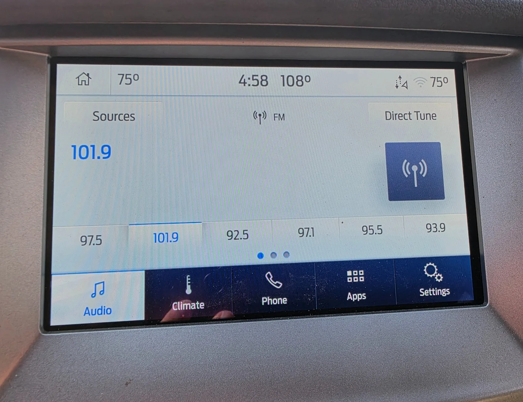

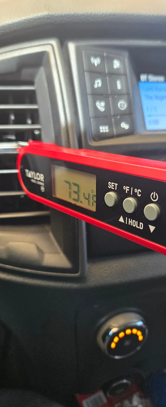

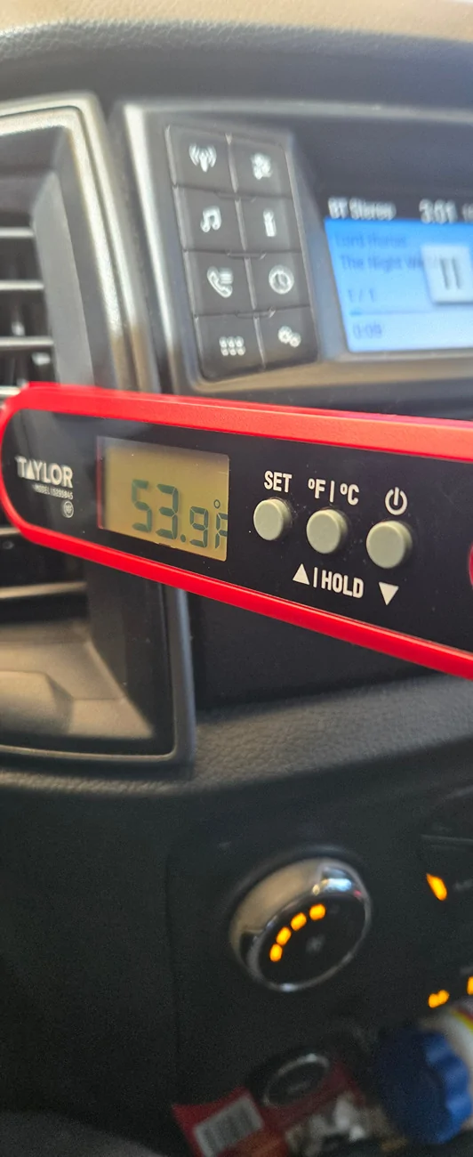

I saw no blockages and added a can of Freon. One can brought down the temps considerably while at a stop. That pipe seems to be a little....oily. The first temp pic was when I was on my way to get a can of Freon, and the second was after adding it. I may actually be able to turn down the fan speed for my future drives to work! Sorry OP, I didn't mean to hijack your thread
I would certainly get your service. I can see the leak where the lines go directly to the expansion block.
