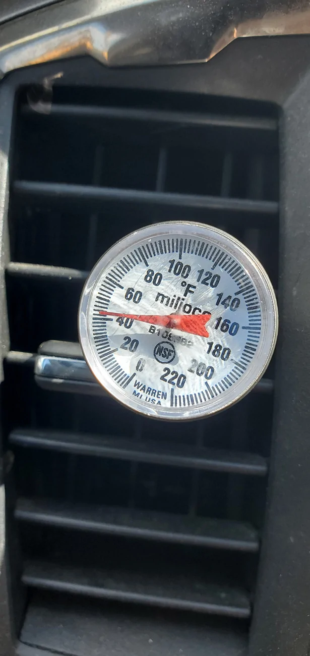

I use a standard HVAC stick just shoved in the vent.
never really had any issues with A/C or Heat, knock on wood ....

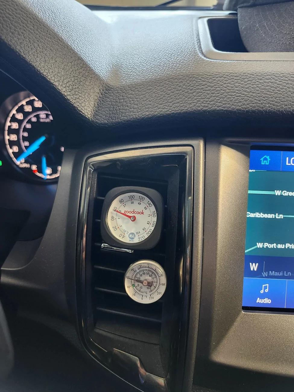

Remembering that we have a meat thermometer, I stuck that in the vent on the way to work this morning, outside temp was 95* at 0520. Meat thermometer just would not go below 60* on recirculated air while driving 72 mph.
On the way home I stopped at AutoZone and got a thermometer and stuck it in the vent with the Meat thermometer. 114* outside temp on the way home.
Both thermometers would not go below 60*, so based on the chart posted earlier this is about as good as I can expect. I WANT to say it used to be cooler during summer months but maybe that's just a fig Newton of my imagination.
Anyway, interesting to note that upon leaving from work the meat thermometer registered just a bit above 140*. Toasty.

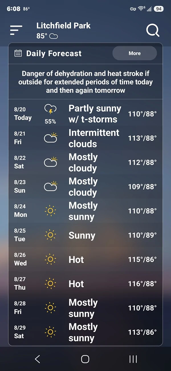

Chris, FWIW we are also going through the "Extreme Heat Warning" with temps between 110-115 here in Vegas as well and I've noticed the Truck seems to not be able to produce cool enough air to cool the cabin when the temps are at the extreme. End of last week we had monsoon rains and temperatures dropped to 87 for a few days and I noticed the AC was nice and cool again...
I don't know if the heat is putting extra strain on the AC equipment or what but I felt it's worth it to note I'm seeing similar symptoms over here.
