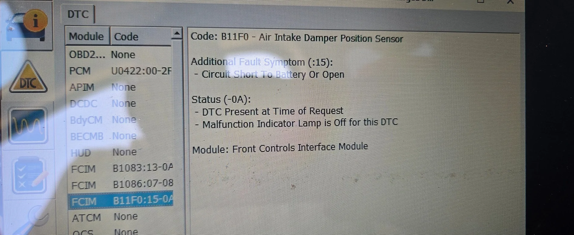

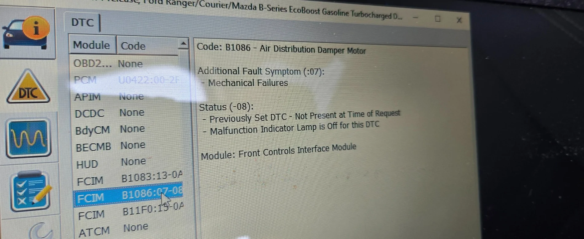

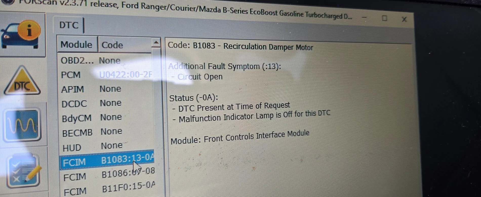

For some reason iam able to get dtc for the fcim but not live data as for the codes I was expecting the recycle door circuit since it's unplugged what would be explain the others or would the recycle fault trigger the others ?

Now for the disconnected (Air Inlet Door - Actuator) - This is (HIGHLY) likely your issue, the FCIM cannot see the door position and cannot command the (Max AC) - although you have (Indication) its in (Max AC) its actually not,
Remember the (True / False) PIDs I mentioned - I suspect the full cold and max ac - issues are generating a - fault PID to go - True, meaning its affecting the - Clutch and Compressor - control.
And it would be the - Missing Message from climate control - most likely reading - True
I would fix this issue and the wiring - behind the scenes - in the control side of the FCIM - this is an important input
They are all the same - actuator
The 2 PIDs for the Air Inlet and Recirculation - are for the same actuator
The single PID - Air Distribution - I believe is due to the - Air Inlet Door - issue as when Max AC is commanded - the distribution door moves to the (Panel) - it may be getting lost as to where its supposed to be - all tied to the feedback position of the Air Inlet

I plugged the recycle door actuator back in and did a fcim module reset and cleared the codes .

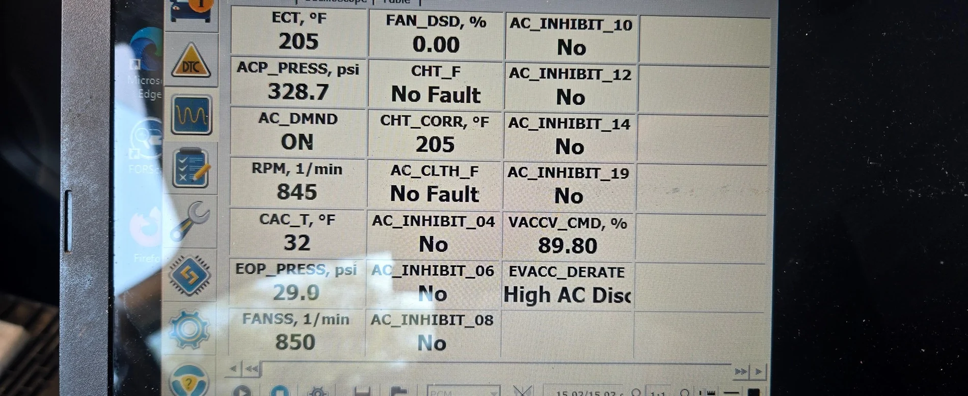

At idle fan speed at max.. this is my high pressure if I leave fan speed at medium pressures hover in the low 260's.. (testing with doors closed recycle on)

Ok:
So at (Max Blower Speed) the Evaporator absorbs more heat (Cabin Air) that heat is transferred out to the condenser (where the heat) is removed - and when you have a lower blower speed - less heat is being absorbed by the Evap - so less heat at the condenser.
This explains the - Pressure (Rise & Fall) with blower speed
You do have an important PID - showing
EVACC Derate - High Discharge Pressure - The PCM does not like the high pressure and is - limiting AC Compressor output.
So at this point - its looking like the system is overcharged and the PCM is limiting the compressor output to protect the system.
i think its spiking so quickly its hitting the derate (cutout) before it can command an increase on the Fan Speed Desired
Another possible is a restricted condenser - so far everything is pointing to the ability of the condenser to remove the heat.
So overcharged - flooding the condenser with freon amount it cannot handle
Surface area and internal porting - having difficulty of removing heat from 134
Internal restriction - Too much PAG oil or incorrect PAG Oil used
This is where (specific data) on the charge procedure will help - was it weighed (scale) or blindly until the gauge read full and how much and what type of PAG Oil was induced.
You may try a temperature map of the condenser with the (Therm)

Thank you for this wealth of knowledge.. I'll be taking the truck back to the shop with all this information I know all this will get fixed.. just hate my work schedule only allows me to get it worked on.. on Fridays..
As far as the oil I believe he just pulled the r1234 and did a lengthy vacume using the factory oil.. as for fill method I wouldn't know untill I speak with him tomorrow..

Ok, so if these symptoms were present before the conversion and the condenser has been externally inspected - (no damage-bent fins) on both sides and no debris has accumulated in between the radiator and condenser (ref the pic posted - in a earlier post)
Leads to a diagnostic path of a internally restricted condenser and or a bad pressure sensor that is lying to its actual pressure.
So, manifold gage reading vs PID reading - a (+/- 15 PSI) variance is allowed - so this is more of a elimination test - Is the pressure sensor reporting accurate pressure - if not then its falsely reporting high pressure and forcing the PCM to derate the compressor output.
This test will prove if the pressure sensor is accurate.
The good thing is - per the manual the sensor can be replaced without recovery of the system so its a Schrader valve connection at the tube.
I would verify the sensor is reading accurately before condemning the condenser.
One other thing would be to - perform a bi-directional test of the fan clutch - you are not reporting any overheating issues - but this may be a partial factor in this issue.
I am leaning more on - the condenser or invalid pressure reading from the sensor.
So to summarize - your test so far have shown that the PCM is seeing - High Pressure and derating the output - this is your warm vent output reason.
So it needs T-Shot - is it a pressure reading (false report) or is it an actual issue at the condenser, electrically the sensor is working - but needs verified its accurate.
I now understand the reasoning for the conversion, but I think it needed a bit more T-Shooting before doing it and I am curious what the static pressures are reading - both Low and High after the truck has set overnight - do they stabilize? - (Equal)

One thing I did notice driving around at highway speeds the high pressure drops to 120-160ish via forscan live data
Basically we can narrow it down to.. pressure switch ,condenser compressor, or expansion valve?

So when on highway- what does the temp output produce? And does the PID still show derated?
I feel the issue is at the condenser or the pressure being reported.
since the issue was before the conversion, I am reevaluating the issue and would focus on the condenser/ heat transfer as this produces a change in the pressure- by your drive and blower test

Vent temp even at highway speeds is 55 degrees at best one dot down from max fan speed... no derate message
