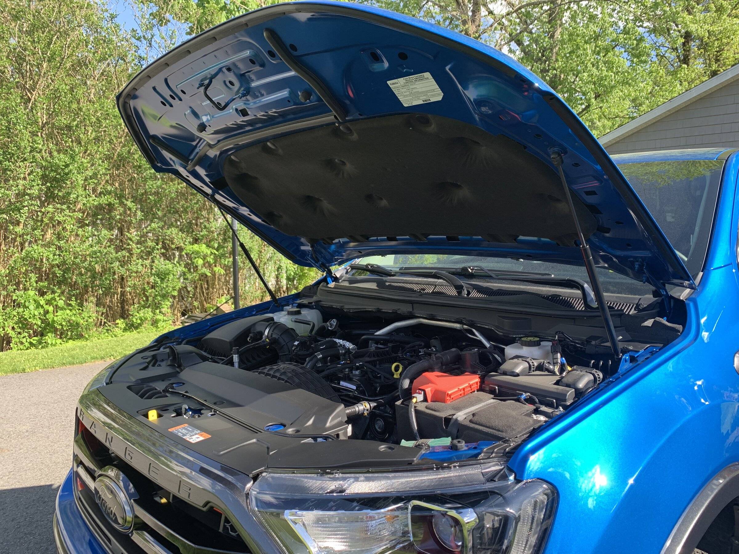

Well. 90 minutes or so to clean all the bug guts off. Less than five to install the struts.
For those looking to add to their truck, the Ford OEM parts come with a dollop of grease in each ball end. So it actually took me longer to go find the right small screwdriver to use to pry under the locking clip than to actually install both struts.
I was able to do the job myself. A helper to hold the hood would not have hurt though. I suggest you attach the hood sides FIRST, as the angle to get at the retainer clip can be a little awkward. (Not bad by any means though). Then remove the prop rod, have your helper hold the hood as you attach the bottom cups.
For those keeping score, the struts hold the hood higher than the prop rod by about 3”.
And for the anti damper crowd, the force required to close the hood should offset any arm muscle loss from the tailgate damper. ?

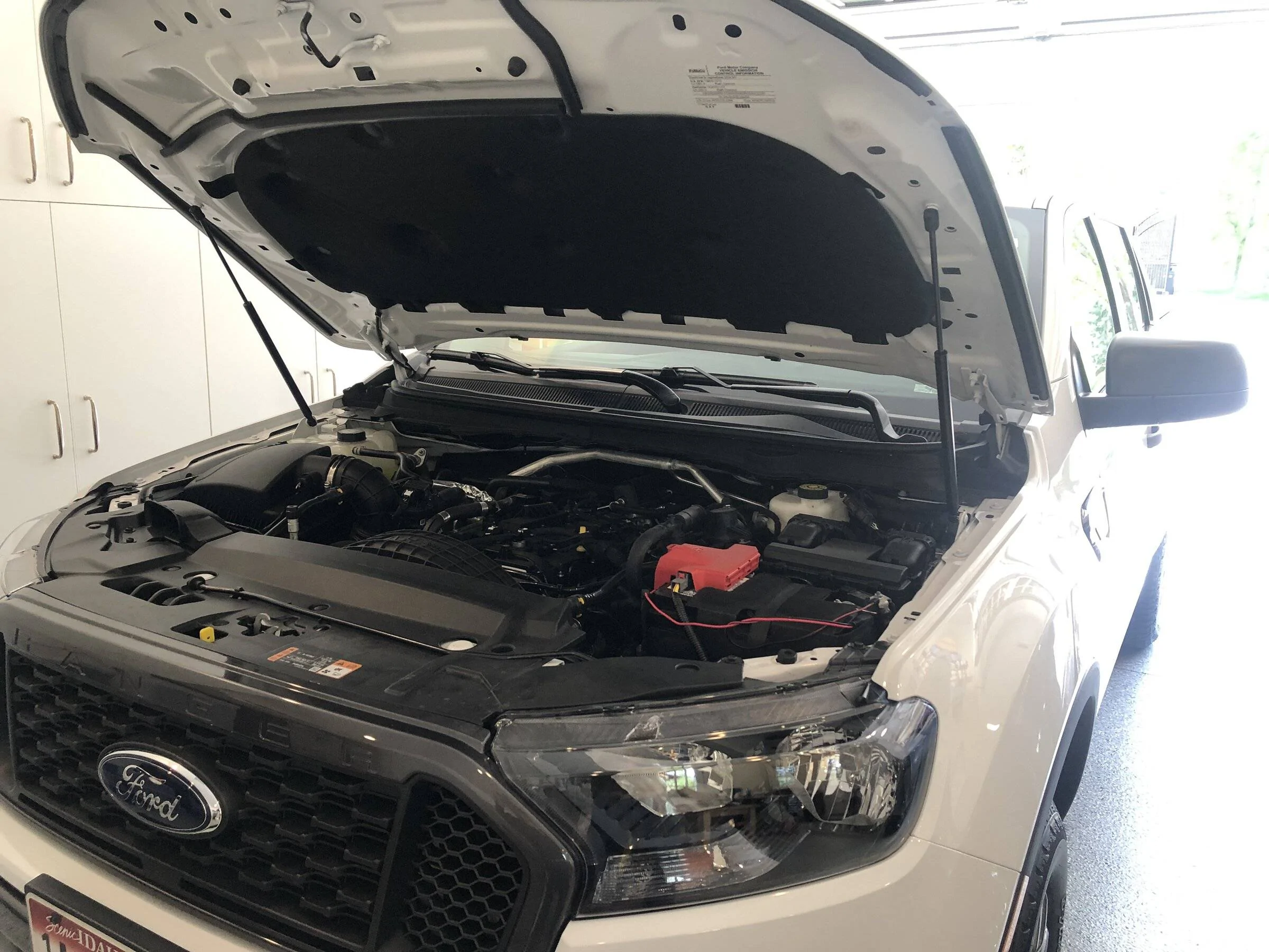

Just to clarify on the install of my two struts under the hood, the struts just snapped into the ball pivots. The jaws are springs, so after you snap it in, the balls are captured, no need to pry the springs up or out of the way.
Yes, you can certainly force the jaws over the balls without pre-spreading them. The ends of the jaws are sharp though, so if you want to avoid scratching up the paint on the ball, spreading them before placing them onto the balls helps.
Not sure how much it'll matter in the long run, but I figured the extra 30 seconds of attention would not hurt.
Not sure "force" would be the way to describe it. I mean, it took a very gentle pressure and they snapped right on. Pretty sure that is the way they would be installed on the assembly line, just sayin'. :)

Looks great. I'm not so butt hurt now seeing that the struts only raise hood 3" higher than my sad prop rod.
