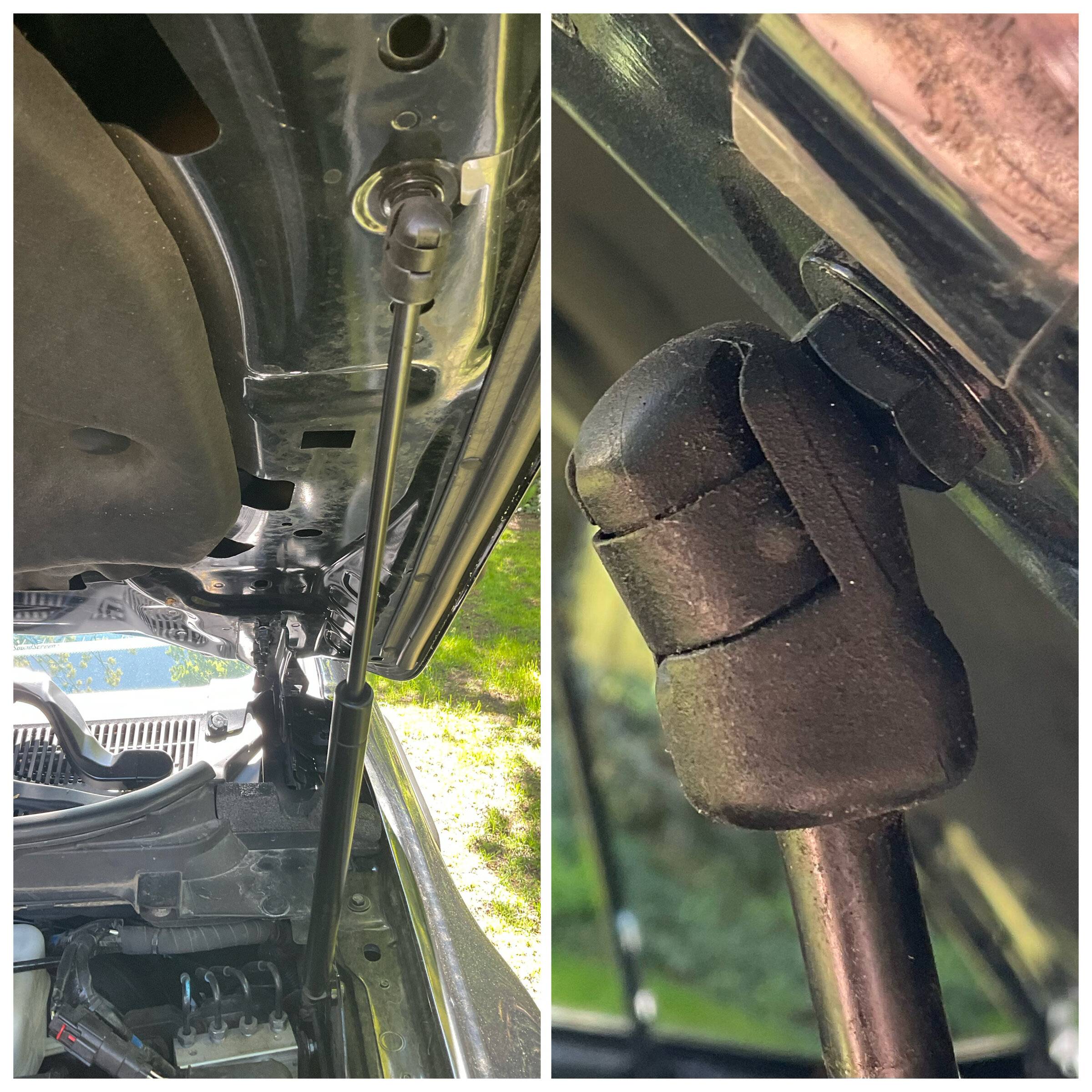

Hey guys, anyone that has the factory hood struts.
I have acquired a pair for my 2022, but wanted to check if there's any installation tidbits that I should consider. (pics of your strut would be greatly appreciate too. :) )
Does the paint need to be removed from the balls, or did Ford leave the paint on and just slap them on?
Guessing the balls need a shot of lithium grease?
Strut body side goes downwards?
Etc.

Grease shouldn't hurt anything, so I'd do it. I don't think removing the paint would be needed. If there's a friction issue, the strut will remove the paint for you :)

No signs of grease
Ford just slaps them on the painted mounts
Body side down
Pardon the dirty engine bay - I’ve been busy. ?

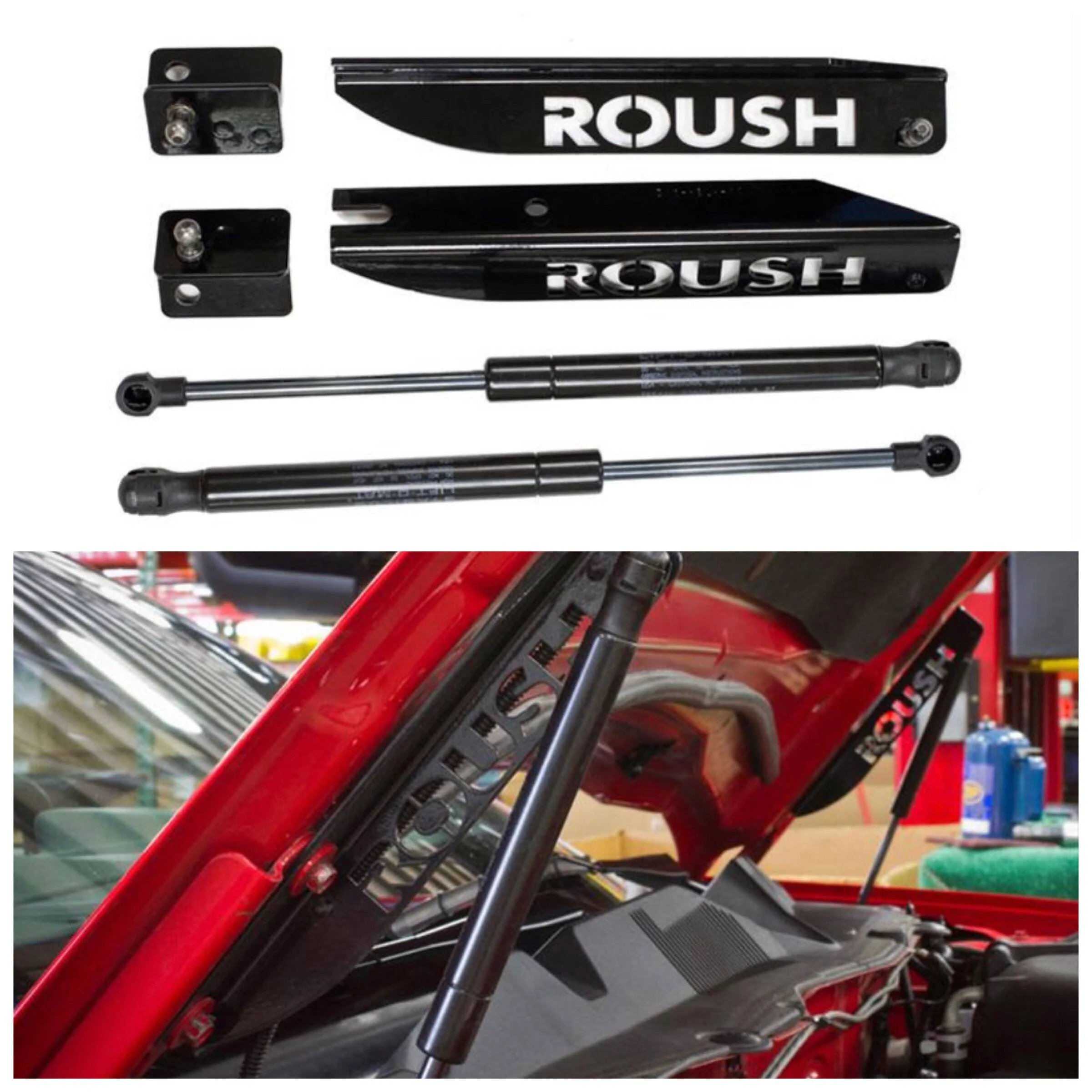

Roush makes these for Mustangs with prop rods - maybe Jack should be thinking about these for the Ranger as well. :idea:
Or, they might be able to be placed in just the right spot. Hmmmmm.
