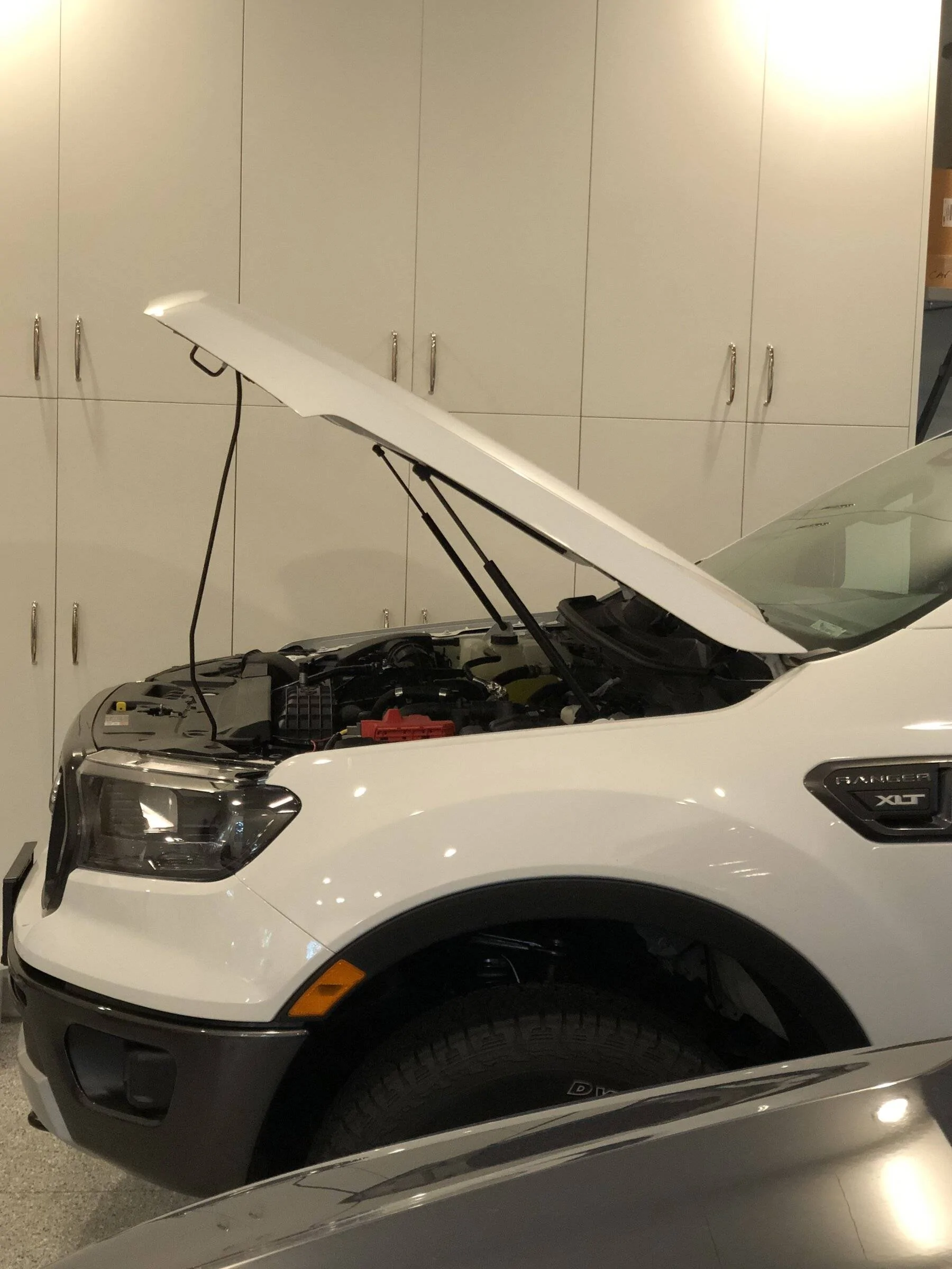

Please help me decide. Do the gas struts make the food higher? My prop rod seems very short to me, the hood will go up another 12 inches easy. I am tall, and want this aluminum baby up out of the way.
deleriumtremor
Bill
Apr 19, 2022
1,200
3,810
Boise ID
2022 Ford Ranger XLT FX4

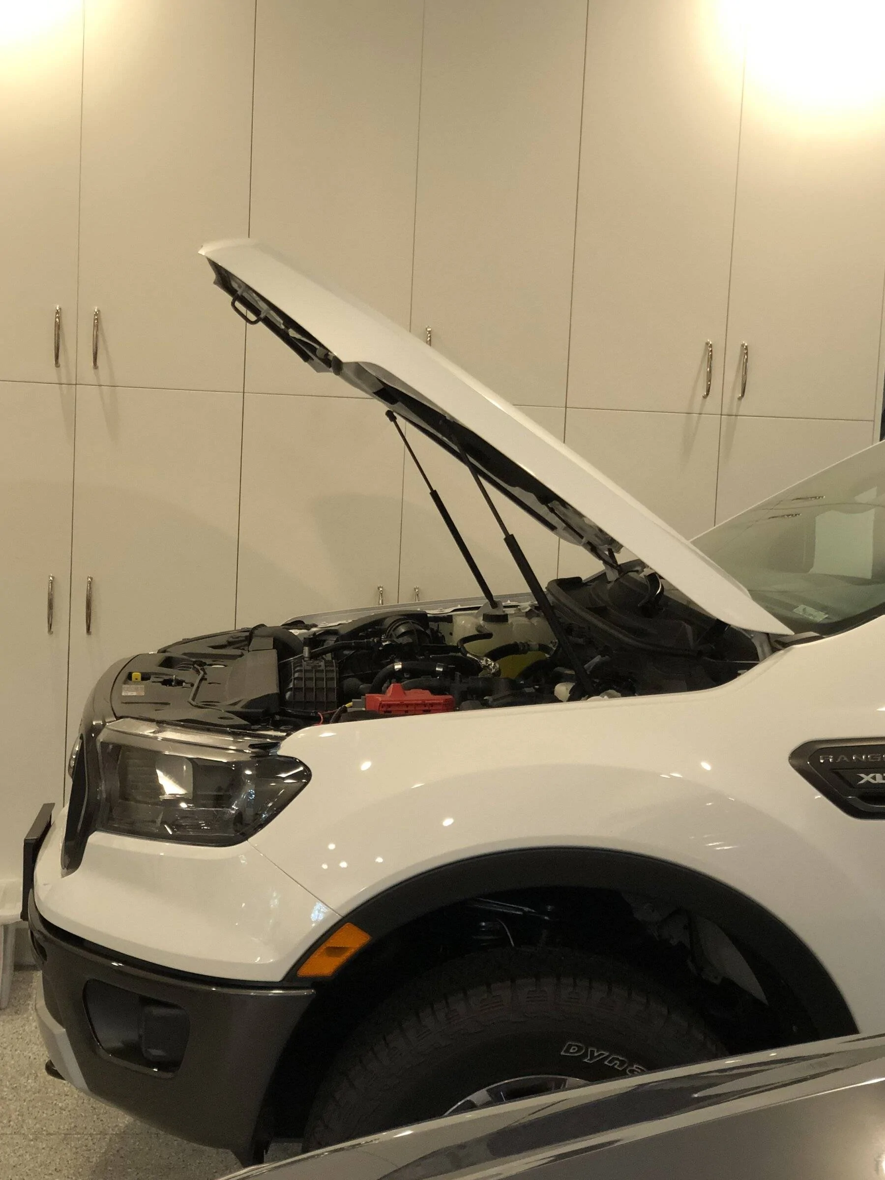

It does make it higher. Measured at the prop rod, to the exact same spot with the struts bringing it all the way up, it is 3.75" higher.
Here are the side pics.
I am glad I did them.

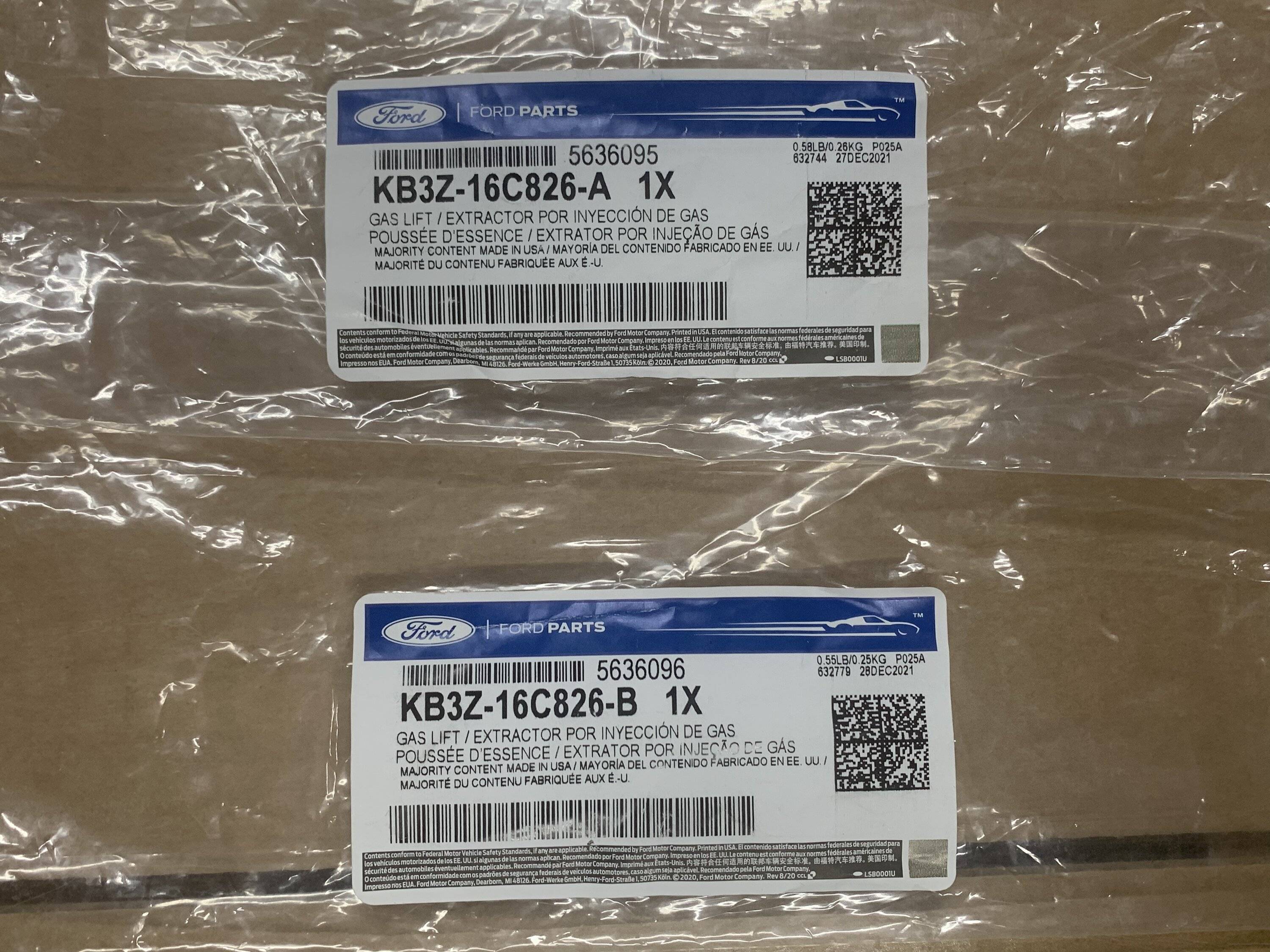

What were the part numbers for the struts you got?
My ranger has the ball mounts already installed. I assume the struts should just click into place. 60$ For factory is easier to justify then 139 from redline. Unless I’ve missed any information on missing parts.
Assuming ball studs are in place on both the underside of hood and brackets near the hinge, yes the two gas struts are all that you need.

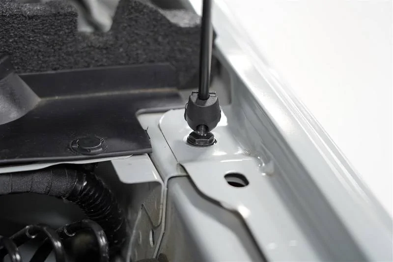

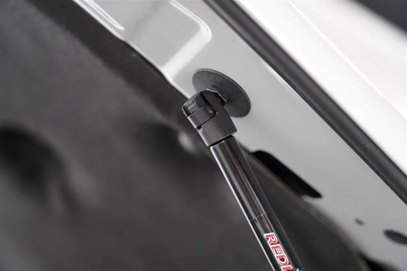

Here are some pictures of the Redline Tuning system from their website showing their mounting for the hood and fender:
Here is a link to their system it's $99.95:
https://www.redlinetuning.com/2021-Ford-Ranger-Hood-QuickLIFT-PLUS-p/21-11043-02.htm
