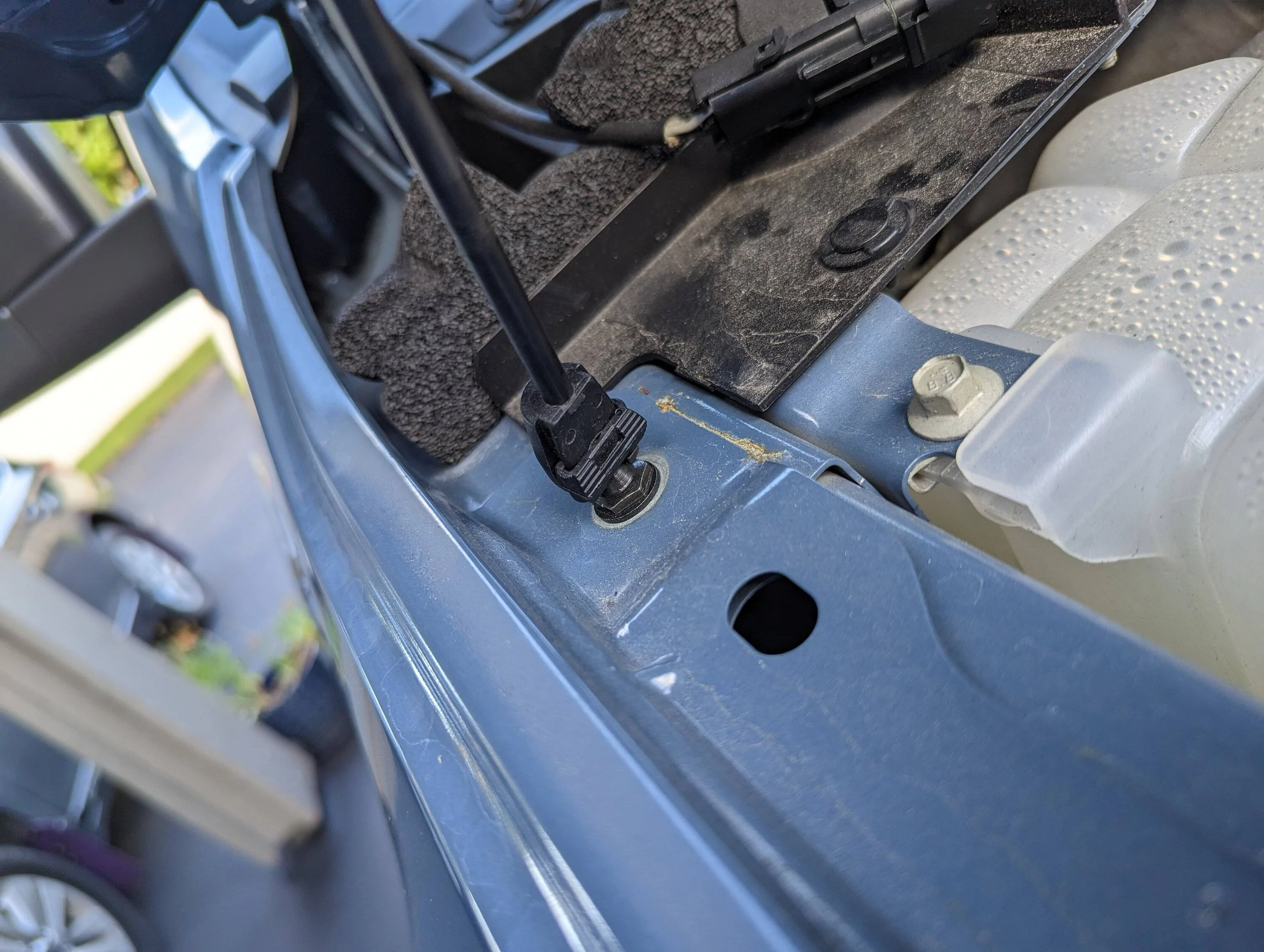

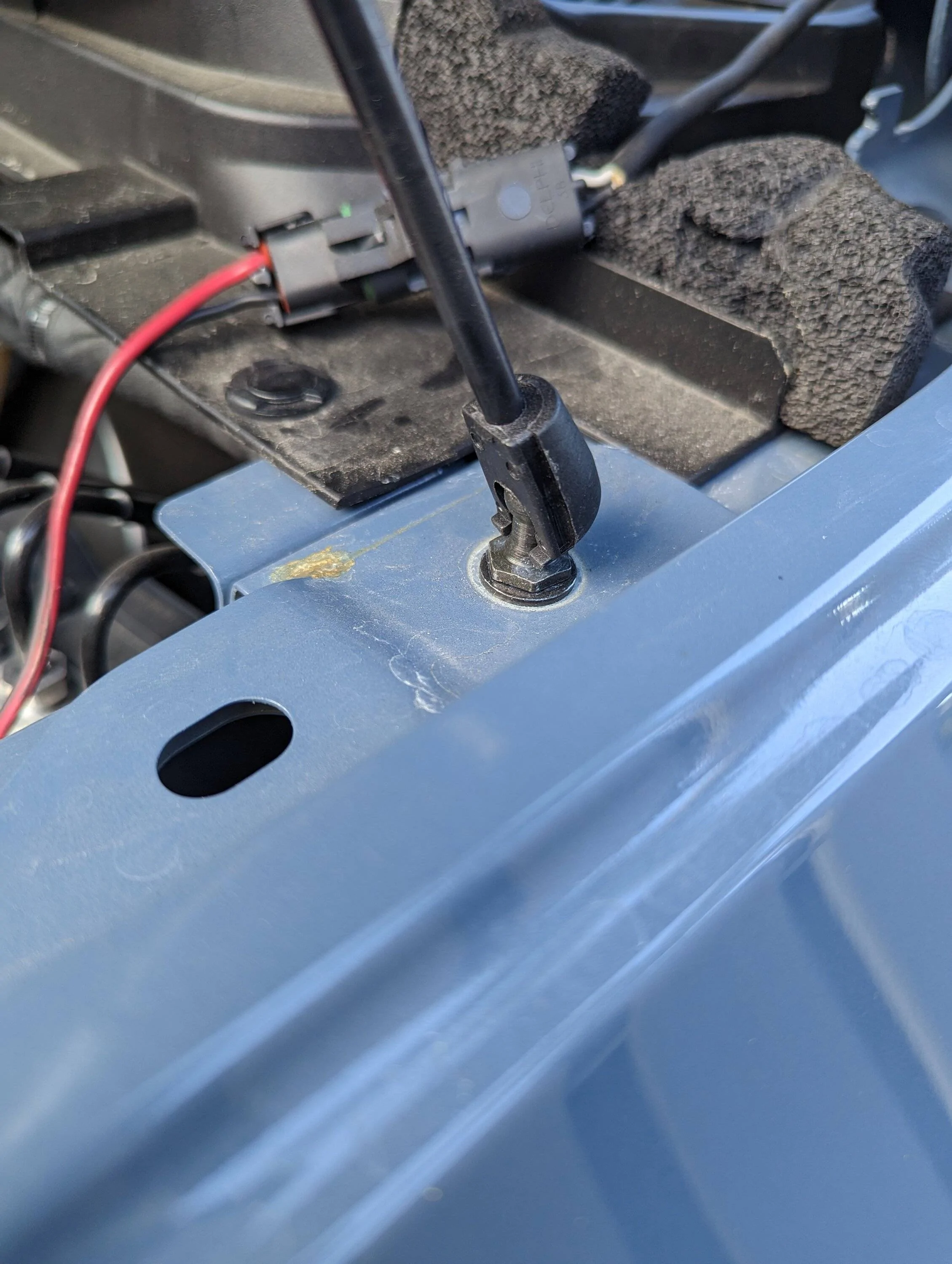

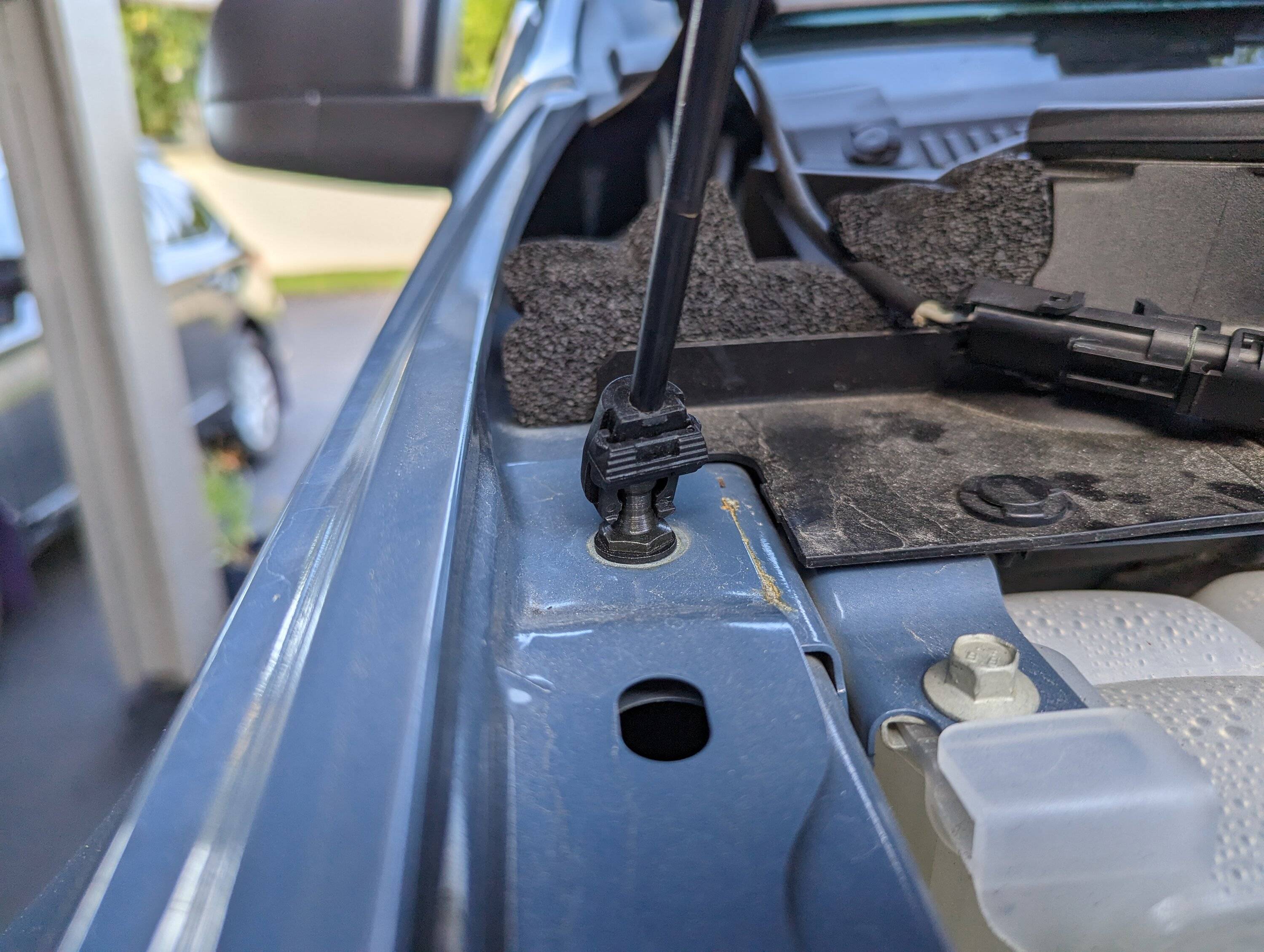

Installed my struts this past week, yesterday I opened the hood and both had popped off the lower ball mounts.
I slid the little plastic piece down on both sides and thought they were locked in... (one side it is completely gone now)
As the pictures show, one side with missing slide lock, one side with it in the up position I found it in when I opened the hood, and the final picture is where I have the slide lock.
Anyone else have issues with the slide lock not staying locked? I emailed redline tuning, but it's a holiday weekend everywhere.
Also, I'm glad I left the prop rod in place...

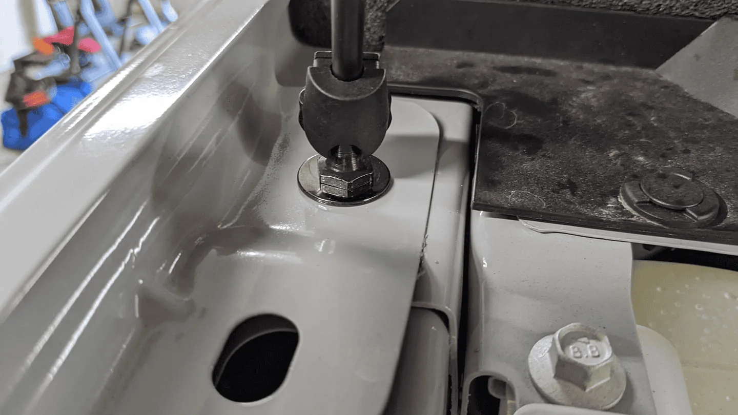

Also, around the lower ball mount the metal is not body color painted - do we think Ford at least put some protection on the metal or is it "bare metal" now exposed to the atmosphere?
I'm going to stop now before I go on a rant about the piss poor paint job they did on this truck for a paint color that costs extra...

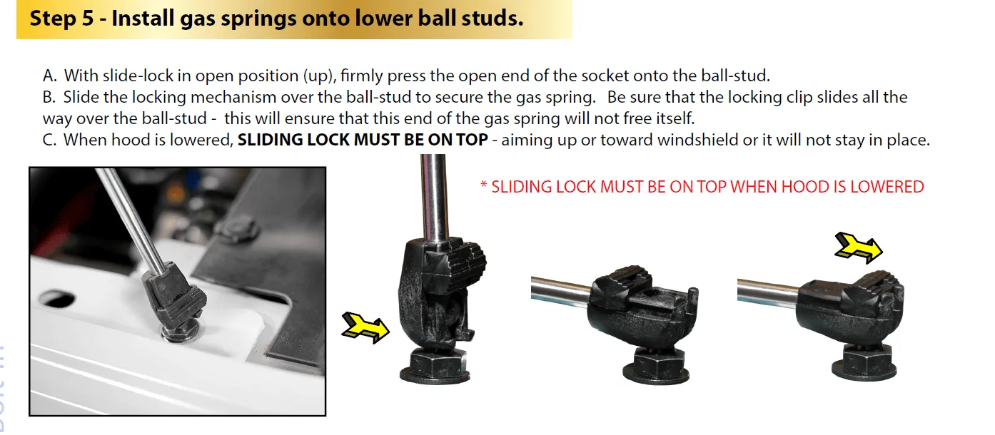

Take another look at step 5 on the install and compare it to your posted pic, you missed a important note on the install.
Some have replaced the body washer that comes with the Redlines with a Home Depot Body / Fender washer the same size as the original factory washer that was removed to cover the bare metal.
The Redlines come with a smaller diameter washer.
When I emailed redline I knew it was probably something silly. It doesn't seem intuitive to me lol
Shrug
Guess I'll be buying a new end for the strut. ?
I used my Cactus Gray touch up paint and took care of it. I had asked Redline about providing a larger washer when they did the initial install on my truck but it was the largest diameter one they had in their selection.
I tried to locate it, I thinks its buried in the What did you do to your Ranger, thread
Edit: Found it
Amazon has the Black Painted Washers
Amazon.com: Hard-to-Find Fastener 014973436551 Fender Washers, 1/4 x 7/8, Piece-8 : Industrial & Scientific
They are actually nicer than the advertised black paint. I am pretty disappointed, as a car guy, that Redline included the washer they did. It was either cost savings or a newb.
