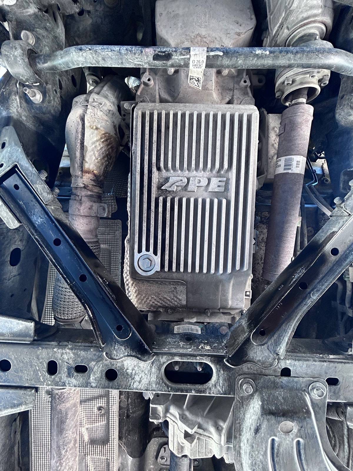

Went back to the original shop that replaced the transmission pan. They admitted to overfilling and drained the pan to the proper level. They also noticed that there was a hole in my exhaust that was blowing directly onto the transmission, causing it to heat up. They fixed that aswell for free. I got super lucky, now everything works as it should.
Got home and cleaned up the bent crossmembers, put some spray paint on and everything looks as it should. I won’t be going back to that dealership though. Lol

I’m glad you got it solved. Now, you knew someone was going to ask, so here goes…
Was the “hole” in your exhaust the outlet for your QTP exhaust cut out?
No there was a hole in the area where the resonator connects to the downpipe. No idea why.
Exhaust cutout is behind all that ????
