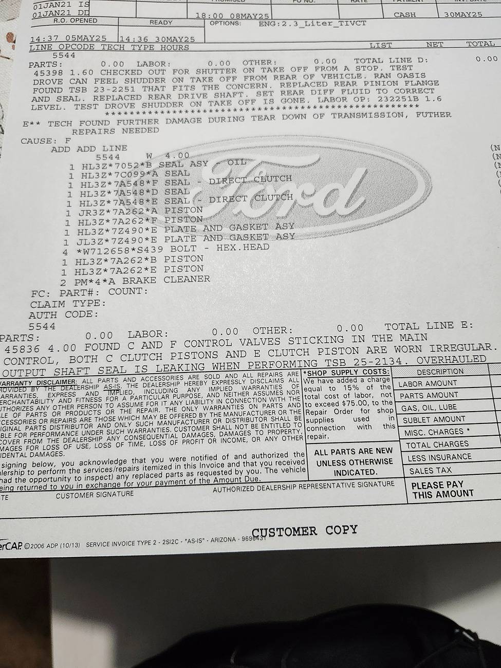

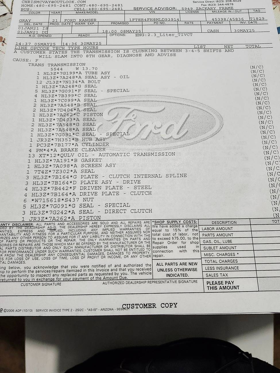

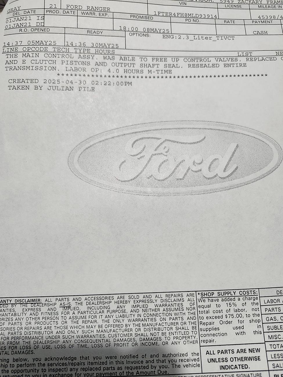

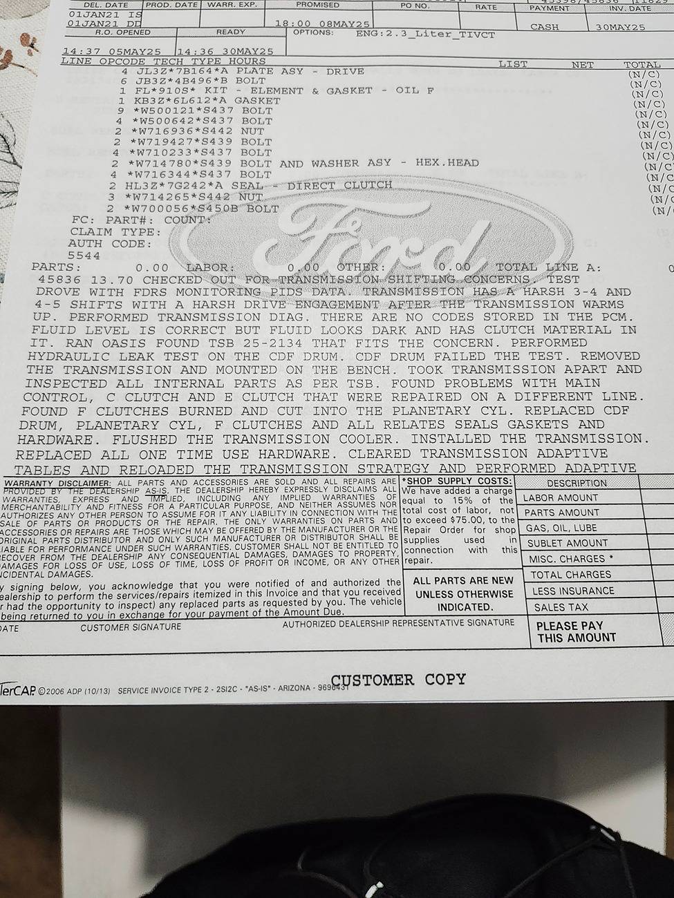

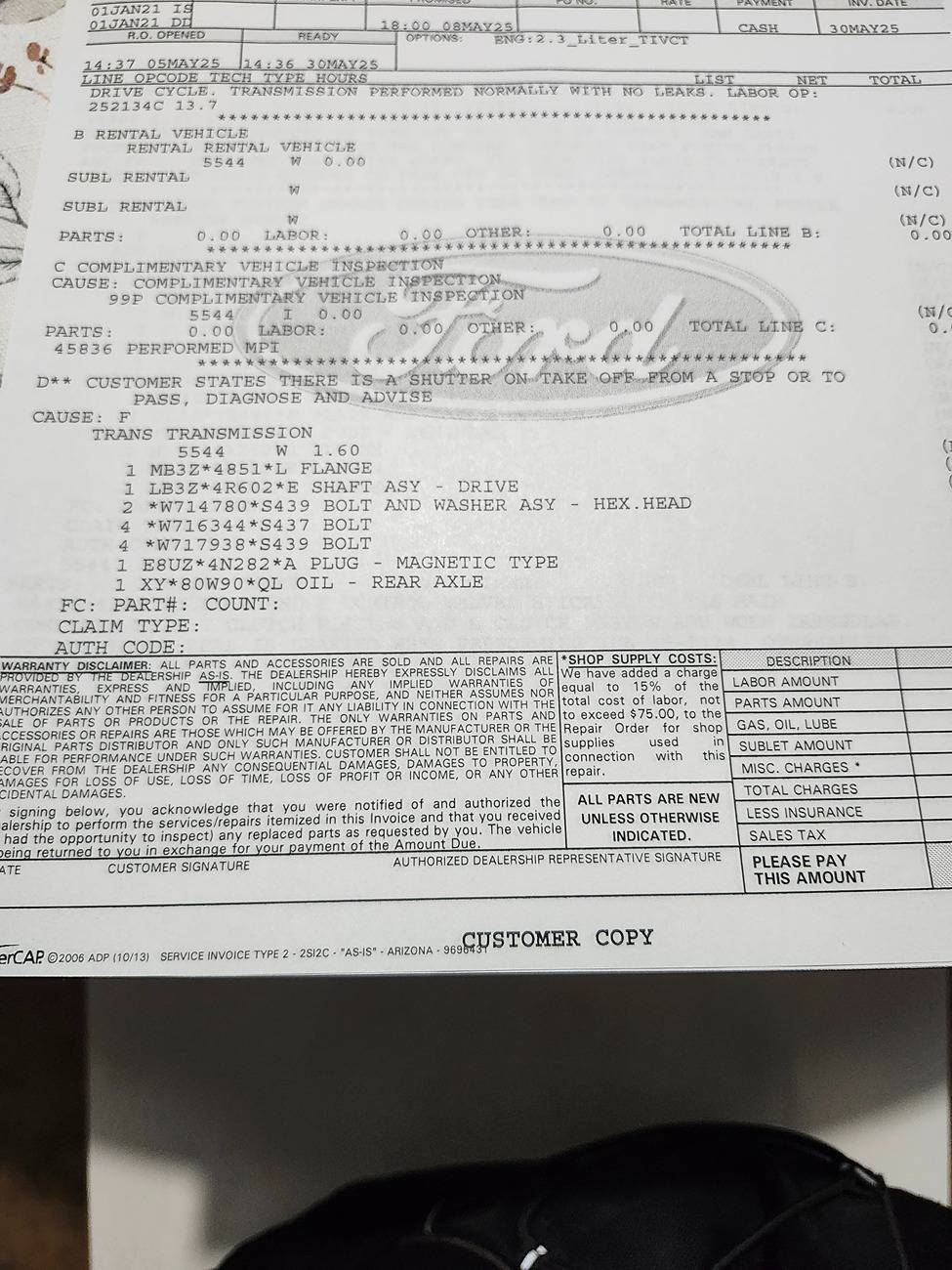

Update:
Got Truck back last night.
The service writer told me to expect some somewhat harsh shifts still while the transmission re-learns what it's supposed to be doing. He was right, but it's not at all as bad as I had expected, and feels much "tighter(?)" than it did when I took it in. I think I'm gonna like it...I WANT to like it...but am gonna try to keep an open mind.
The only thing this cost me was the gas I had to put in the loaner F150 (about $14). What a blessing!
Below are all 5 sheets of my repair paperwork so you knowledgeable guys can see what happened and maybe help me make sense of it.

So three things that stand out (good things). Updated CDF drum
Updated Outer shell ( trash can)
Overhauled valve body
You should be in great shape

I looked at Chris's initial post and then his repair report. He noticed the odd shifts and thought he might as well get it checked out. There was severe damage to key areas of his transmission. 4 of the 7 mentioned defects (shortcuts) that Ford took as outlined by the NextGen Engineering folks were listed as replaced.
- Problem #1 - The Torque Converter
- Problem #2 - The Valve Body (not mentioned as replaced, but it caused the failures in 4, 6 ,& 7)
- Problem #3 - The Oil Pump
- Problem #4 - The "E" Clutch Assembly
- Problem #5 - The Oil Pan
- Problem #6 - The "B" Clutch Assembly
- Problem #7 - The C-D-F Drum Assembly
