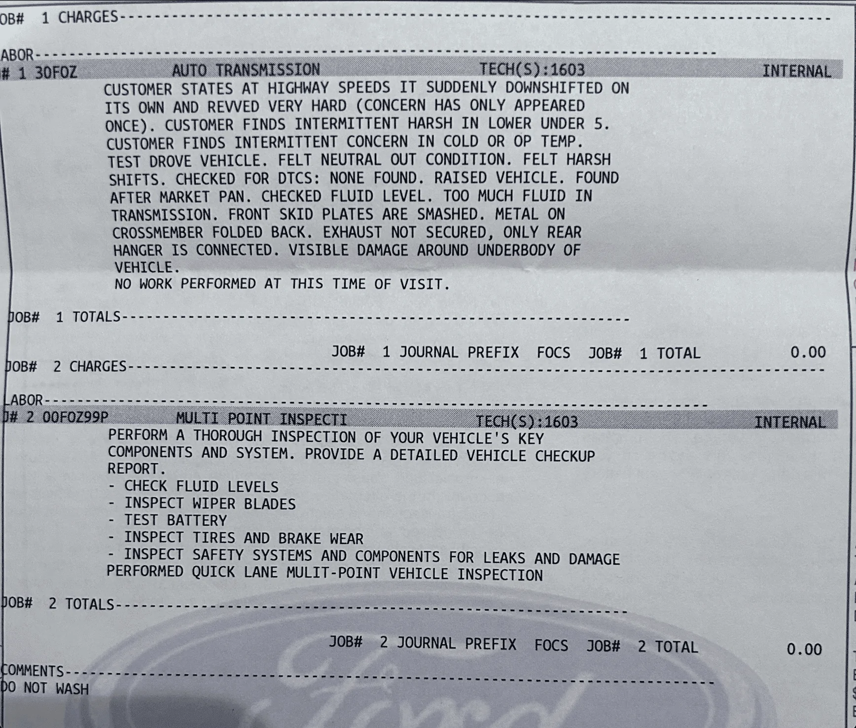

Well, I took the truck back from Ford today as they weren't going to do anything. The service manager felt 'uncomfortable' with the situation because of the damage to crossmembers and skid plate. Imo, this should have pretty much zero correlation to any sort of transmission malfunction. (Exhaust not being secured is my own dealio, lol, I was 'testing sounds.')
Any suggestions on where to go from here and who to contact? This service department refuses to do anything. Who do I need to get involved for anything to happen?
Here's the service sheet:

Seems you should speak to the shop that changed the pan and overfilled the trans. Have you tried draining the fluid down to the proper level and testing the trans operation?

Why was the oem pan replaced?
Slammed on a rock, that's why all the crossmembers are bent aswell. I figured I would upgrade to a PPE metal pan and save myself the possible trouble in the future. Looks like that backfired on me though. :brokenheart:
Dropped it off there today and spoke to the shop owner. He said he would check fluid levels, but swears it was filled up to the correct amount... either way everything is on the house.

I can see where the dealer is possibly coming from in not wanting to warranty it. The OEM pan was damaged in an “accident “ ( not a warrantable failure). Repair was done at a non authorized Ford shop and was overfilled. The dealer has no way of telling if the transmission was damaged in the “accident “ and what the repair shops replacing of the pan and overfilling did to the transmission ( not a warrantable failure). It would be different if you had the dealer swap the pans as a precautionary step prior to any “accident “ damage “. Sounds like the repair shop is the source of all your issues not Ford warranty. Just my opinion and probably not what you want to hear. Hopefully the repair shop steps up for you.
