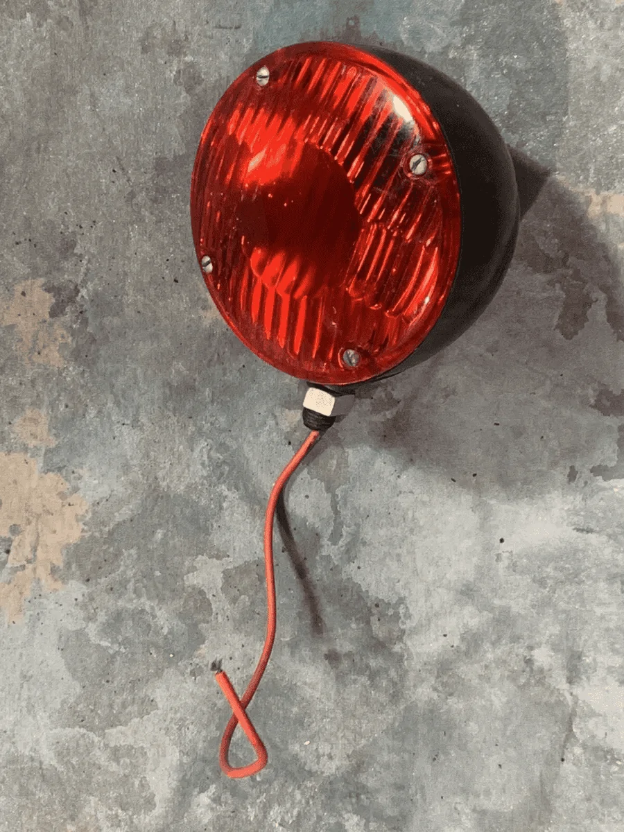

$200 won't even buy you a non-BLIS, halogen Ranger taillight!
Speaking of, after I ripped off both FJ40 taillights in the late '70s, I replaced them with $5 tractor lights that still work today!
