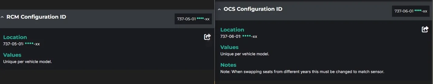

I am not 100% certain on this but I think the software version PN may drive what data lines are available to configure.
I know that my 2022 with my module configuration run:
Shows the following:
RCM PN: KB3T-14B321-BD - Software Version: GN15-14C028-CA
All of my As-Built compares do not show 737-05-01 or 737-06-01 in any of the database runs.
If we reference the As-Built Database files (All Fords)
here is what those 2 lines breakdown into:
Being that the Ranger does not use those lines, then if it is listing them I am not 100% if if really matters for those lines.
The most important I guess would be to ensure that they read like this:
0000-xx
so write (zero) 0000 and then write it, it may give a pop up message about check-sum and then write it - the check sum should be auto populated with the correct check-sum for the line.
To point out what the check-sum is:
Its the last (2) hex data of every line, and generally when you write a line (if you leave the last 2 characters alone) they will auto populate the correct (Check-Sum)
Note: this goes for all As-Built Lines such as 1234-ABCD-12xx (xx) = the check sum
I am not sure, I do not remember if Forscan will display the Module SW Number or not, I think it does in the module run.
I know when I played with FDRS last year there were no updates to the software of the RCM.
So I am not 100% but I think the extra lines are due to the module being somewhat universal and another model may require those lines of data and if it follows the rest of the As-Built files then all (0's) on the line equals a non configurable or non optioned line of data.
