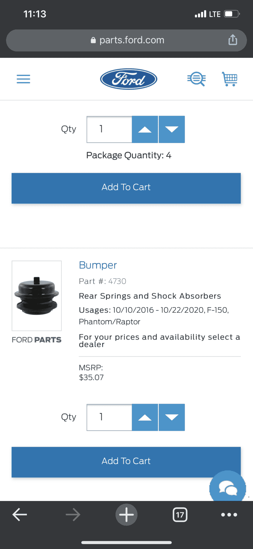

Hey wilsoN_ I am unable to get this link to work, whats that 2nd gen Raptor bump stop number? I could use a couple of those, thanks!

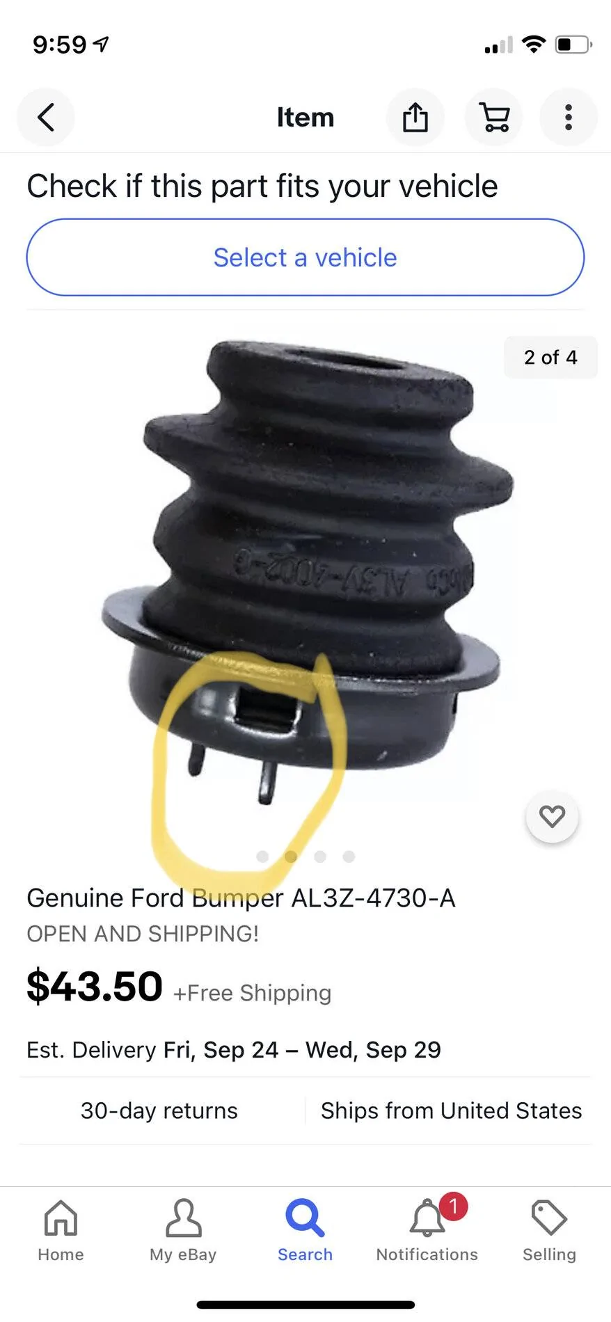

I’m not sure why it won’t let me link it, anyway here’s a screenshot of it. You will have to trim the tab on the back that located in the raptor frame to keep it from “spinning” I used the factory bolt.
gryder
Garrett
Feb 1, 2021
131
152
2019 Ford Ranger Fx4
Are you talking about these tabs in the picture below?

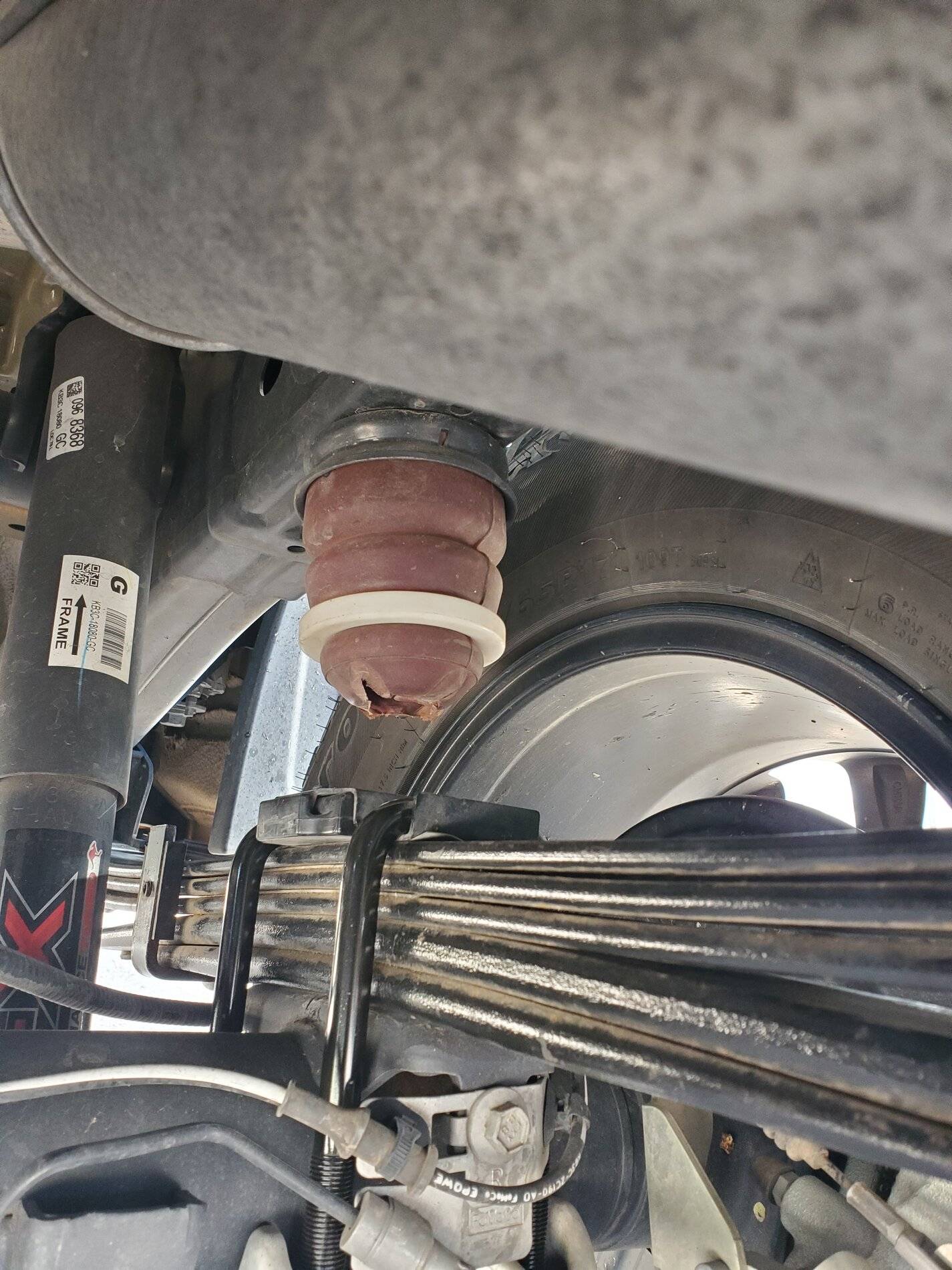

Here is a shot showing the distance of the factory bump stops with the global leaf pack.
And it has a little rake to its stance again.
