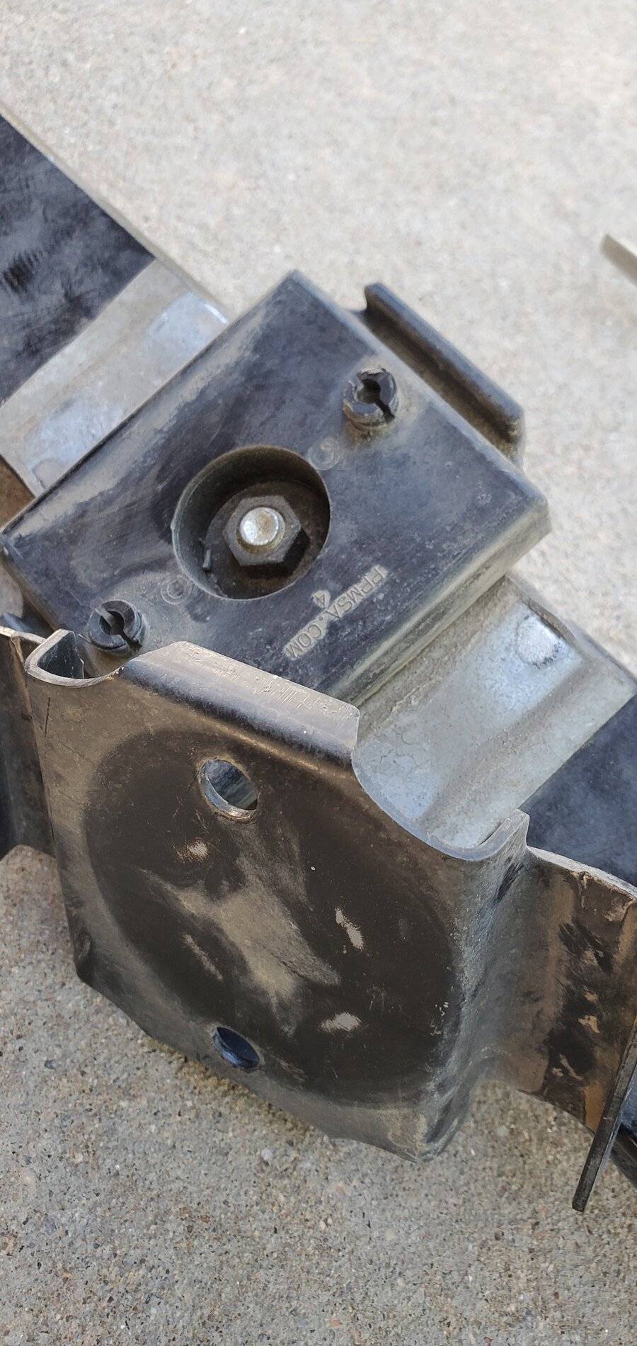

Ok. Stupid question.
Do I need to move the ubolt cradle from the stock springs onto the UK spring pack?
This thing:
@Pinepig
This thing:
@Pinepig
As far as my brother-in-law and I figured, nope.

C02Ranger, I installed them on mine. Figured it keeps the u-bolt in place. Some say it’s not needed after torquing down the bolts but its a factory part so why not use it. Also that’s the bump stop contact pad.
I gave it a shot, couldn't get the nut back on with them on. ?
I'll see how it does. I'll keep the pieces just in case.
Thanks for the replies!
