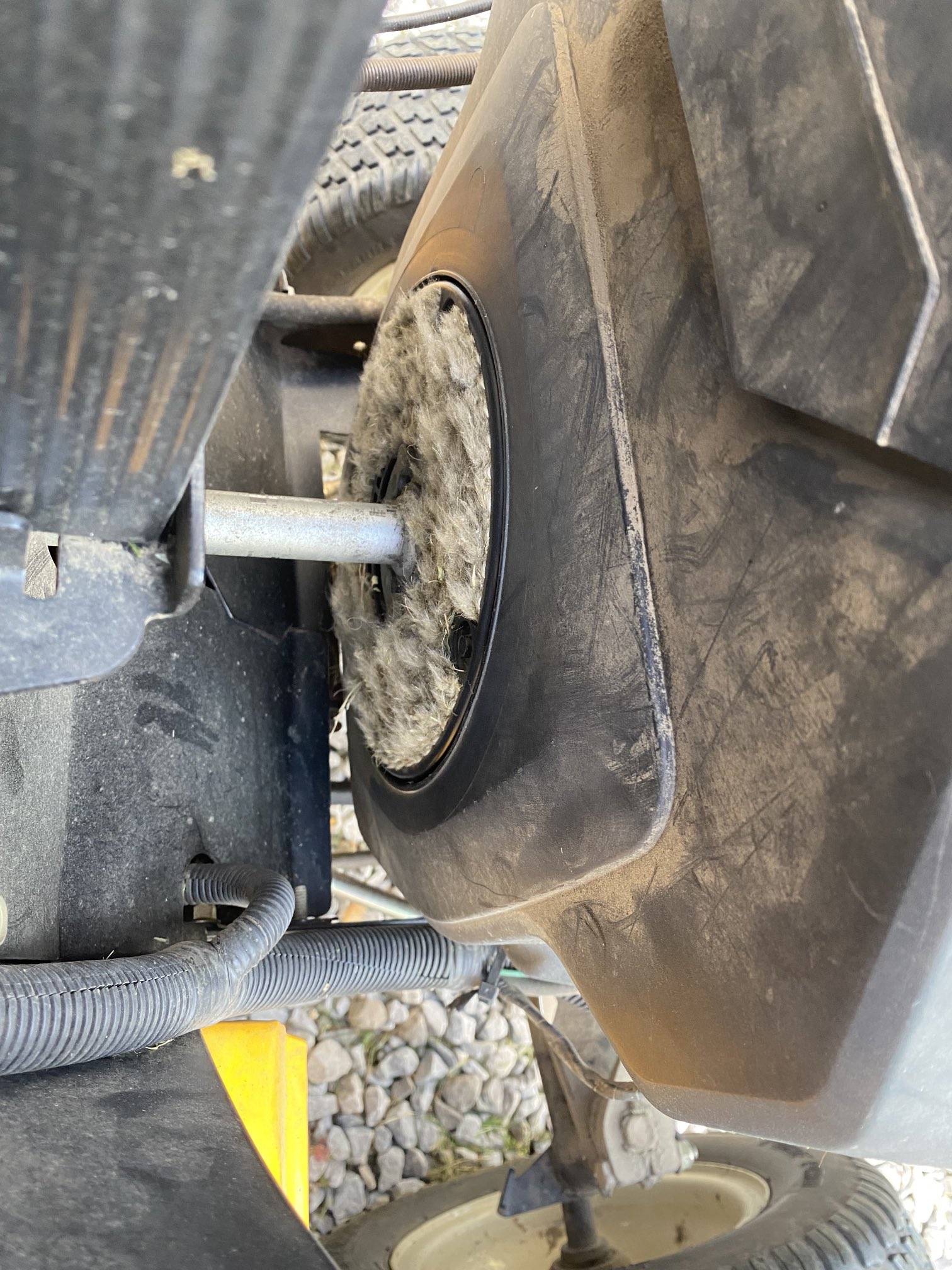

I noticed my mower seemed really hot for a cool day while cutting the grass recently. I always open the hood an blow all the clippings off the engine an deck before putting it back in the garage. I opened the hood an the screen that covers the flywheel area was totally clogged with what looks like cotton wood. I have three mowers that have this feature to suck air into the motor to cool it. It's been really dry lately so clipping are dry too. Today I stopped halfway through cutting the grass an the same thing was happening. Guess I have to clean the screen at the halfway point for now.

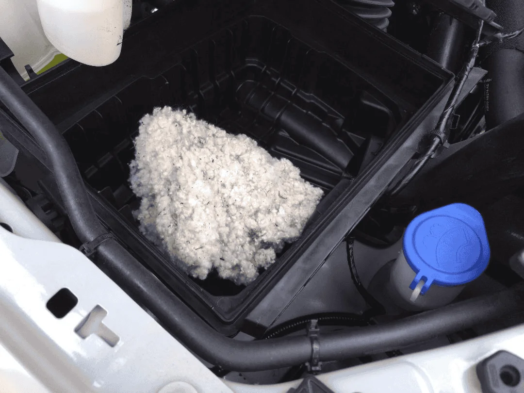

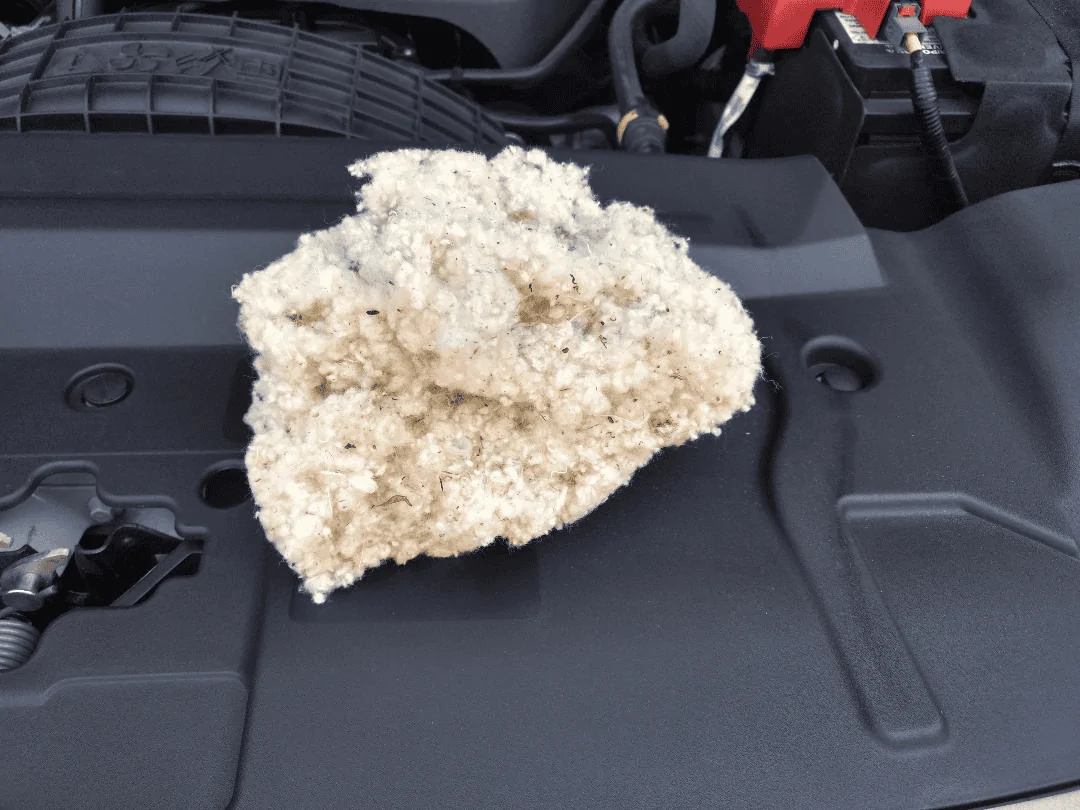

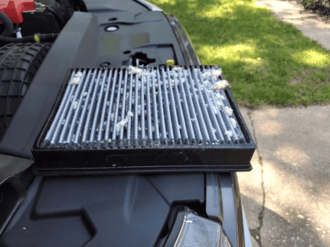

removed the air filter today for cleaning and was greeted with this. ??? seems really cottony, so only thing i can come up with as a cause is there has been alot of the cottonlike crap falling from the cottonwood trees in the area. or do i have a varmint problem? any ideas?
WAS THE TRUCK NOT USED FOR A FEW WEEKS OR A MONTH MAYBE?
