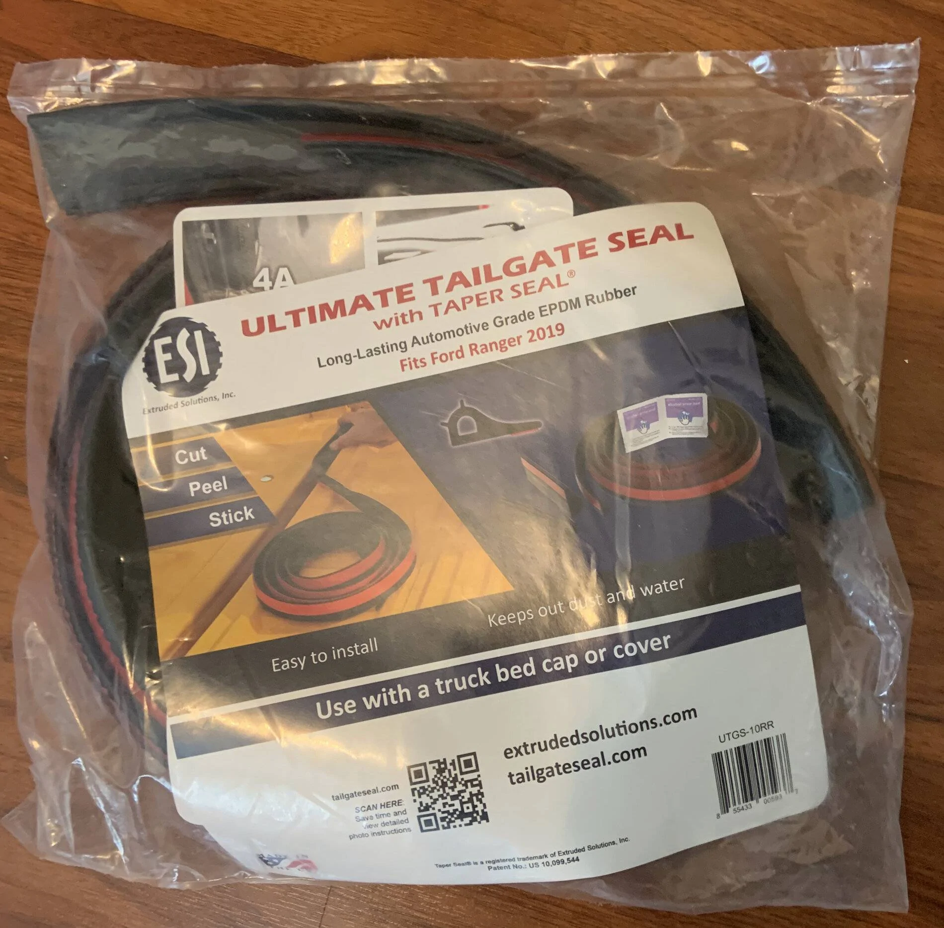

It's been a few weeks since some of the postings:
How do you folks like the ESI Ultimate Tailgate Seal with Taper Seal Compatible with Ford Ranger 2019 and Newer?
And did you add the gap cover recommended by ESI for our Rangers: ESI ROK Block XL Tailgate Gap Cover 7" / 17.78cm Width - Fits All Pickups Worldwide?
I did the ESI seal and spent a good long time getting it on the way they want, but somewhere I either messed it up or it just flat out can't manage to get our tailgates relatively sealed. I still get so much dust ingress around/through the seals that it didn't make any difference. I'm tempted to get another kit and try again, but there has to be a better solution.

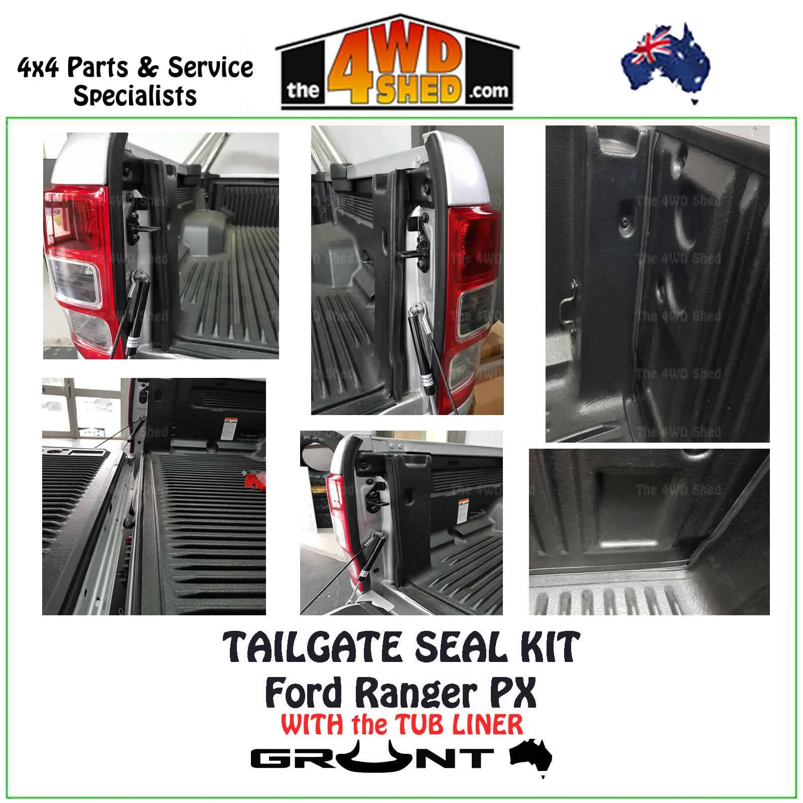

Found this in my search for a tailgate seal.
https://www.the4wdshed.com/tailgate-seal-kit-ford-ranger-px1-px2-with-tub-lin
Not in the USA but the pictures help. Also notice the struts are installed.
There have been more than one of us reaching out to the Aussies for inquiry’s about these. Not one of us has heard anything back. That’s over the last 6 months. Who knows, it just might be your day! From what I have seen they’re pretty pricey though

Is this the product or is that a special Taper Seal kit for the Ranger?
https://www.amazon.ca/Ultimate-Tailgate-Seal-Taper-Seal®/dp/B00IPQWXZQ
UPDATE: found it:
https://www.amazon.ca/ESI-Ultimate-Tailgate-Taper-Ranger/dp/B07YF5BL8M
UPDATE: it arrived from Amazon. I installed it. The instructions are good. It is a fussy place to seal up, as others have said. Especially hard getting just the right seal distance on the two vertical sides of the tailgate. That has nothing to do with this seal kit, just the way the truck is made. I ended up with a 1/32" gap on one side. I will add some window seal the way Gil-galad described above if it leaks too much. Haven't tested it yet.
