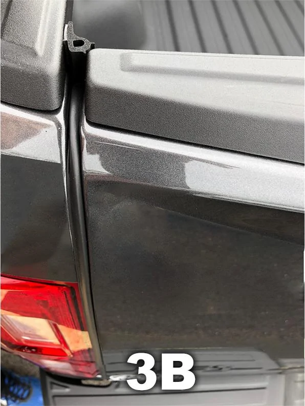

I used the extang seal and followed their instructions. I didn't need to do the bottom since I have a BedRug. One thing I found - don't forget to seal at the top of the tailgate - the little piece along the plastic cap. If you just seal the bed, it will cut down a lot, but that hole at the top allows a lot of dust in.
Edit: Here is a picture of the spot I'm talking about - this is from an install guide for a different seal, but you get the idea - I did it slightly differently, but if you don't make sure that is covered it is a big hole.
