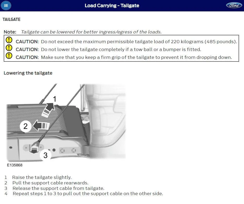

My SWAG (Scientific Wild A*s Guess) is the above stated 485# is a point load dead center on the outer edge of the tailgate. I'm guessing the cable is at least 3/16". Over 4K# breaking strength...X2 cables.
Cable anchor stud pull out or bucking of the tailgate are the likely failure modes.

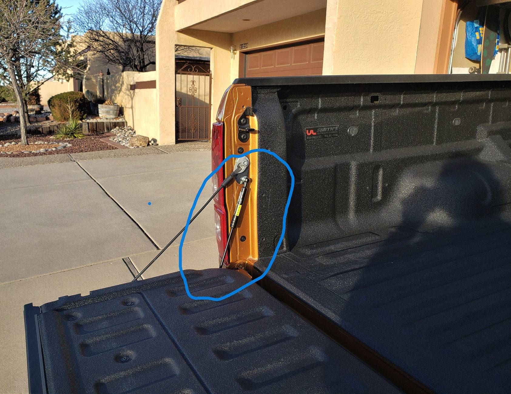

My physics learning opinion is the damper doesn't much of anything to take load. Its too close to the hinge to take any load. ....likely there to keep the tailgate from banging down. If the cables fail these dampers will follow the carnage without blinking.
The only purpose is to slow the descending movement of the tailgate, so you don't sound like an idiot swearing at it when it drops like a rock

How much weight can you add to this with the extra support of an installed Damper? ?
OP...take that tailgate strap and loop it around and over the the latch...do it on both sides and the gate will be held open half way...now the lumber won't sit directly on top of the gate and they won't slide out while driving...
