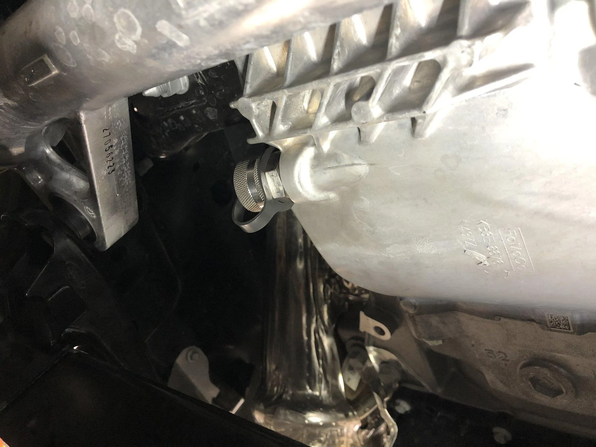

Just did my second oil change yesterday and installed the Valvomax drain plug with aluminum crush washer. I like this valve better than the Fumoto and it is made in the US.
No clearance issues with that huge 24MM nut?

No clearance issues with the valve. Torqued with a socket .

The OD of the Ford OEM drain polug measures 1.041 inches. I used a 15/16 inch socket to install. The flat to flat measurement for the socket is 1.087 inches.
I like this drain plug over the Fumoto in that no adapter is needed which adds another potential leakage point and the Valvomax has a secondary seal with the cap and o-ring. The Fumoto valve does not have a secondary seal which is most likely not an issue.
That looks really clean. You can still use a hose with that right? I found it hard to tell on their website exactly how it works.
I like it! Just ordered one. They have a July 4th Promo where if you put the word FREEDOM at checkout you also get a free 12 pack of disposable funnels. I'll check this out and see how it compares to the Fumoto on my Durango.
