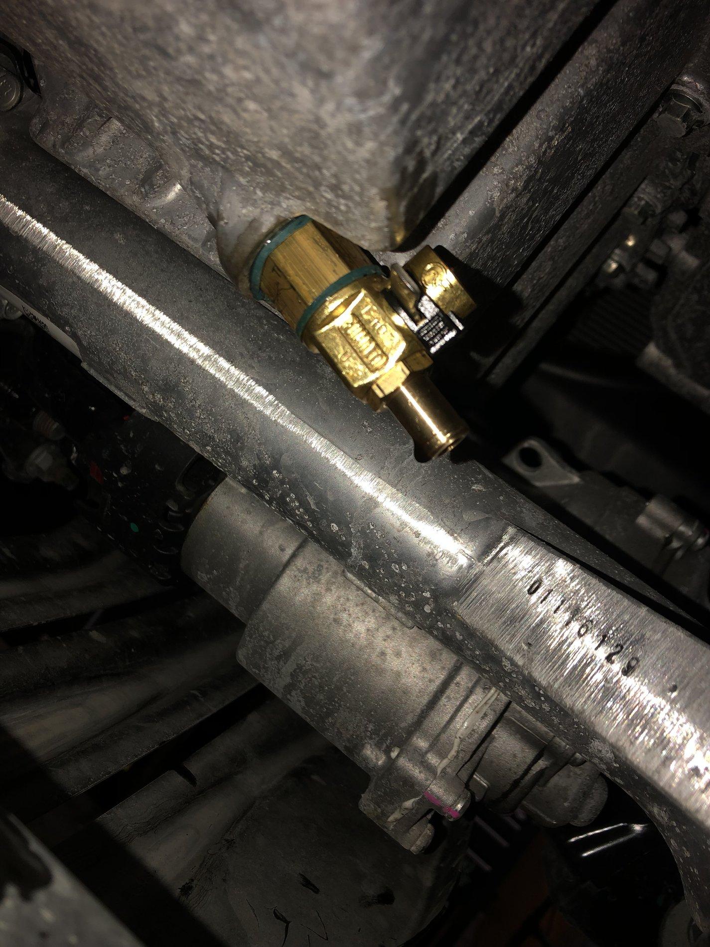

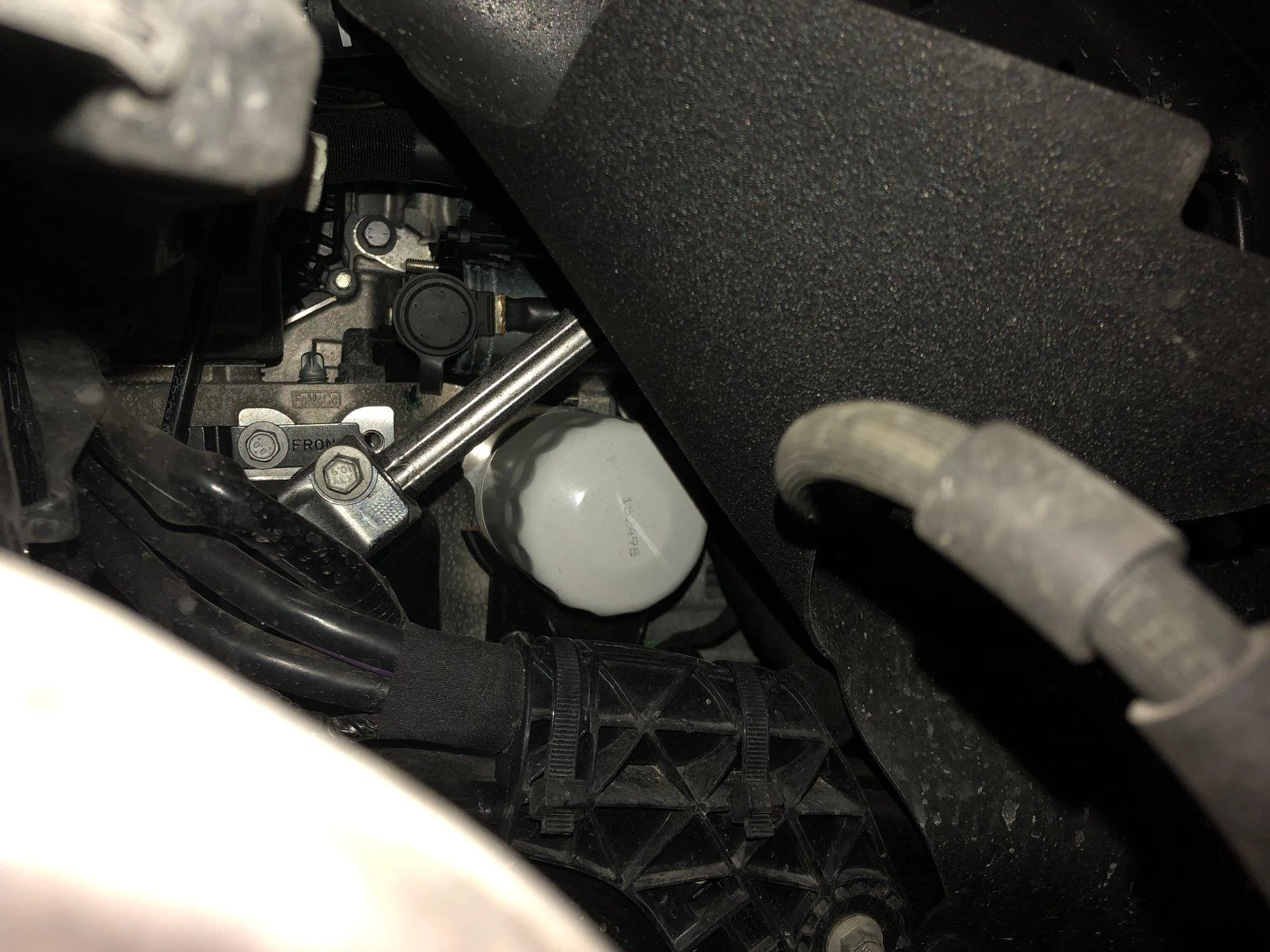

FUMOTO installed. Oil filter easy to get access. I am going to get a 6” piece of hose and just attach it to it and leave it tucked up there.
Just curious - did you do the recommended torque 20 Lbs. foot on the adapter? and the Fumoto recommended additional 1/8 to 1/4 turn on the Fumoto valve when seated on the adapter?

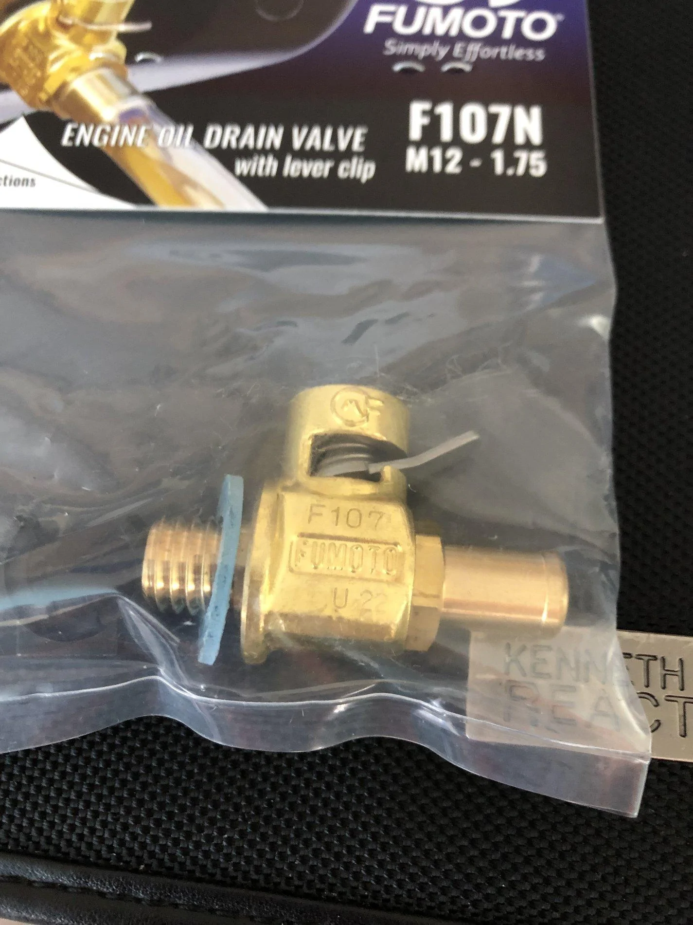

I purchased the extension and the F107N, 2019 Ranger Lariat.
After installing the extension, there wasn't enough clearance to thread the F107N on.
I'd like to have a 45 or 90 adapter.
James (So Florida Ranger), how did you get yours installed?
Has anyone else been able to install the valve and extension?
I was able to but I drive a 2-wheel drive.

Thinking if I add one solid washer to both the extension and the valve, that should give me enough clearance to tighten the valve. Gotta wait til next oil change.
