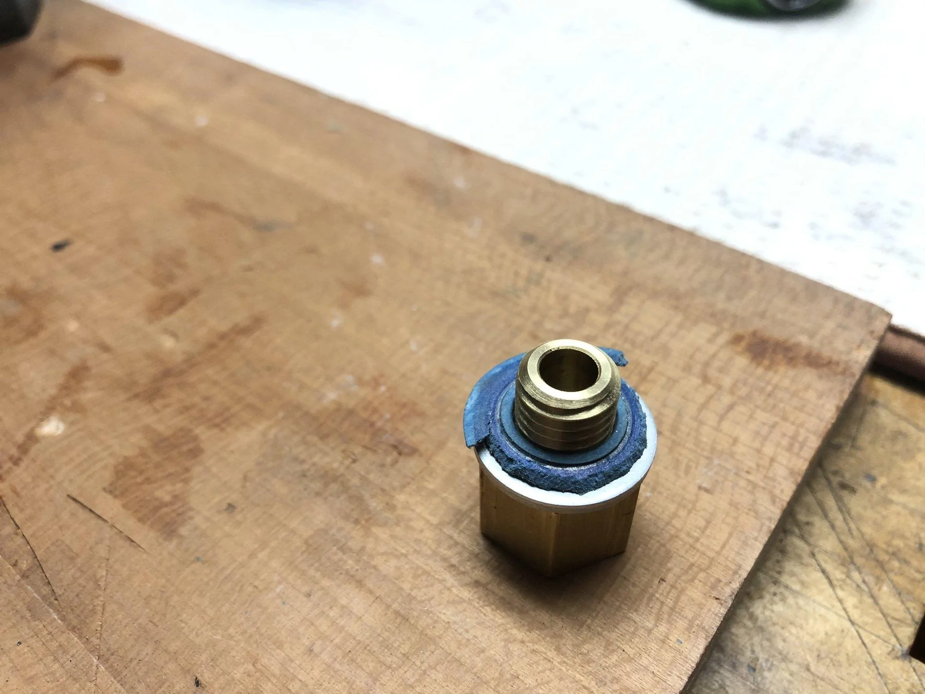

The aluminum washer has an OD of .870 in, ID .484 in and thickness .077 in.
The photo shows the aluminum washer on the adapter with the Fumoto washer nesting on top to illustrate how the aluminum washer would overlay the counterbore. The counterbore depression on the Fumoto washer is @ .630 in so this should be close in dimension to the counterbore in the oil pan.. This washer should work very well. I also have a copper washer with same OD and ID but thickness of 0.48 inch. It should also work very well.
In summary, for installation of the ADP-107 adapter, I would not use the supplied Fumoto washer gasket. An aluminum or copper crush washer appears to be a better solution. The Fumoto washer gasket is fine to use between the adapter and valve body.

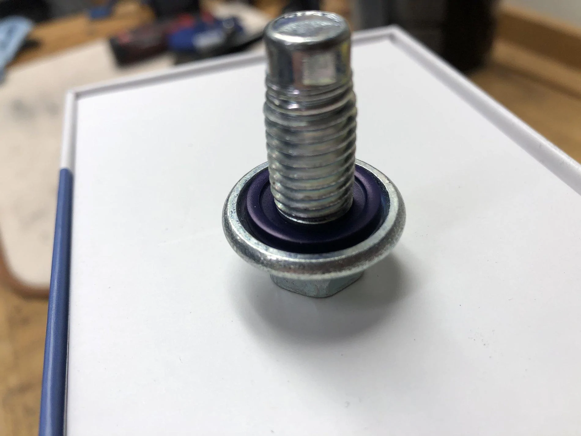

I just did my first oil change on my 2019 Ranger at 4800 miles. I planned to install the Fumoto F107N valve along with the ADP-107 adapter per the Fumoto website. I have used the Fumoto valves on my other vehicles and they have been excellent with no concerns. Note that the other vehicles all used an aluminum crush washer with the OEM drain plug.
The 2019 Ranger OEM drain plug does not use a crush washer but instead an embedded rubber style seal.

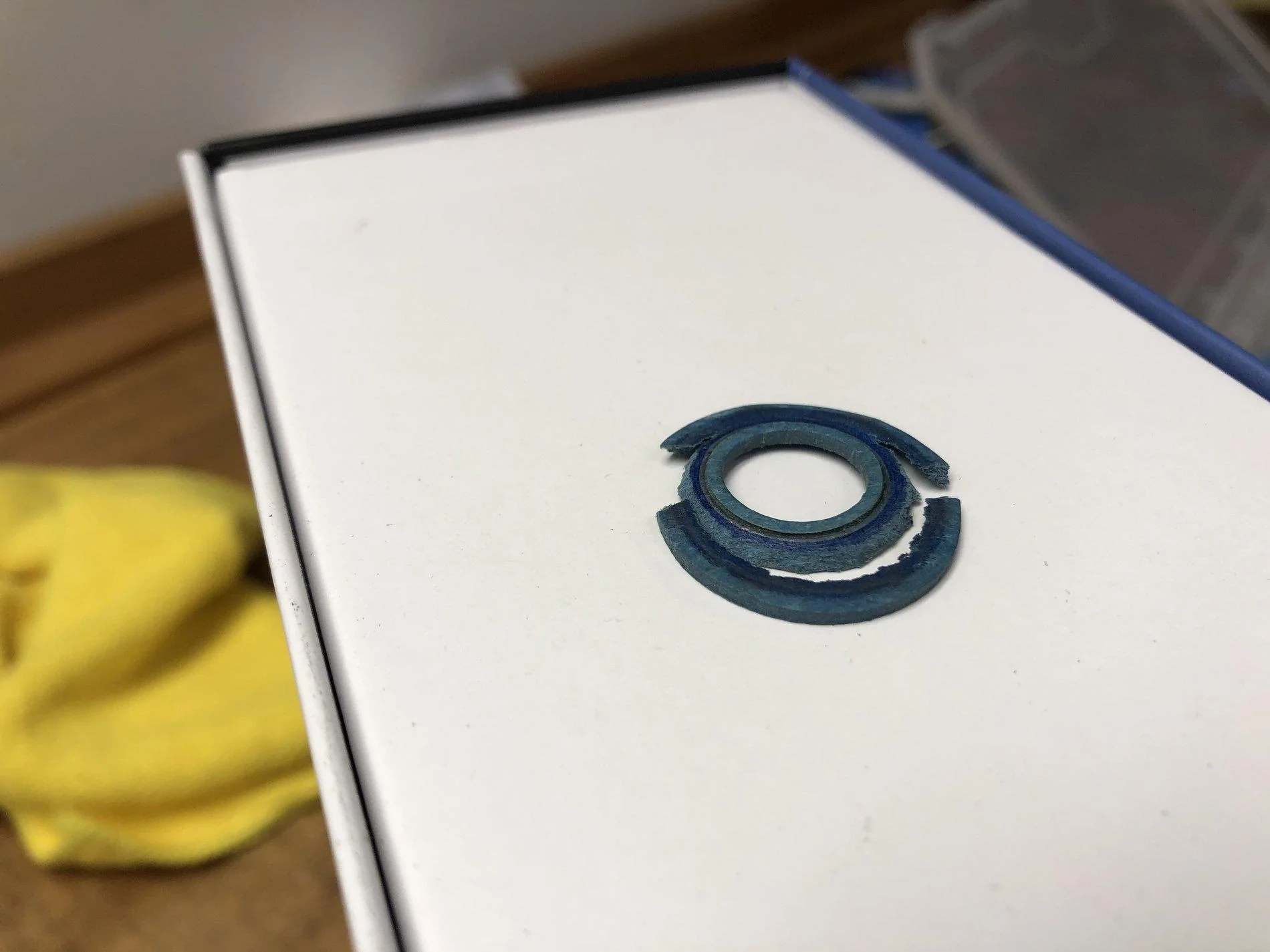

The ADP-107 comes with a a gasket washer made of a composite fibre like material. After draining the oil, on installation of the adapter, it did not seem to torque up as I would expect. I'm doing this on my back with the truck not jacked up. On visual examination of the adapter installation, it appeared that the washer gasket did not look right. On removal of the adapter, I found the gasket washer damaged as shown below.
The inner ID of the gasket washer appears to have been pressed into a counterbore concentric with the threads in the oil pan. I did not inspect the oil pan interface as I just reinstalled the OEM plug and would do a post mortem evaluation later to understand the issue. This is when I noted the deformation as shown. It still may have sealed the adapter but I did not find this an acceptable installation. An aluminum crush washer 12mm should address this concern in lieu of the supplied composite fibre gasket washer. That's probably what I will do on the next oil change.
This is just a heads up. I did advise Fumoto of my findings. They offered me a 20% discount on the F107SX style valve but I believe the aluminum crush washer will work. Fumoto was very responsive.
