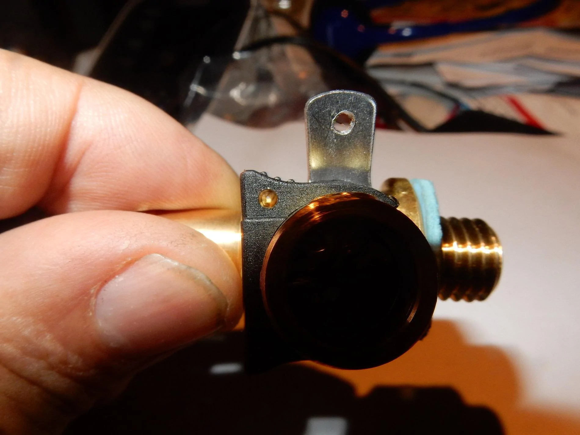

I used a 5/64 small drill bit to drill a hole in both the open/close ball valve handle and the plastic Fumoto valve lock. Using a stainless steel safety wire, I tied both the handle and plastic lock loosely together, so the "blue oval" people won't lose the plastic valve lock. (again) Also, you could used the hole in the F107 handle and the stainless safety wire as a stand alone ball valve safety lock.;)
That is a great idea, even if you do it yourself!
