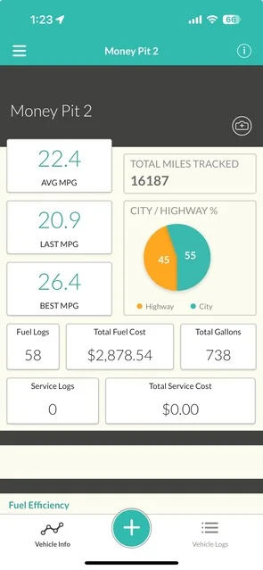

Both my 2019 & 2023 act exactly the same. The MTE light always comes on at 50 and the MTE readout is based off your last fill up. Now I've had mine read 438 and as low as 360 after filling up but again that's only based on your past driving. It will correct itself as you drive and that number will go up/down depending on if you're doing a lot of city driving or highway driving. I'm doing a lot more short trips (2-4 miles) and now that is cold out here and I'm letting mine warm up and idle more mine is reading around 370 MTE when filled up. Normally mine averages 408 MTE.
You can add the Fuelly app and that will help you see every fill up and the average.
https://www.fuelly.com/login

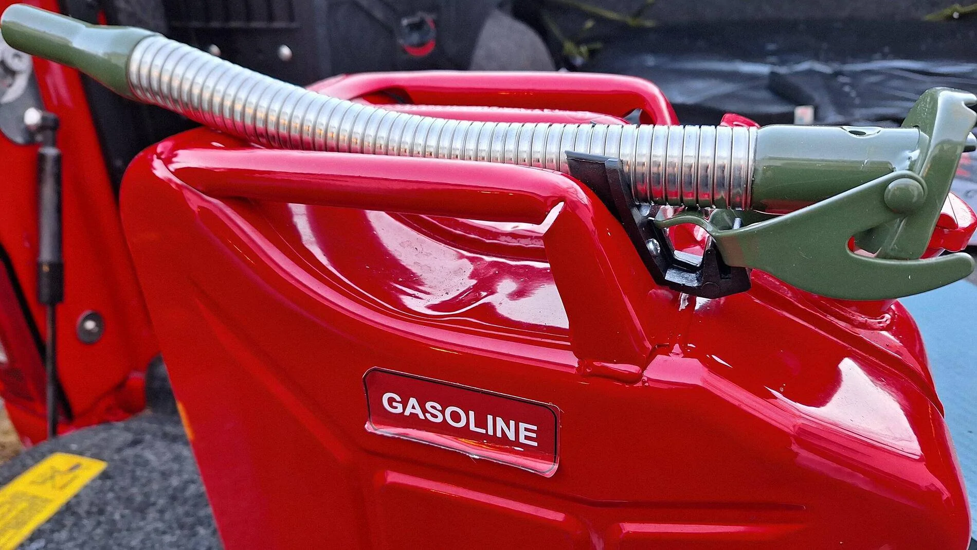

And I always carry a bit over 2 gallons of gas in a 10 liter Wavian can.
