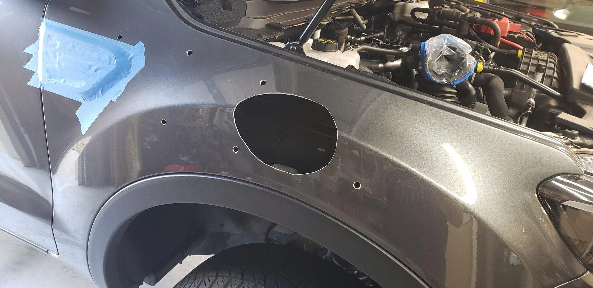

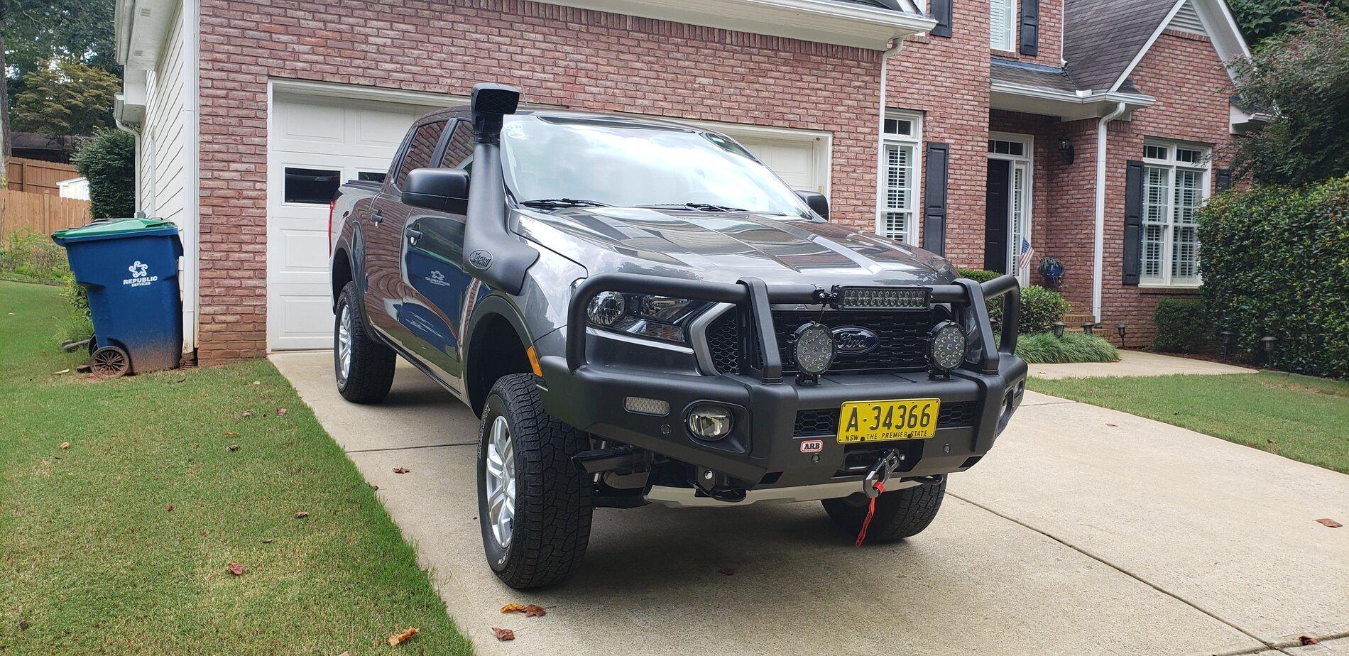

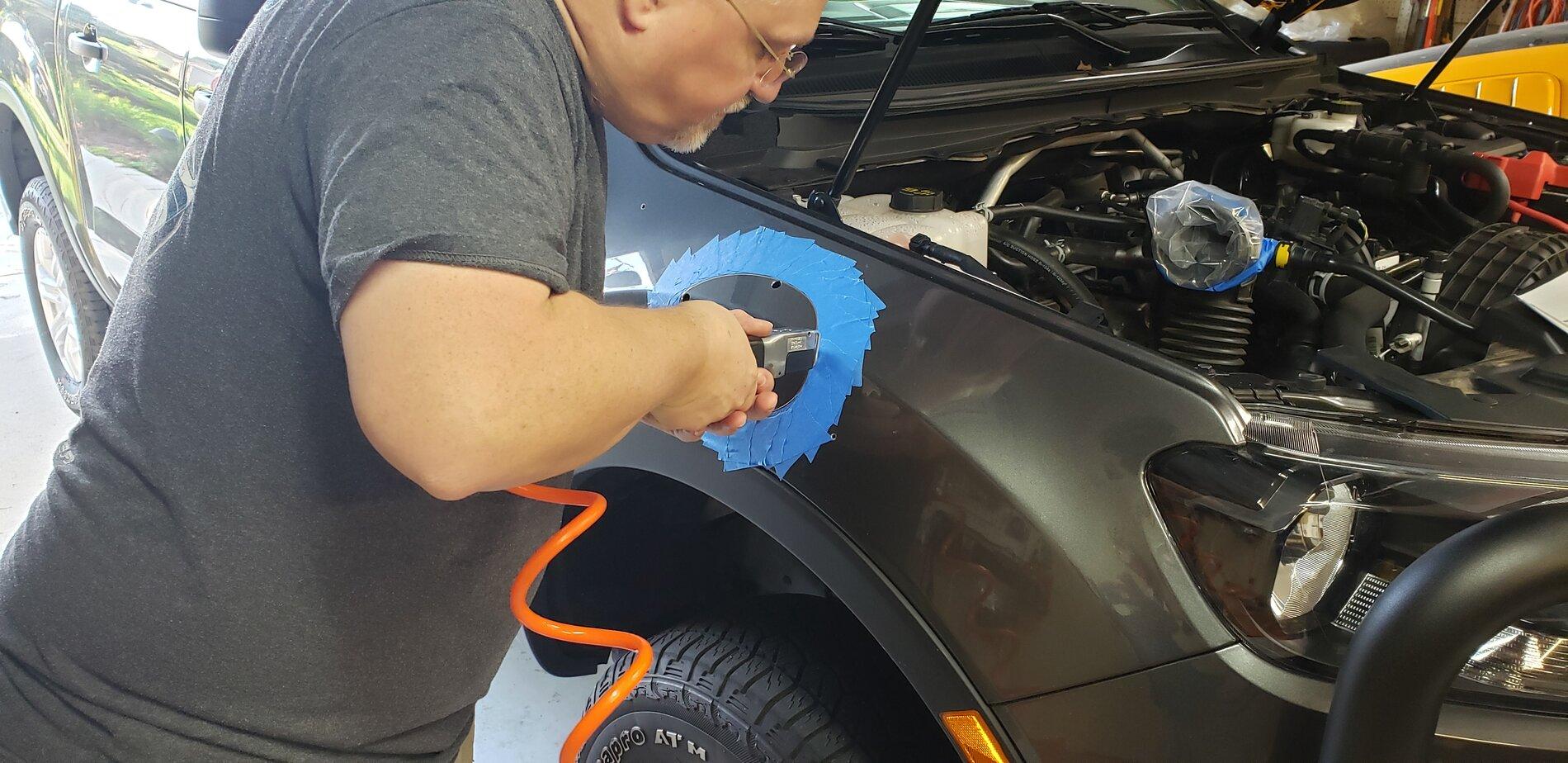

The front fenders are indeed aluminum. And cutting a huge hole in your nice aluminum Ranger fender kinda makes your anatomy shrink into your body. :D
