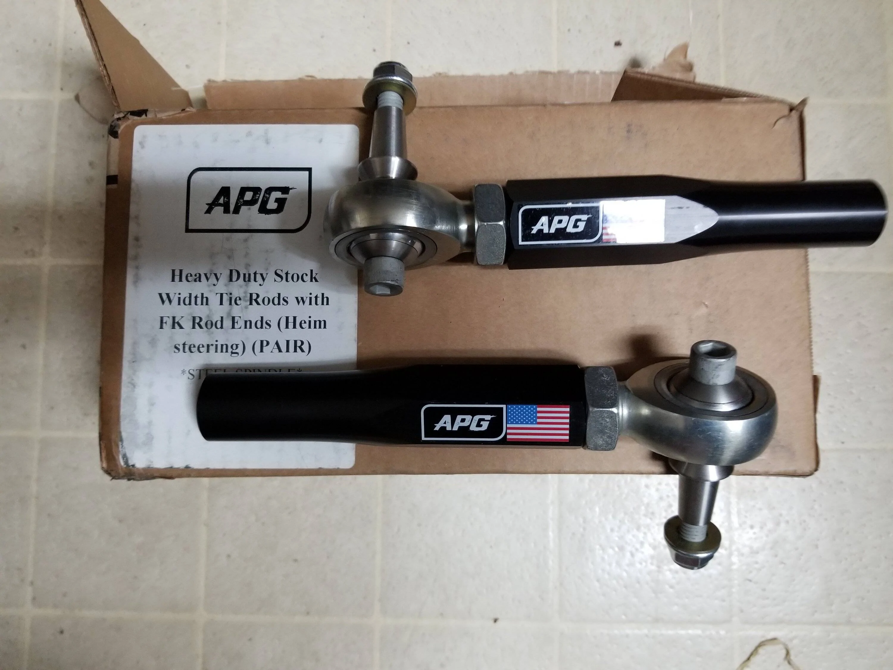

I am assuming you already have ICON 2.5 extended travel coilovers, and after market UCAs up front...
For that little bit of extra droop you can disconnect/ remove front sway bar, and add the APG billet tie rod ends . The Heim joint ends allow for more range of motion before binding.
About how much more with those tire rod ends?
