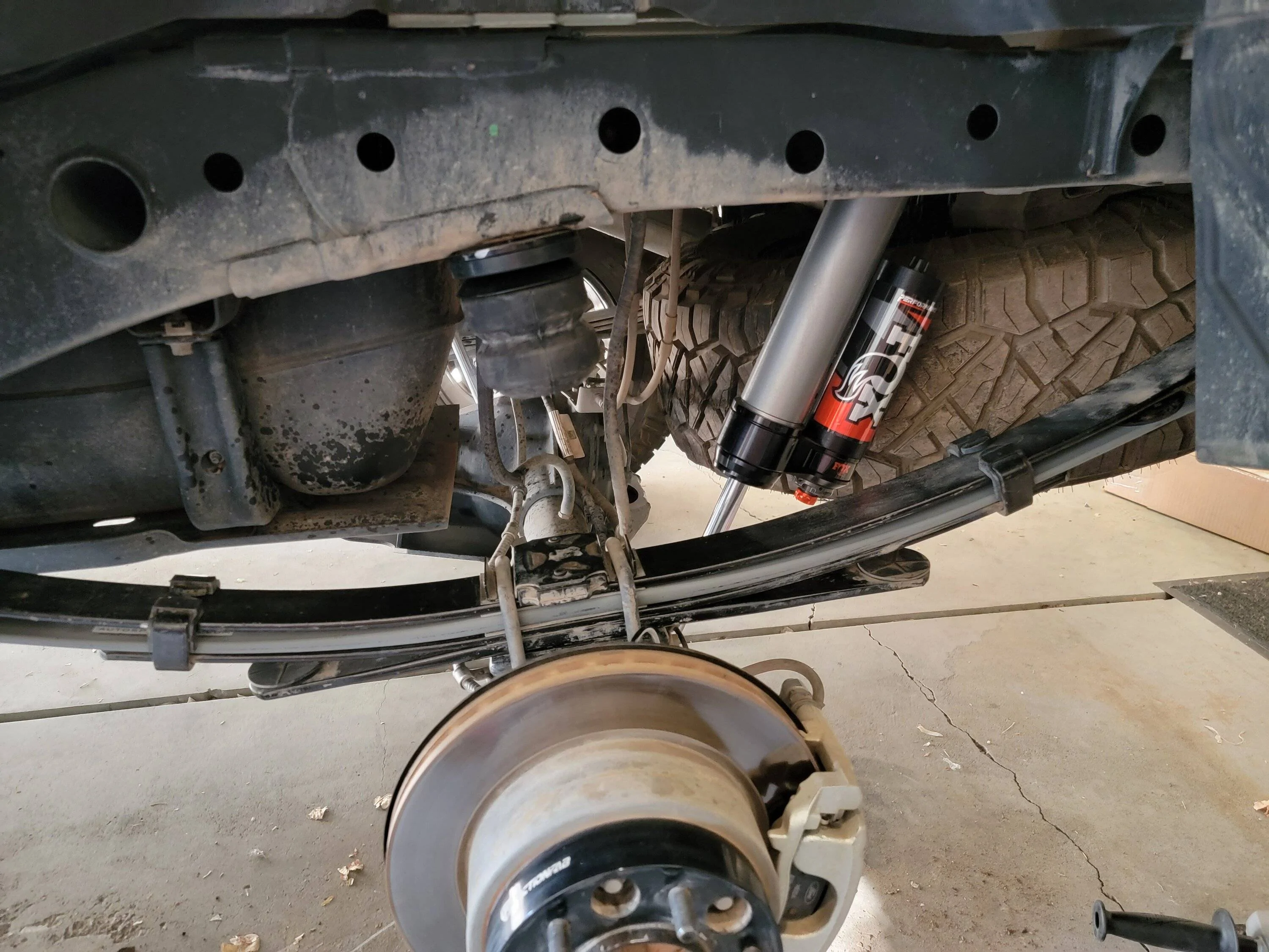

Have you fully flexed your truck out on them? How much do they compress? How long are they?
If you go down to post 6 you can see how much my bump stops compress
https://www.ranger5g.com/forum/threads/makers-build-thread.19743/
Yeah I have flexed it out quite a bit rolling around Moab. From the looks of your pic, those Icons are very squishy, something I worried about looking at them. The Timbrens are thicker/stronger and don't compress as much. I don't have any pics of it flexed out. The other differences I have from you is I'm running the fox 2.5s in the rear, and the Tremor leaf pack with the center left replaced with a high weight add a leaf from Auto Spring. But those still flex the same when loaded up for overlanding.
