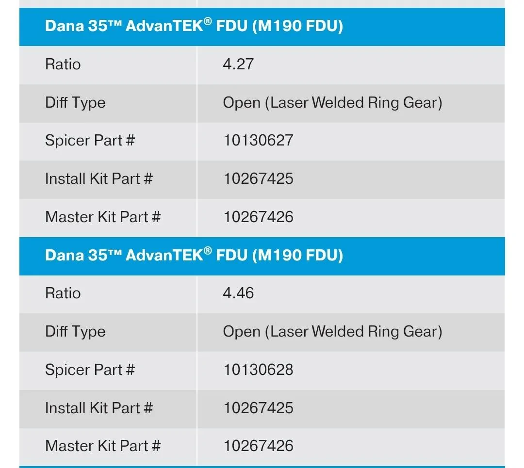

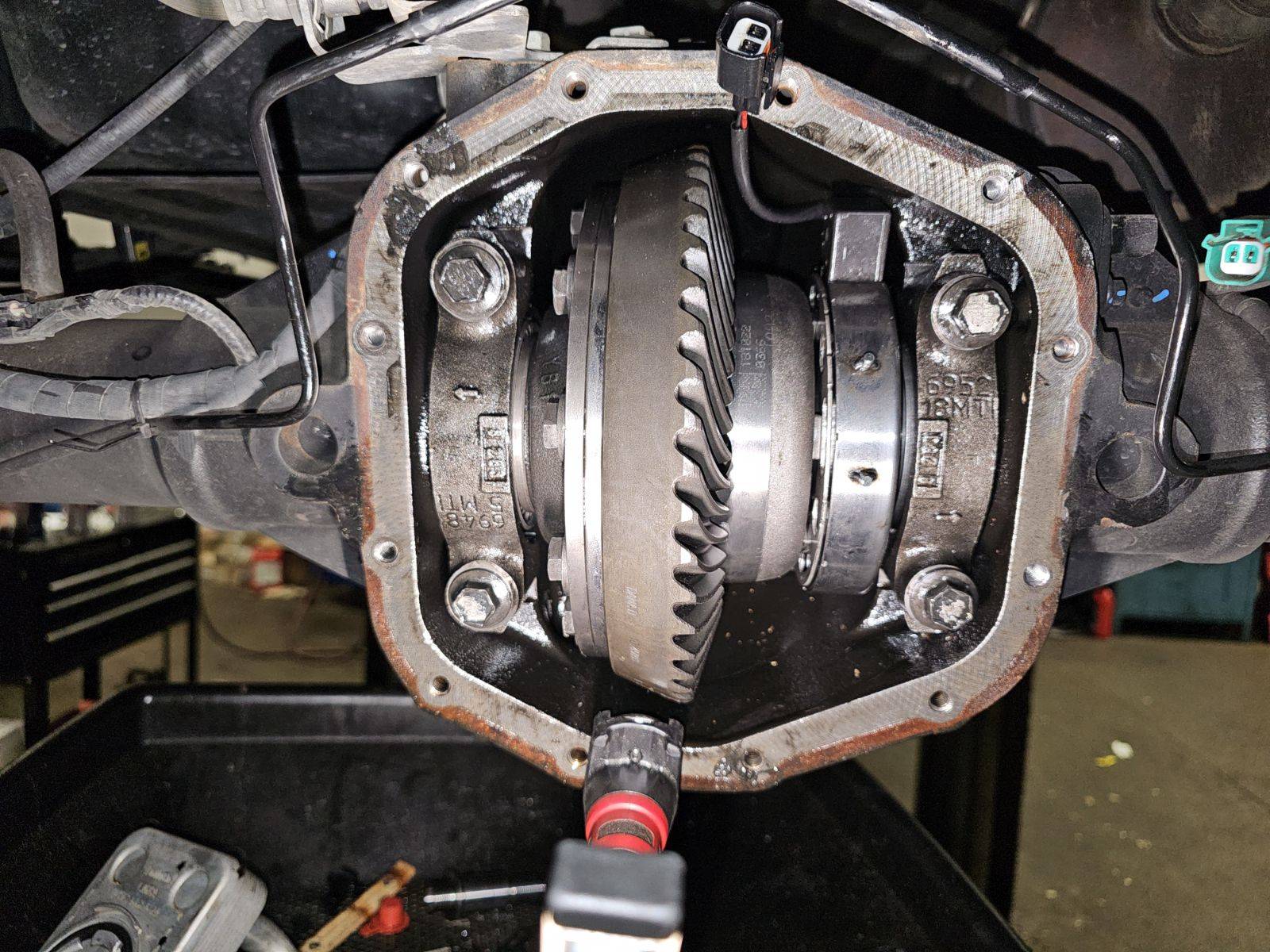

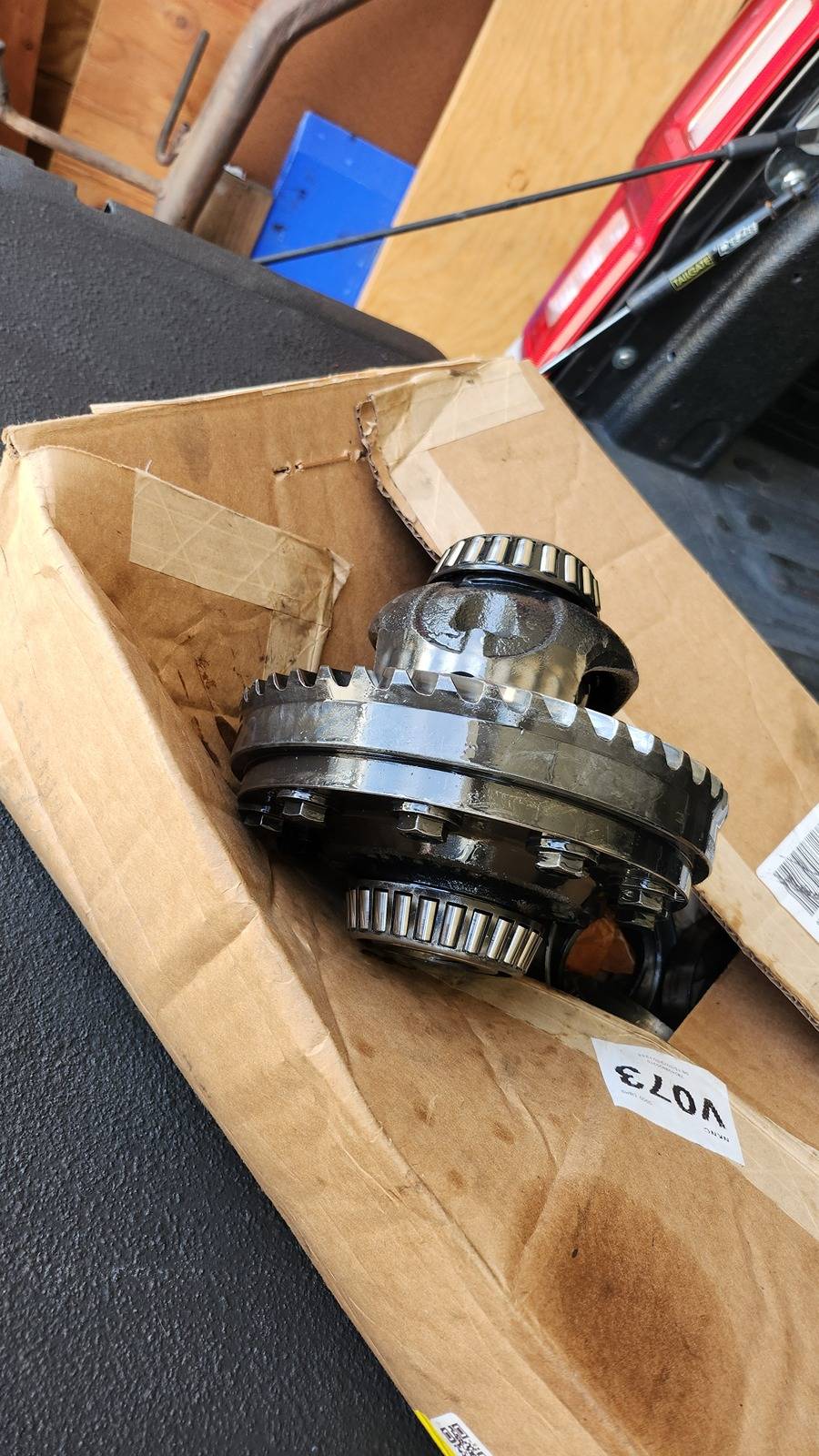

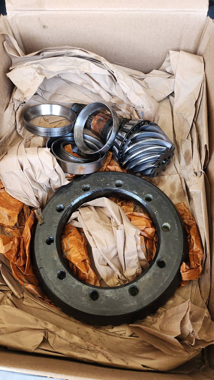

You heard it here first. It's done! He forgot to take pictures of the front while it was apart. Going from 3.73 to 4.46 gears made a huge difference. All the high gear lugging is gone. In fact the instant MPG's shows higher like I expected. Crises at 70 mph so much easier than it did at 55 mpg with the stock gears. I'll record it on the next full tank. Side note is said that all open diffs have welded ring gears. As shown in the pictures it turns out the front on mine were bolt on after all. Could have saved a good chunk of money had I known that. I can only say that's what mine came with. Your mileage may vary. Since this is now confirmed that you can swap the gears listed for the Bronco M190, a dana engineer told me you can run any of the stock bronco gears, you should be able to run up to 4.46's in the M190 before you need a different differential case like the M210.

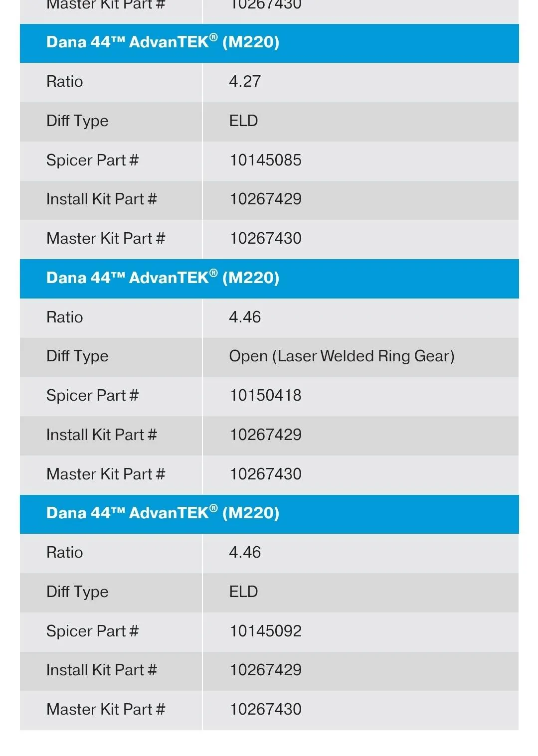

These are from Dana's site. It seems they may have removed some listing since I last looked? But I don't see the listing for the ELD front anymore on some ratios. You can still use the open welded version as I did. And choose your rear based on whether you have ELD or open. Availability of the gears themselves are kind of scarce since not many people and no ranger owners know these will work. You'll have to do a bit of searching. These are the cheapest installation kits a could find by a large margin.
This is the front installation kit: https://www.drivetrainspecialists.c...bronco-dana-m190-fdu-bearing-install-kit.html
Rear installation kit: https://www.drivetrainspecialists.com/dana/dana-m220/sp-10267430.html

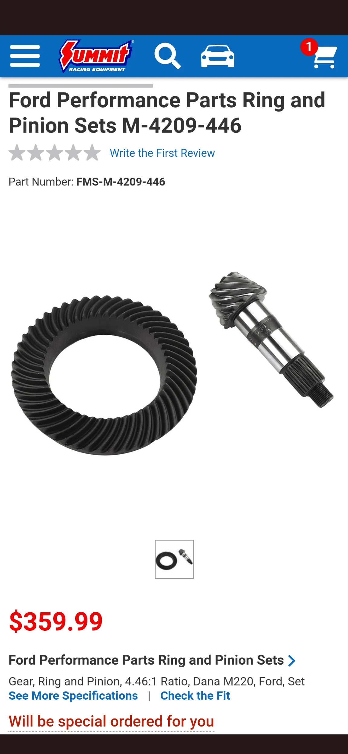

I found the ford racing gears listed for the ELD bronco for the rear and ordered the front open diff part from the dana site through jegs. Installation kits listed above.
