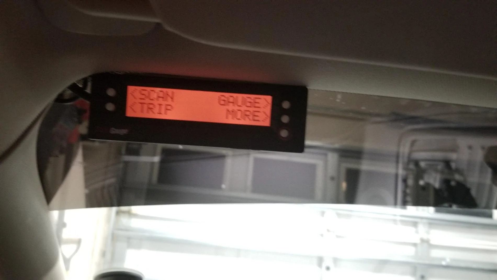

How did you mount it on the headliner. Looks like a good area to put it. Mine is just sitting in the garage. Might as well use it.
I used a double-sided tape and attached to the windshield as high and left I could go. Ran the wire under the headliner and under the A-pillar, across the sill and to the rear 12V receptacle.
I am currently Looking to tap 12 V off the Ceiling console. May get that done professionally

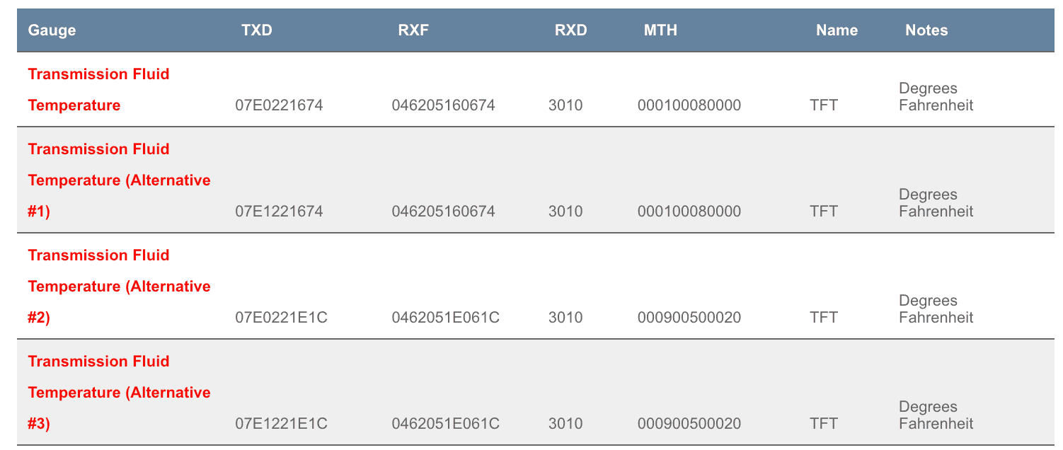

I didn't see transmission temp, can you tell me which setting that is?
Can it be configured to monitor engine oil and transmission fluid temps?
I don't remember anymore which one it was so long ago haha, but it's one of these 4 codes, you just have to test them and when it shows a temp you got it. And then post here which one it was for everyone else since I forgot to do that when I did it.

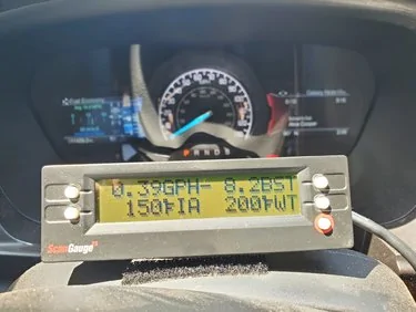

i installed mine on top of the steering wheel area right behind the wheel using velcro. it's easy to see and it doesn't block the transmission gear selection in the dash. I also have transmission temps shown. i have used these on all my cars since 2009 or so. Never had a drain issue. And my ranger hasn't had a drain issue and it's been on about 2 months now.

Mine is in the same area exactly.
