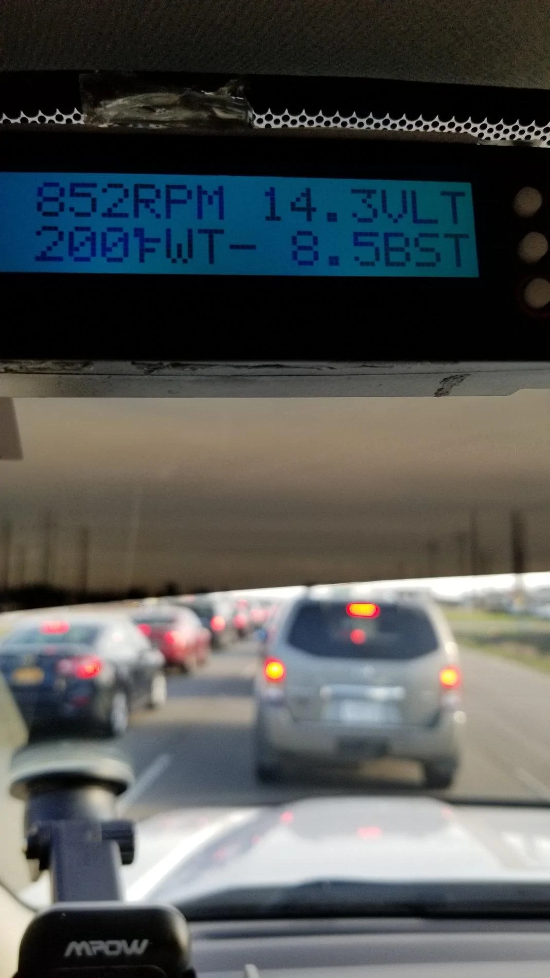

So I was digging around in my Tacoma parts to get rid of them and I found my ScanGauge 2. I installed it on the upper LEFT headliner area and Installed the OBD cable behind the a-pillar and down under the steering situation. I just installed it. My question is has anybody installed ScanGauge II on their trucks yet? If so what are you monitoring?
So far I monitor engine temps and Voltage, as well as Boost and RPM. We Lariat owners don't have the analog guages

And it looks good there, up and out of the way!

Mine shows boost. Negative boost at first until I apply the gas..then boost goes up.I have an older ScanGuage 2. I set mine up to read Temps, Boost, RPM , Voltage,
Regarding negative Boost... When you're sitting idle - you are not creating any boost - so your engine is sucking the air through the intake system...thus creating negative pressure. When you accelerate and there is load on the engine, your turbo spools up and crams more air into the intake than what the engine is sucking - this is boost.

Certainly won't have to monitor MPH in that traffic.

LOL Thats a 10-minute 2-mile jam caused by a busy intersection traffic light,at 5 PM, not a freeway. There are rarely any major traffic issues here. especially when compared to my previous homes in Las Vegas and San Diego. .Miles and miles of traffic on freeways

Come to Hawaii ;Oahu, you’ll see what traffic looks like lol

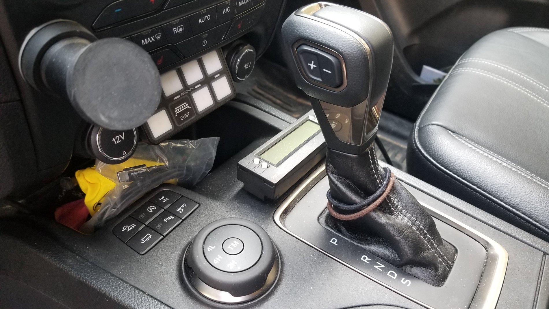

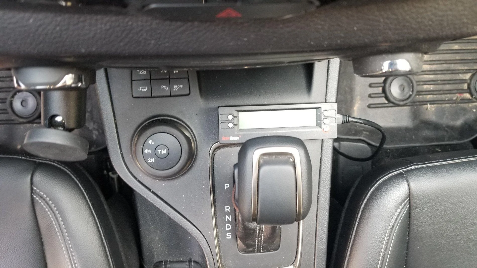

Installed just by velcro right in front of the gear shift facing up. Monitoring mainly trans temp, but also sometimes mph (since my setup has the speedo off by 7% or so), sometimes mpg/gph, sometimes a few other things. Love having it there and it's helping a lot.

Can you post a photo of where you have it? It sounds like a good idea.

Here you go. Out of the way, easily visible when in drive. Cable runs across under the dash to the OBD port driver side. I'm going to design a bracket or something to hold it in place even better eventually but other things are getting done first.
