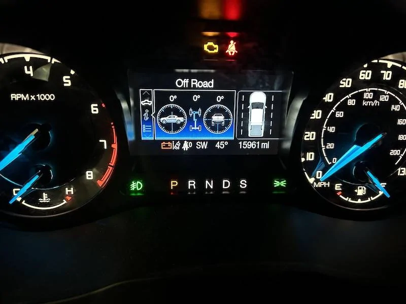

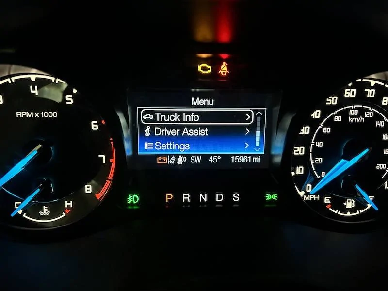

Did you scroll through the dash screens to get to Truck INFO? Because if you have a factory FX4 then you should have this menu option.
Right. I don't have that in my FX4.
t4thfavor
Chance
Feb 5, 2019
2,607
2,358

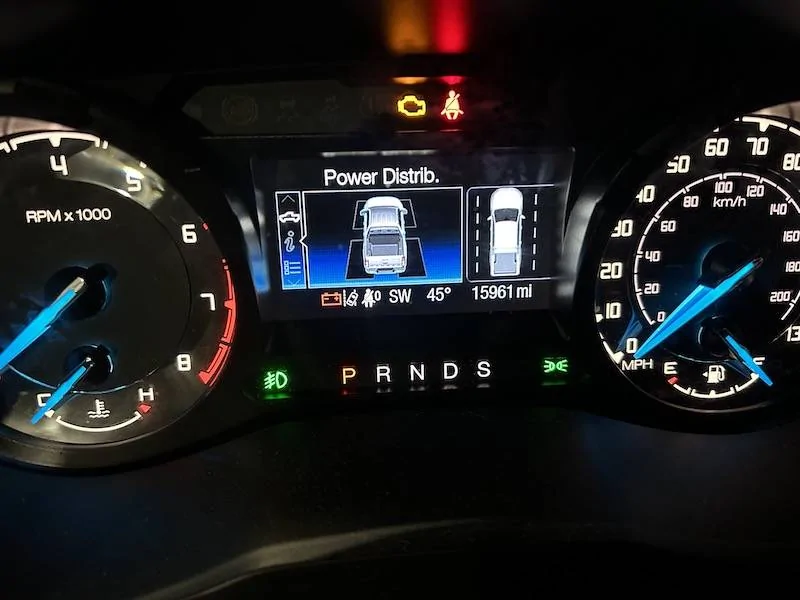

OG here, you should absolutely have the truck info screen, the individual wheel output screen has never worked for me, or anyone else I’ve seen it add, it’s more for the on-demand systems in something like an edge or escape where you don’t have direct control over the 4wd and the vehicle is primarily front wheel biased.
Wait - I shouldn't have it unless I turn it on, or I should already have it?

My truck, which is not an FX4, had the power distribution screen when it was new, and it does work, but it’s always going to be a 50/50 split in a part-time 4WD vehicle. I’m not sure if it shows left/right distribution or not if a wheel is slipping.
You should absolutely already have it, having the FX4 package. Unless it's not actually an FX4.
The truck info/off road screens are part of the FX4 package and you should definitely have them if you have the FX4 package. If you have the factory FX4 package and do not have those screens then I would be complaining to Ford about it.
t4thfavor
Chance
Feb 5, 2019
2,607
2,358
You should already have the main screen with angles on an fx4 from the factory.

Do you have the “Power Distribution “ screen? I have an FX4 and I do have only the “Off Road” screen with the inclinometer, but I do not have the “Power Distribution “ screen. Is that something that is activated in FORSCAN?
Power distribution is enabled in forscan, but I’ve never seen it work.
